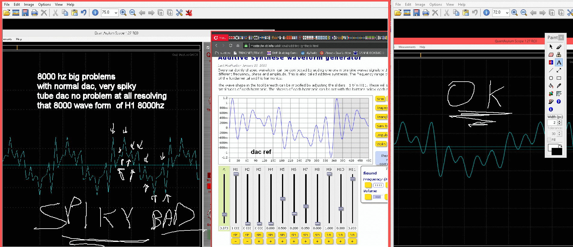

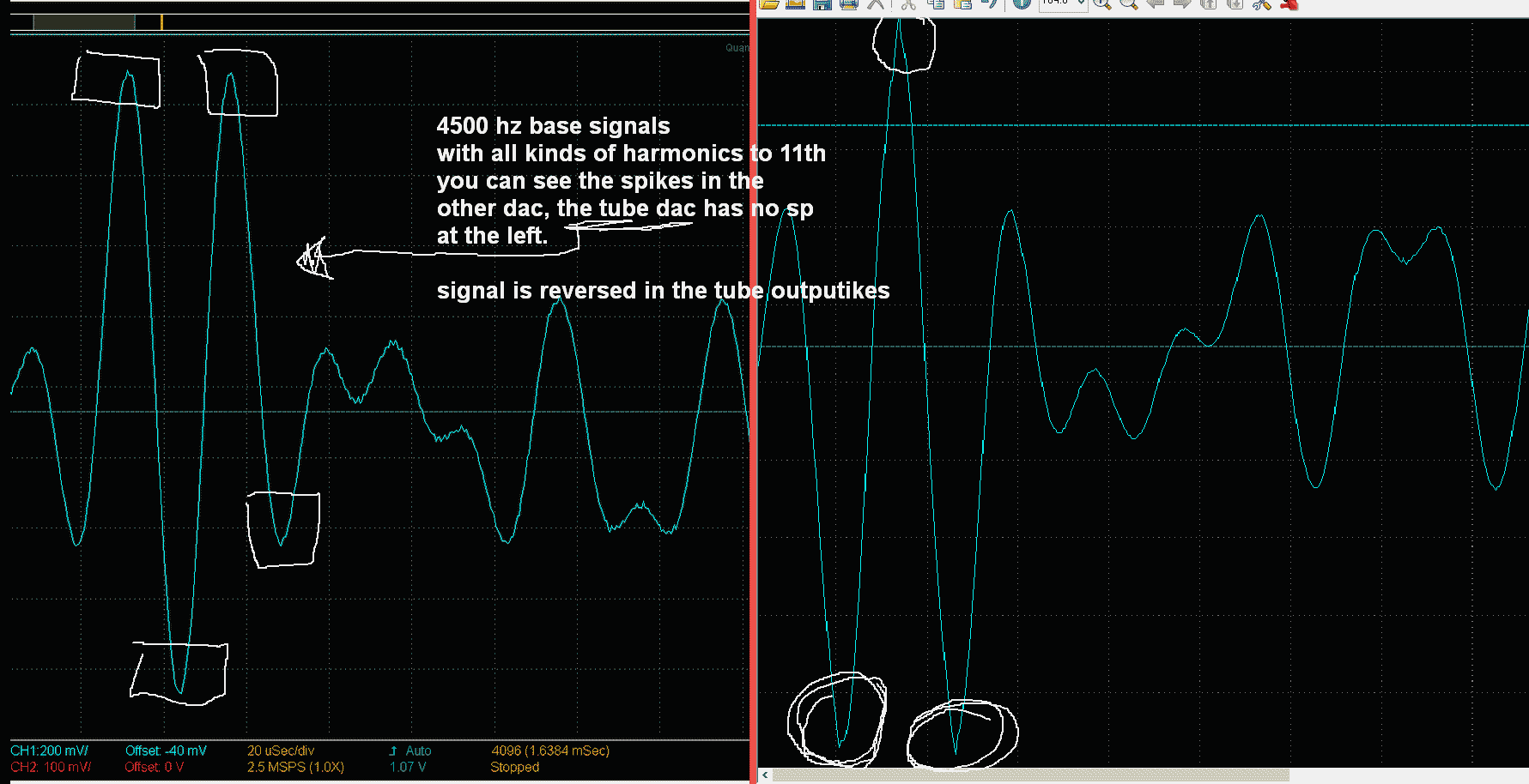

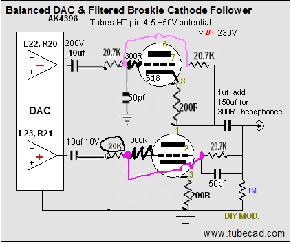

AK4396 DAC is what i use, I took the output directly of the emu0404, disconnected all opamps and outputs,
This goes through a pre-filter and 10uf caps to unbalancer from broskie, which has another filter, then the outputs are sent to 350uf film caps for my headphones which are Grados top of line and seneiser hd600, then another 1uf caps are going to the modified aikido dac, then to the super duper regulated mono blocks of greatness to harbeths. this is my serious system.
It is a very casual system but the amplifiers are everything, it is a fun !!! to listen to. The lampucera is a bit more serious sounding... the Ak is like in the middle, I only had a wolfson dac before for radio station diffusion, the sound was greatness, very reserved but idk, I used a single tube buffer, I sold it.

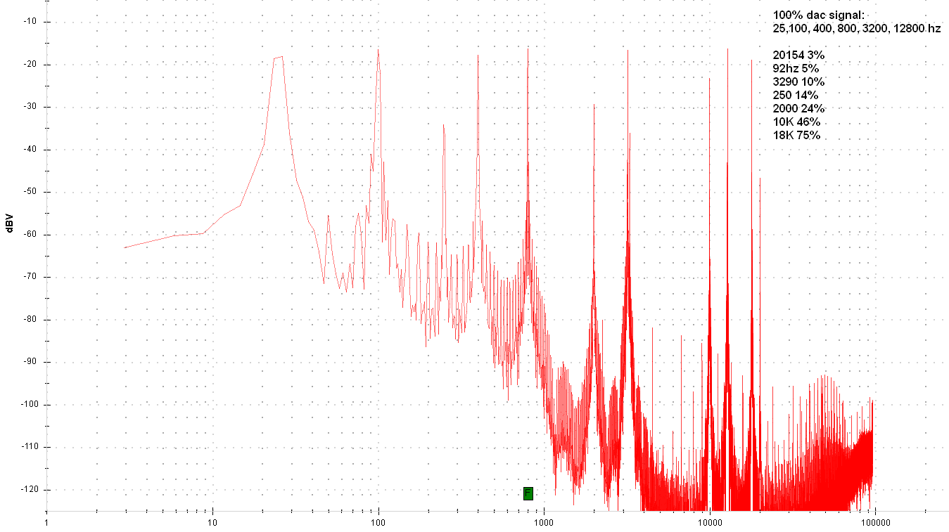

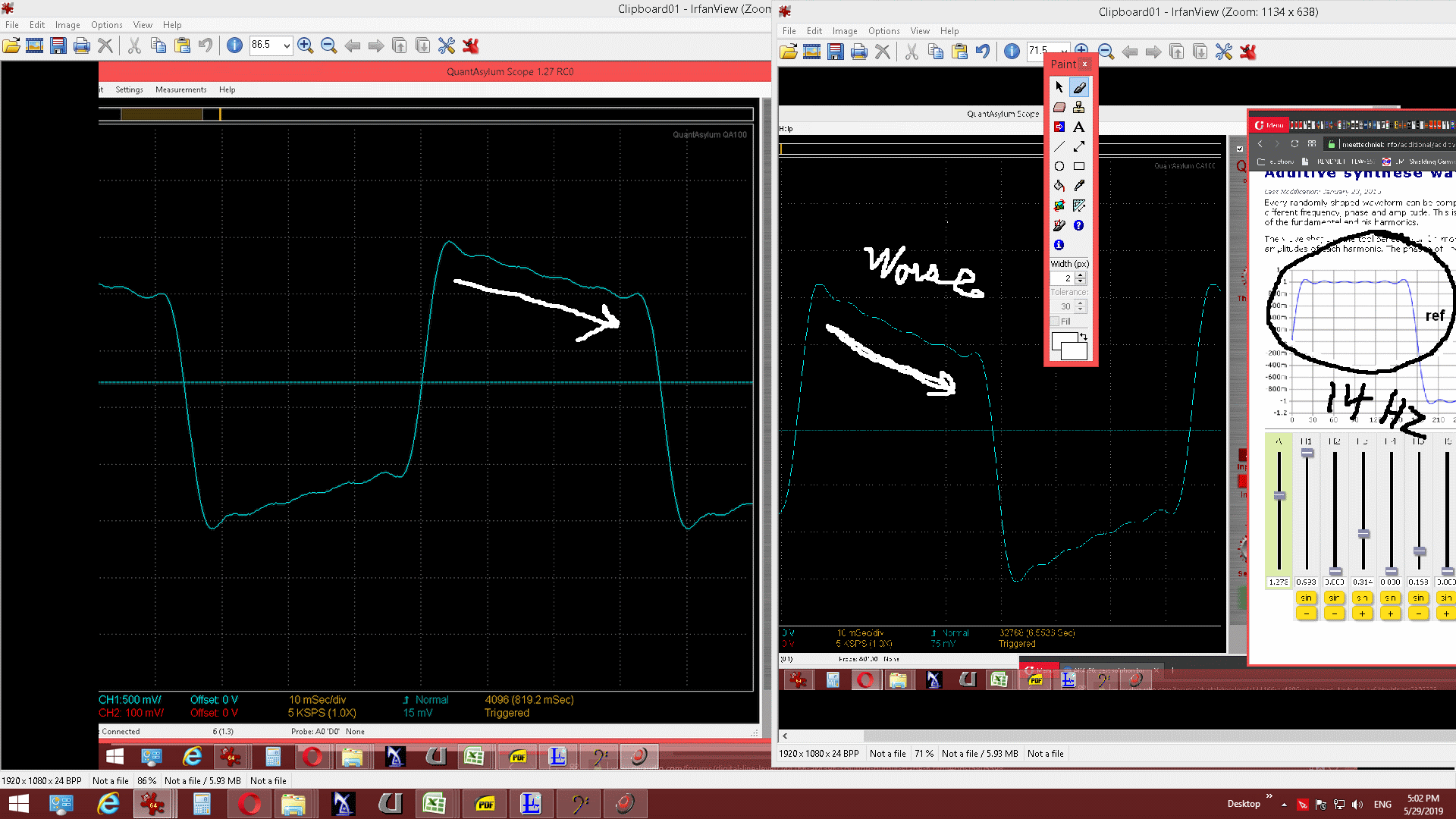

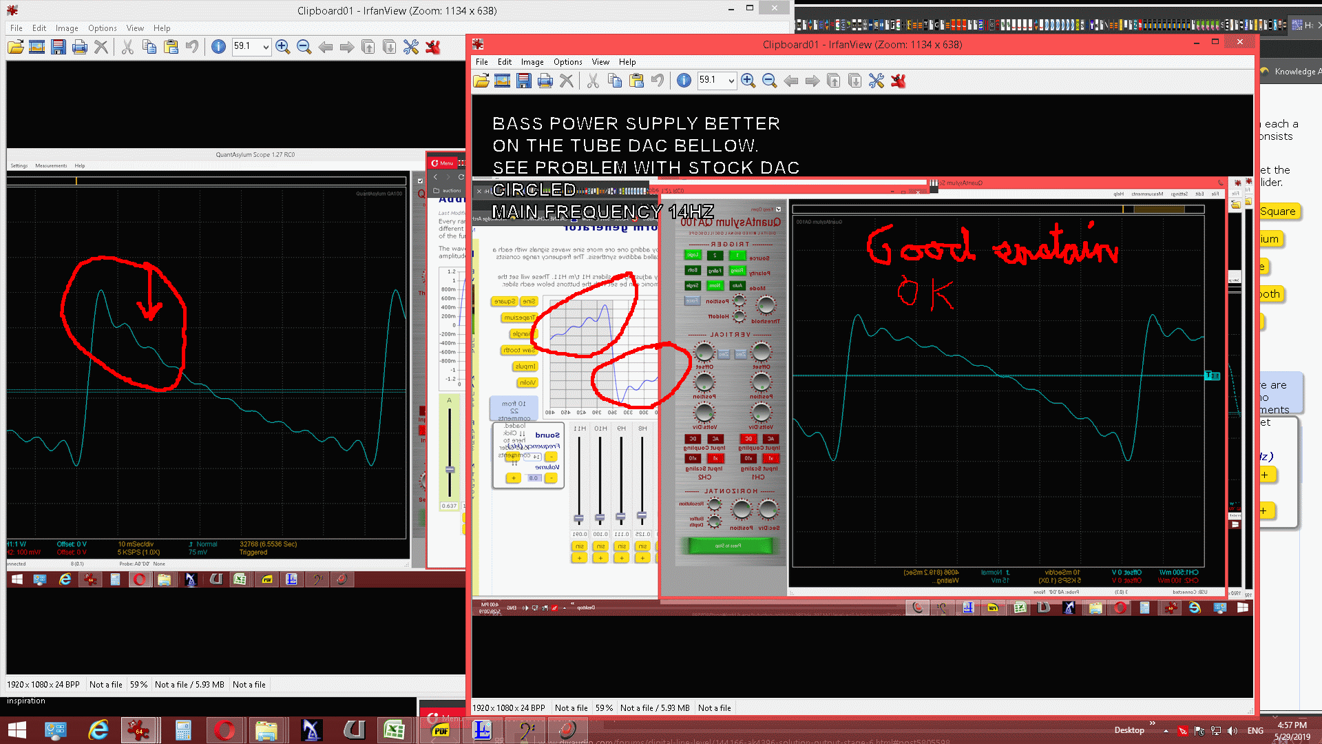

The last picture is THD feeding the dac with 13 different signals, you cannot see much harmonics, all the spikes over 2khz is just usb noise, it is not the dac, obviously the noise floor raise to -35db of background noise in the bass, this could be improved a lot, I have no clue how and if it is the Broskie, the filters, the power supply or the dac itself causing that.
Reactions: Matthew Halliday
Ah, I give you an example of THD you get from such dac AKM, the cirrus logic (lampucera) is smoother and natural, lean, and very airy , it doesn't resolve like the AKM dac does,
You could build the tube output and see if you like the sound.

And it could be worth to bypass the opamp and build the tube circuit which I showed. Unless someone has a better idea.
