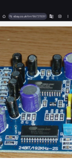

I will be buying a Lampucera in about a week to 10 days and then listening to it and then buy a some op amps I won't be in a big rush because it will sound better than my SMSL Sanskrit 10th mk3 🙂. Which means I have time to look at People's opinions. Does the Lampucera come with one op amp chip or two. I have seen this one.

Those 2 large chips are surface mount (SOIC) - not in a socket. You should learn the difference. Surface mount chips have smaller legs going out sideways, not longer and straight down legs like socketed chips (DIP). They are soldered directly to the board.
Those are the Cirrus Logic DAC chips.

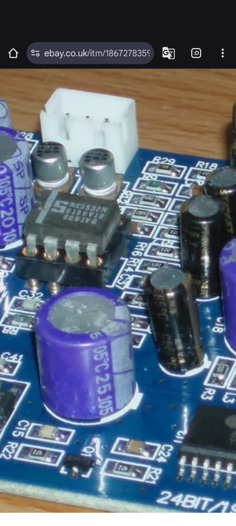

When I replaced the NE5532 in a V-DAC I used LT1364 or LT1361. They can fit directly in the same socket.
Reactions: Matthew Halliday
The NE5532 in the picture is an old Signetics NE5532, and they have been out of production for a long time. Either the old one was used, unsoldered from some device, or it is a fake (or sanded and re-marked). Those old ones sound better than the old TI NE5532 but also modern productions. I have a few pieces, used who knows where and who knows how much. There are a number of opamps that can come into play here, but there is always the possibility of oscillation occurring when switching opamps. If there is no experience, ang some measuring equipment, it's better not to touch them.

Here you have double sided PCB and metallized holes. It is difficult to desolder without a vacuum pump gun. There is a high probability of damaging the PCB. Everything seems good to me on that PCB, I think you should limit yourself to only replacing the opamp.
I know someone who worked in recording studios soldering equipment he is really good 🙂. I would buy a desoldering gun. I am not in a rush because I want to appreciate the improvement of firstly the Lampucera being better than what I have and then replacing the op amp and appreciate that sound quality 🙂.

FIrst the traces are poor on this PCB, don't modify it , you might want to replace the OPAMP socked with a prong one.
Then, the opamp is a buffer with no gain, no need to change the opamp, the stock opamp is fine.
