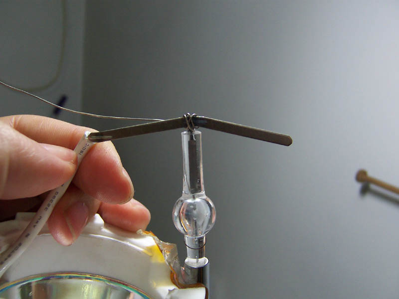

Hi! I'm new at this stuff....at work we had a Kodak DP1100 DLP projector. The lamp blew up, literatly. We decided to just buy another projector for $500 since the lamps were like $400. Now I just found out I might be able to do something about it....
This projector uses 250/270w MH lamps....
a) is there a place were i can get the actual lamp so that I
can take off the cement and replace the lamp instead of
the whole casing/mount?
b) can I modify it to use a cheaper lamp (250w halogen?).
c) do I need to replace the ballast too?
Thank you very much
Well, I was able to modify the temp halogen light and I can see the squared screen on the wall, seems to be bright anough. Used a 250w halogen bulb from home depot and modified the original light housing with direct power cable not thru the ballast (I didn't want to but i broke the ceramic housing so i had to make some mods). Now I just need to find out how to turn it ON. Same problem as everybody else. Can't find the lamp, so it doesn't power up. I took it apart last night but it was too late to work on it. If anyone has a better idea on how to mod this projector to power up, please let me know b4 I break it completly. I don't have any electronics/technitian tools, so I need to know what Im going to need to do this. I'm used to working with PC's, so Im a little familiar with some of this cards but not with the terms...lol.....PLEASE ADVICE....thank you very much.

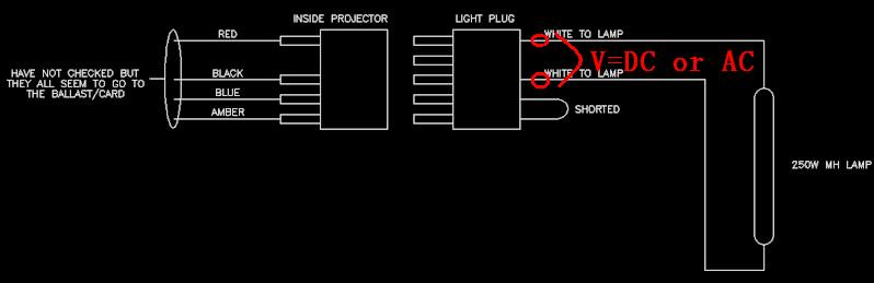

you can not modify it to use a cheaper lamp (250w halogen). you need a point-light
you dont need to replace the ballast .
your lamp is 270-watt metal halide, test the ballast out put at once when you turn off the power, tell me the voltage is DC or AC?

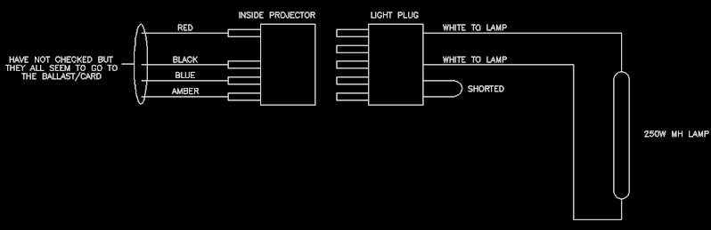

Ok...this is what the original lamp system is (see pic) i thought that the blue and amber wires were the one that would signal the lamp presense but it seems that the shorted function is already there and is not working. I pluged it into the wall jack and nothing happened, not even the buttons lit up. Could it be a power supply malfunction? Any help please...point me to the right direction please. Thank you...😀
well, it seems that my problem is bigger. I tested for power and not a single reading. Thank you ywh, I tried what u told me but no reading w/power on/off plugged unplugged, cable in/out reversed cables..😀....so I guess my problem could be the power supplied, switch, or anyother.:scratch:...I'm not going to waste my time right now...who knows in the future.....
the projector wont power on without the lamp plug attached because those 2 wires need to be shorted.
the DP1100 is nothing more than a rebrand of an infocus LP435Z. which is a 270Watt metal halide DC lamp operating around 75 volts or so.
Ok....the bulb blew up...boom (explosion)...no more bulb...I plugged the lamp plug in and measure the power where ywh told me to and I get nothing...no reading at all...I tried pressing the power button, the power switch, plugged to the wall jack, not plugged, power on/off just like on the image but nothing happens, NO READING....any ideas. thank you for the comments and help....😕 😕 😕
