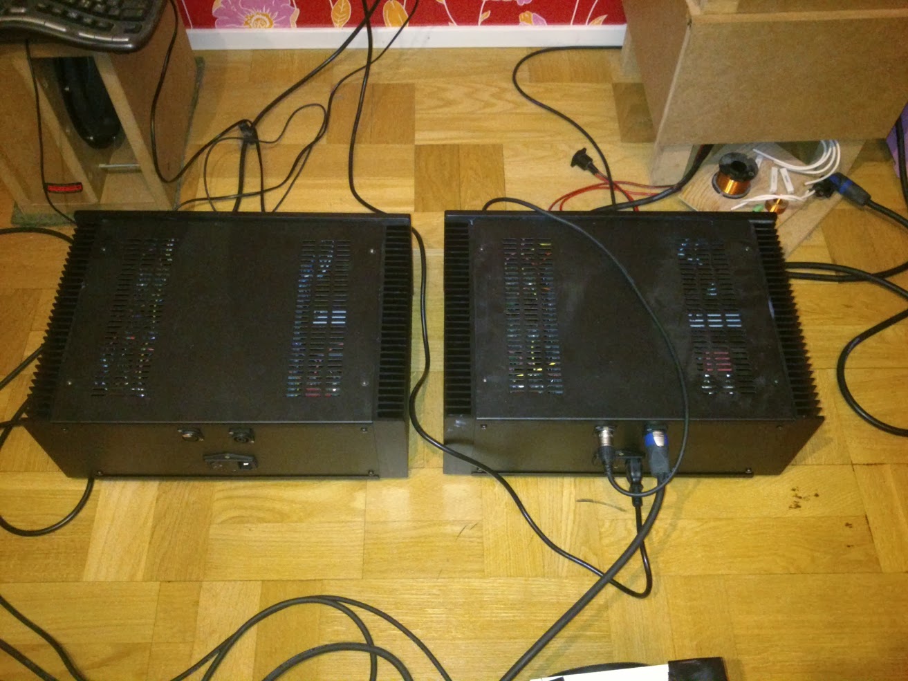

After much procrastination and building on other things I've finally assembled enough to test this little amp, and if it works assemble the last on the other channel too.
My questions are the following: What should be done first is to verify that the bias is ~ -12V to ensure that the SIT doesn't break?
And another question about 2sk82 grades: The KD-33 grades work in the positive biased version but do they also work in the no degeneration bias supply version? I currently have KD-33 grades but if I like this amp I'll probably buy another set of 2sk82s in case I do something dumb and break one. The only grades left on circuitdiy is KF-33 and KD-33.
If the KD-33 works in the bias supply version in addition to the single supply version then I know which grade to stockpile =)
It's alive... it's alive! muhahahahaha!
I guess it worked after all =) I'll have to assemble the last on the other channel too since I'm waiting for the crossover parts to the speaker anyway.
Currently it's 2A @ 20V, I have yet to hook up the scope and fine tune the distortion profile.

I've trimmed the pot some each way to dial in distortion but I don't get any significant change by small trimming. I think I'll just keep it at 2A @ 22V, stop worrying and just enjoy the sound =)
And maximum power is ~ 9V RMS into 9.4 ohm so sounds about comparable with 10W into 8 ohm. And the 193V does ring... when you apply large sinewaves at several watts but it's quiet at 1W even with a pure 1khz sine wave so I'm not worried about that anymore ;)
It doesn't have a lot of gain, about 6 dB since I use a Jensen JT-11P-1 to convert from balanced to single ended but with my 5V RMS capable source it seems to be enough.

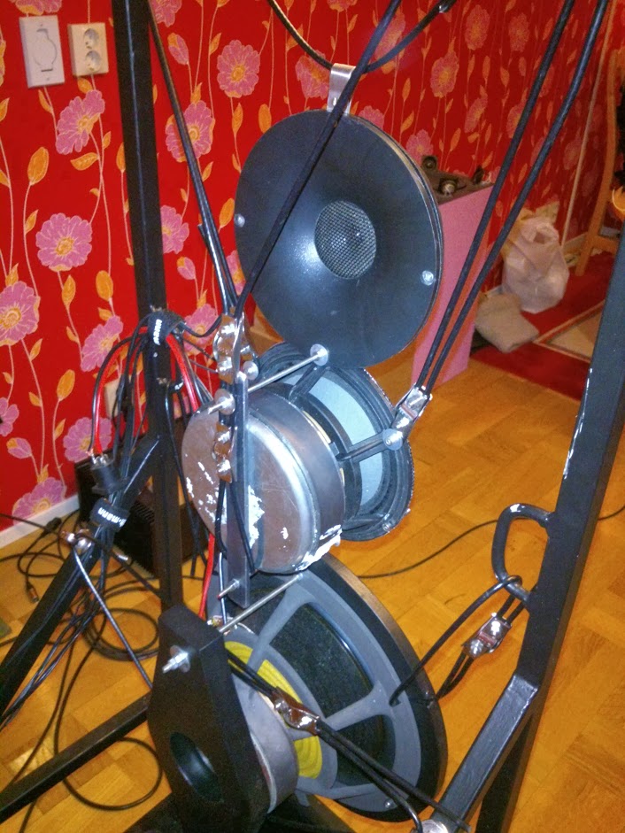

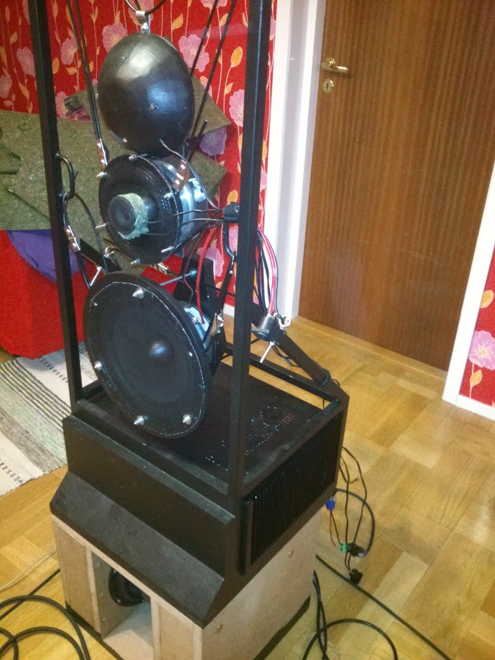

Wiiiie, the next amp is now also done and both work =)
The amp has even moved into the speaker... now I just need to wait for the shipping of the crossover parts. The L'amp is to drive the 6.5" midrange and the tweeters, the woofer and subs are driven by a hypex plate amp.
The speaker is lacking the magic efficiency booster though ( a wool baffle ), but it'll be there in the not too far future =)

Loooks very promising...I like that gong like tweeter...
It's just the rounded backside of a waveguided tweeter ;)
The rear dispersion of the midrange falls off much earlier than the front one so I've helped somewhat with waveguide loading. The crossover is assymetric also with lower crossing on the rear.
