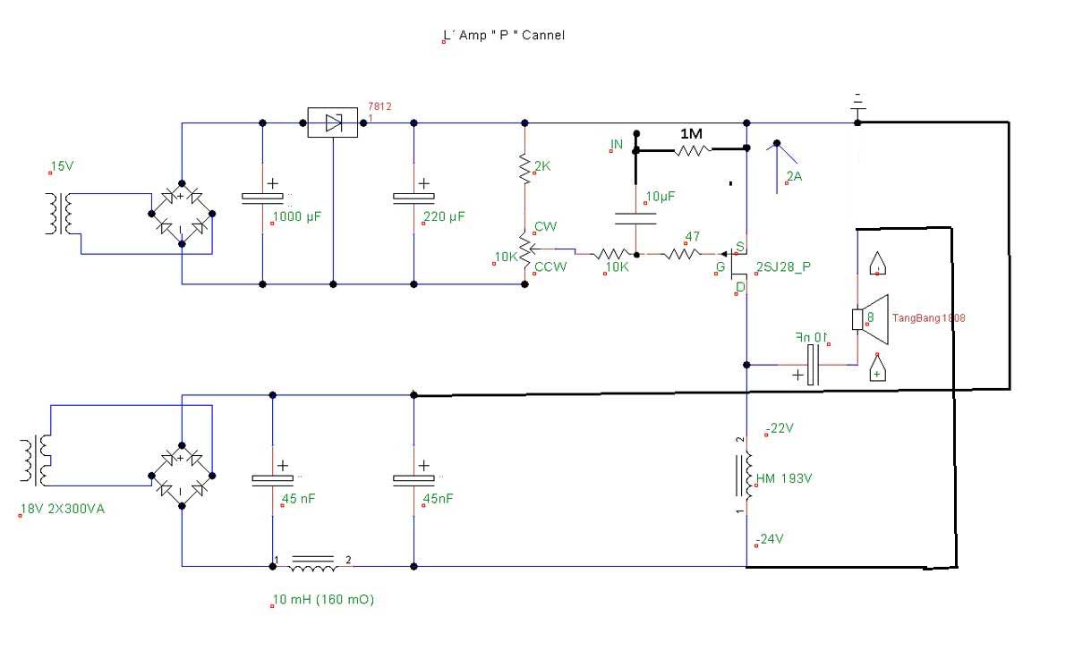

On ebay and circuitdiy no 2SK82 are to get N, I'm still waiting for 2-3 weeks then I'll buy two pairs of P + N channel and try the p-channel re-sell.
Oops, I see the KD-33's are unavailable or out of stock.
There are plenty of interesting uses for the P's, and you could certainly build a P-channel version of L'Amp. Or, send them to me 🙂.

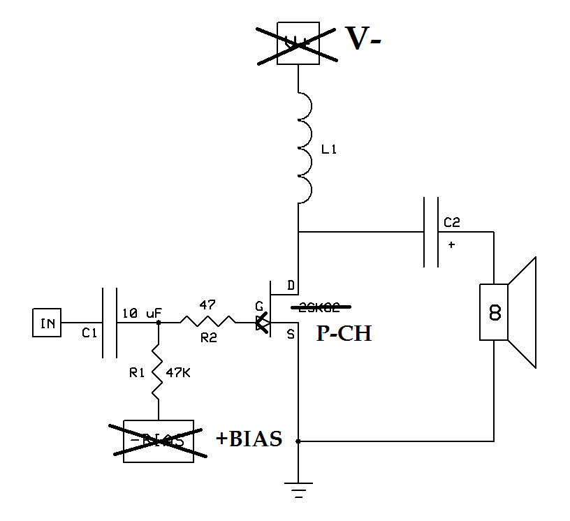

Thank you mr. Rothacher is unfortunately the KE-33, because I would have bought almost the wrong. Can I still take another sit as an alternative. Do you have to change at a P-channel L 'amp much?
Any of them can be made to work. It is a question of where the bias voltage will need to be to achieve the proper idle current. With an adequate adjustable voltage source for bias, this shouldn't be a problem.
If you build a version with P-channels, all the polarities get flipped.

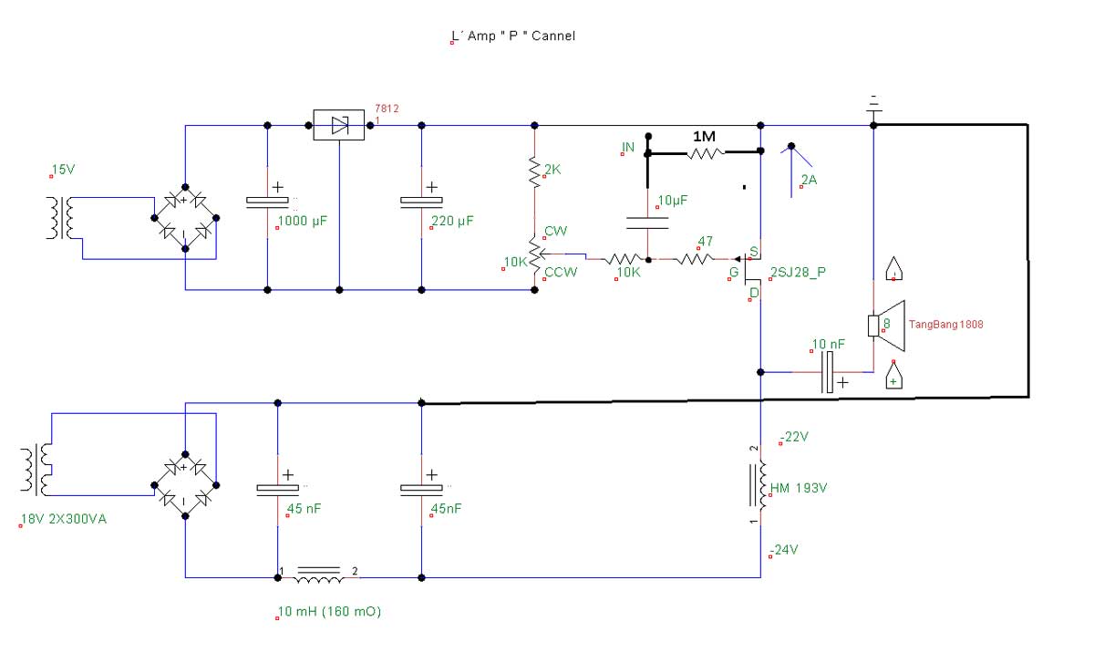

above my L - My Photo Gallery click, then I can at any rate see the wiring diagram. My first attempt to put images purely went wrong.
Dirk 😱
Dirk 😱
For P-Channel, the Drain would be connected to the negative terminal of the supply (through the load). The source would be grounded as would the positive terminal of the supply. The bias will need to be positive with respect to the source, so you may wish to use a positive regulator IC there. Note the polarity of the output cap as well.
something like this
edit - one of these
btw. nF sized caps , as PSU reservoir ones and output , are somewhat smallish
edit - one of these
