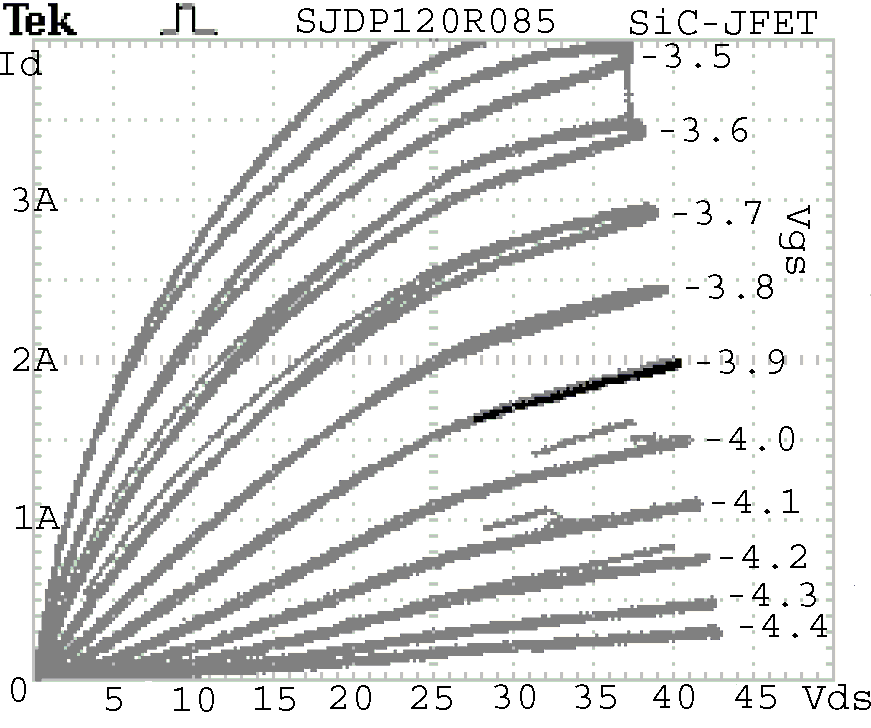

The R085 is more pentodey than a 2SK82 so there's less opportunity for working the loadline in OTL territory. Interestingly, the R085 (I posted some curves somewhere recently) is probably more well suited to an SET coupled design as it's more triodey at low-current high voltage. You probably couldn't go real high on the primary impedance, but a 64-150 Ohm transformer is probably workable, e.g. NP's Arch Nemesis.
Here your traces again, annotated.
