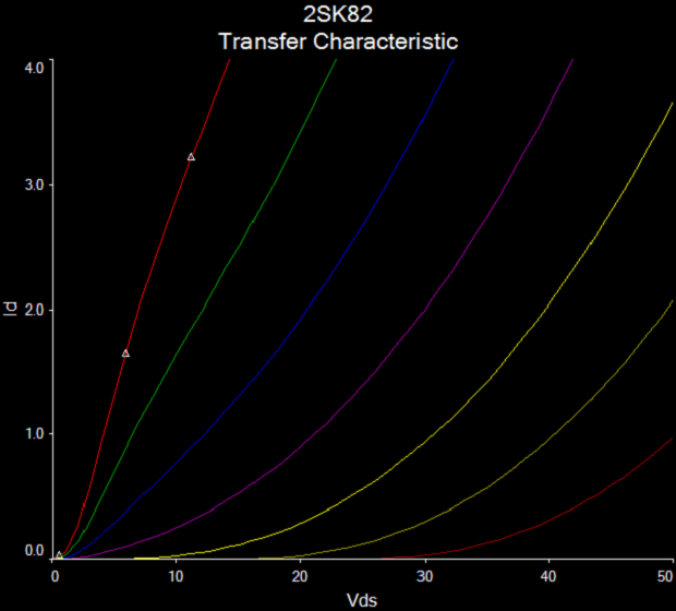

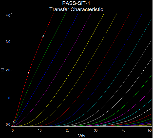

MR , do you have (by any chance ) LTSpice model for 2SK82 ?
where you been lately , cookin' something ?
Hi, ZM. If ballpark is okay, I have approximated SITs with Koren Triodes.
Attention all eggheads: I wouldn't land a probe on Mars with these or get too excited about distortion figures and such. Stay mellow and have fun.
much obliged Mr. MR ;)
I'm primary interested in that because I want to alter some values in one sch, for Generg's 2SK iteration
:cheers:
