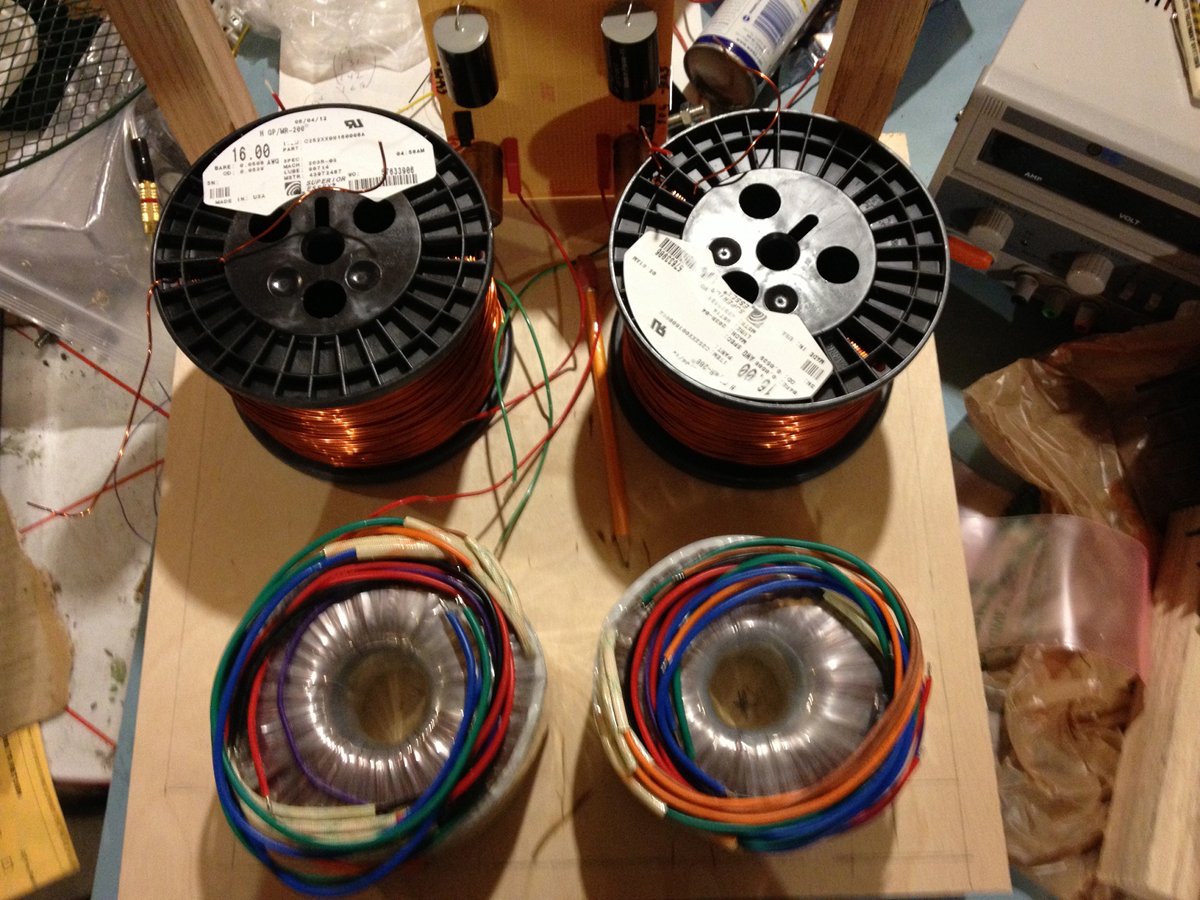

Any comments on my layout?
I am worried the Power transformers and Inductors are going to hum this close.
If you can see the signal board will mount way toward the back to keep signal path small as possible. The Heatsink and SITS will mount of the top of the unit towards the back.
Tested the signal board and inductor out. Works like a champ on two diffent Sony SITs and each channel of Signal board. Just concerned about layout before drilling in place.

Hum was a non-issue for me at roughly the same distance. I wonder if you'll get some magnetic coupling between those inductors, though. I built monoblocks. I always build monoblocks.
ma
Maybe. In crossovers, the interaction is reduced by placing them perpendicular to each other.
