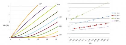

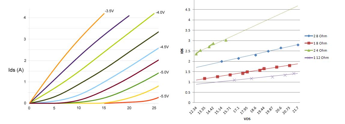

I did a quick and dirty graph of your sweet spot data with trend lines. Sorry about the labeling. The first digit is the number of bulbs. Also note the scale of the Vds is way different between the two charts. Fun to look at this way.
Best regards,
PSz.
Best regards,
PSz.
Your chart nicely shows something I described elsewhere in this thread, which is that sweet spots can be found (once you know one) by stepping the voltages and currents in certain proportion. Nelson (wizard) actually put some math to it somewhere.
