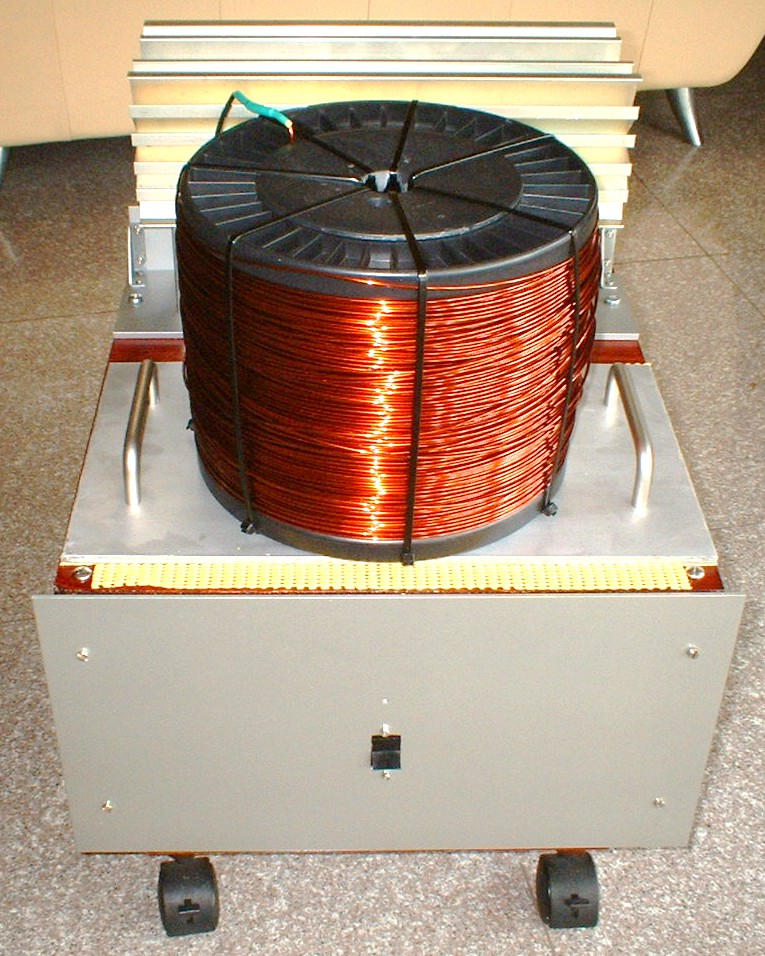

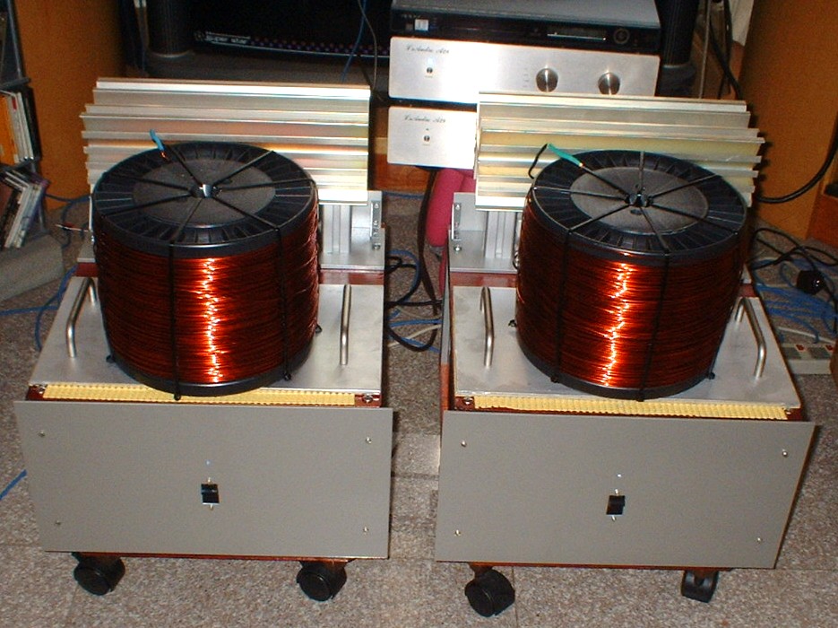

Bit late to the party, but hey ho.

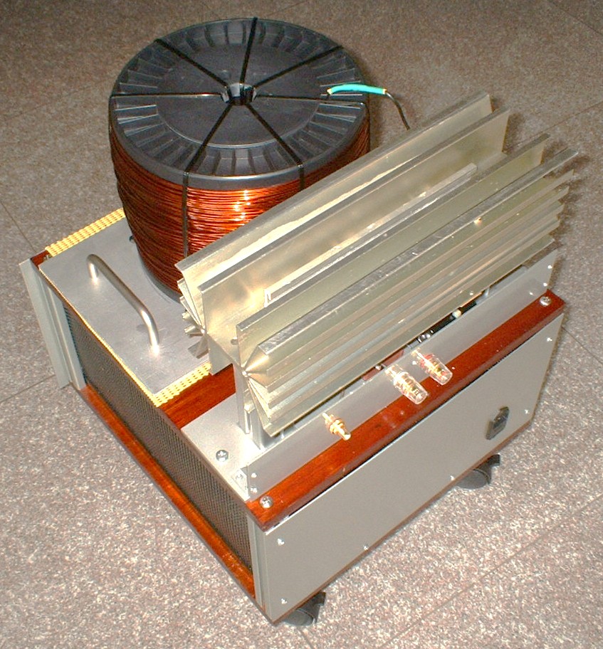

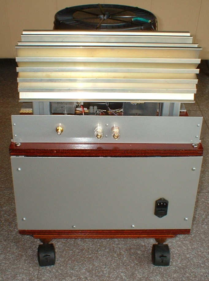

This is my attempt. Vishay thick films instead of lightbulbs as a load and CLC power supply using some 280mH surplus chokes I had. Weights it at a cool 28kg! That's an even worse power/weight ratio than the valve amps I normally build. 😱😀
Thanks!
I used 12 Ohms total. 5x 2R2 and 1x1R. Not experimented yet, though I have found a distortion minimum at about 2A. (1kHz, 1W)

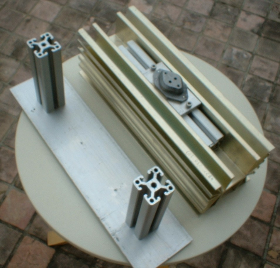

that's a very nice build,given me some ideas on how I'll finish mine with the heat sink arrangement properley mounted vertically.

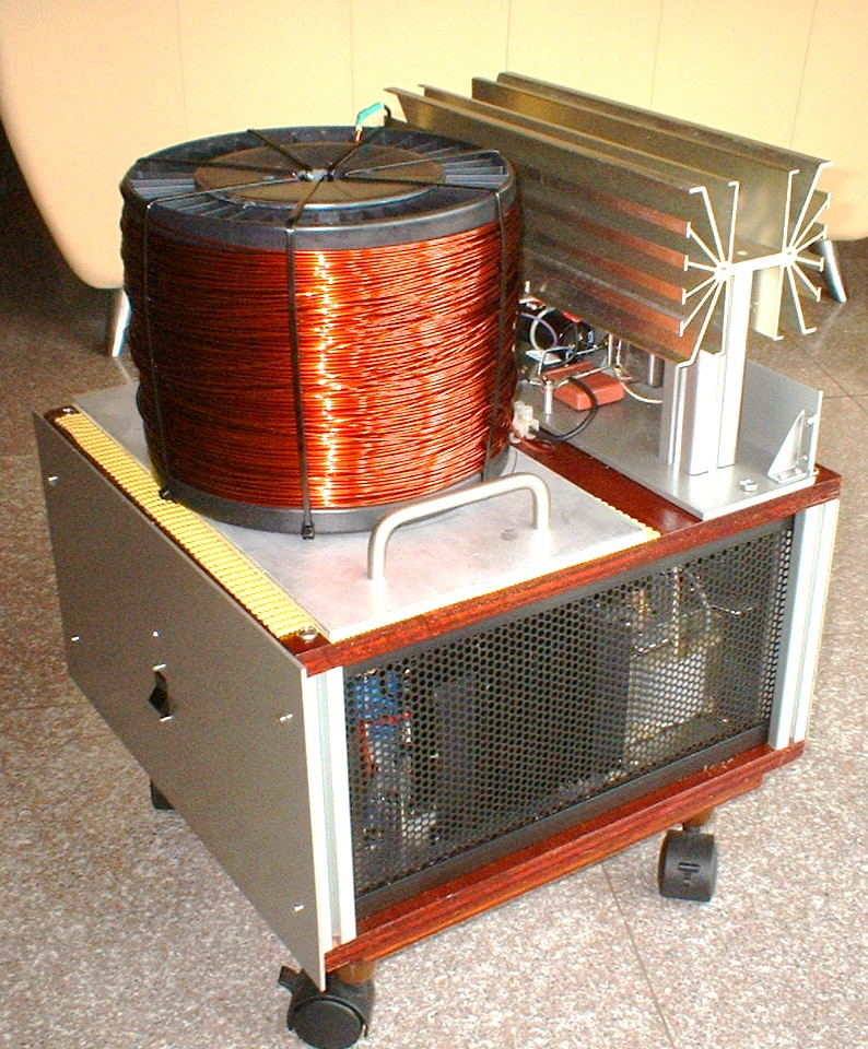

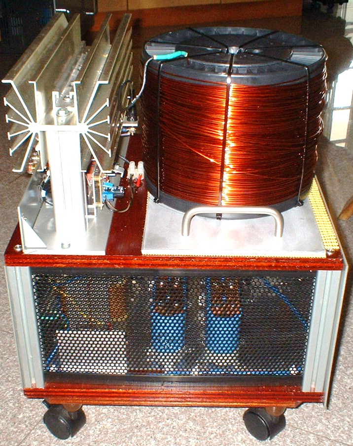

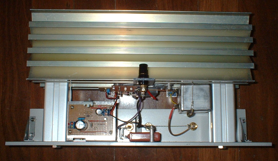

Whats it look like inside and what's the heat like from the resistors ?

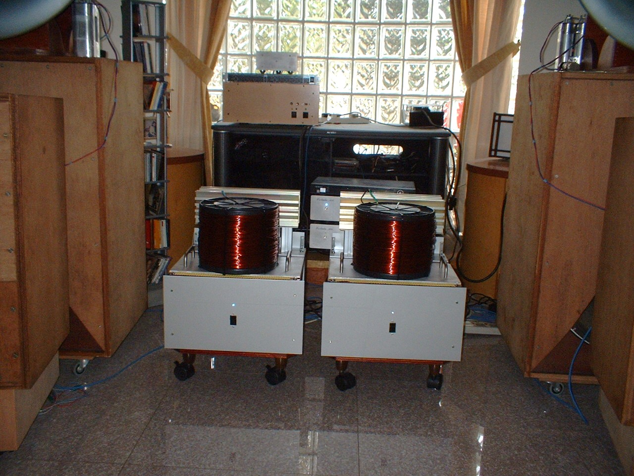

More photo.
I have the chance to hear Tony's monstrous amp. All I can say is fenomenal. WOW Both vocal and power are presented with tremendous authority. Kudos Tony and thanks for the time to have us there for the preview 🙂
