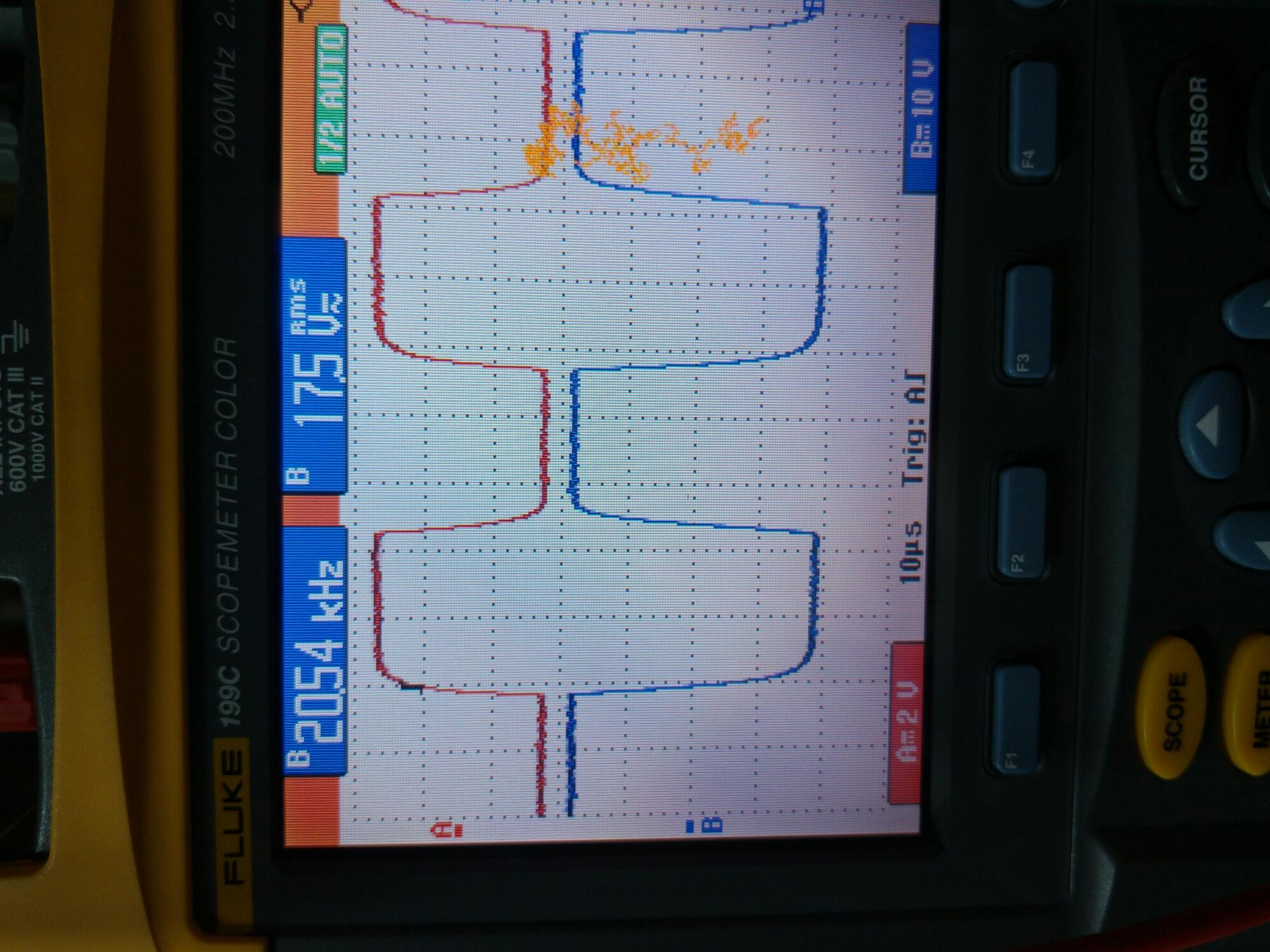

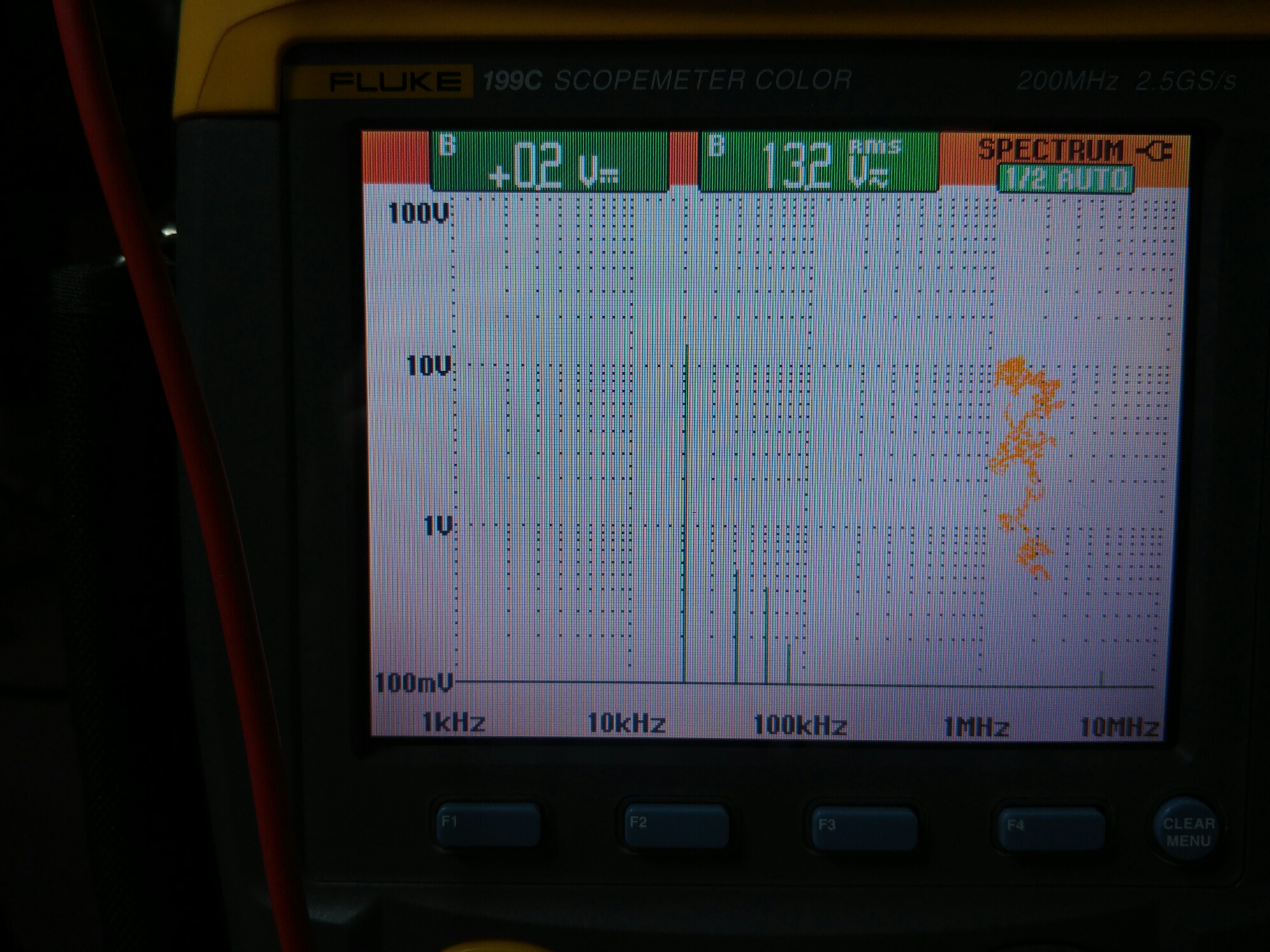

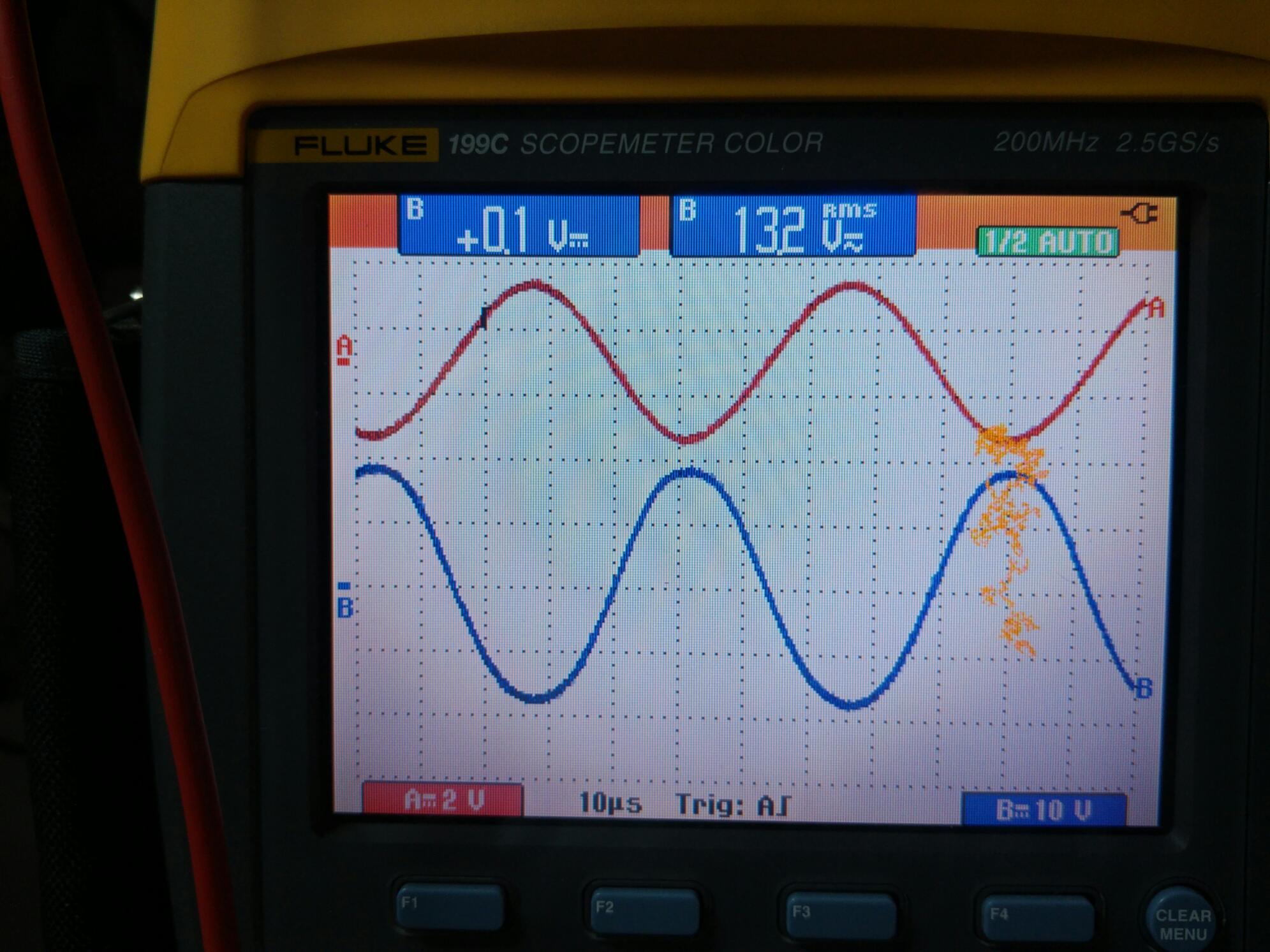

And I tried with four in parallel too. Frequency response a little worse than with only two, but flat until 40Khz (more or less).

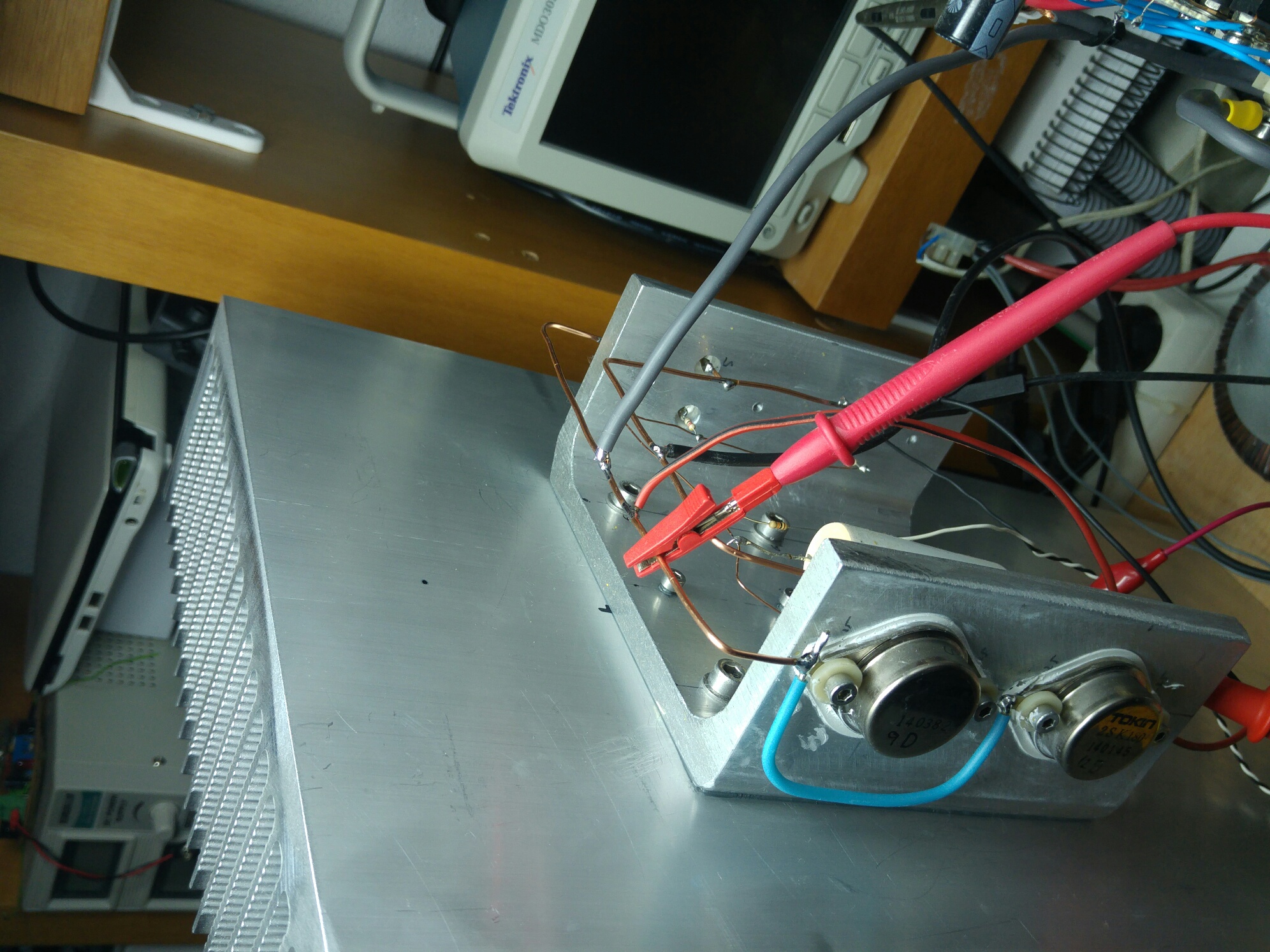

I did it too. But you need a very very big resistor. I used one of 600W and 10ohm. I got almost 20Wrms at 8ohm. And result are spectacular. But it is necessary select very well device and use more or 4A of quiescent point(these are results I got).
Actually I am using one version with 22ohm and low output current because 16 ohm of my speakers.
OK thanks! But two in parallel needs to be driven whit very very low impedance!!! So will need a buffer like sk170/j74! Ok...Maybe I will try!
With papa's buffer, you got 25 ohm output.

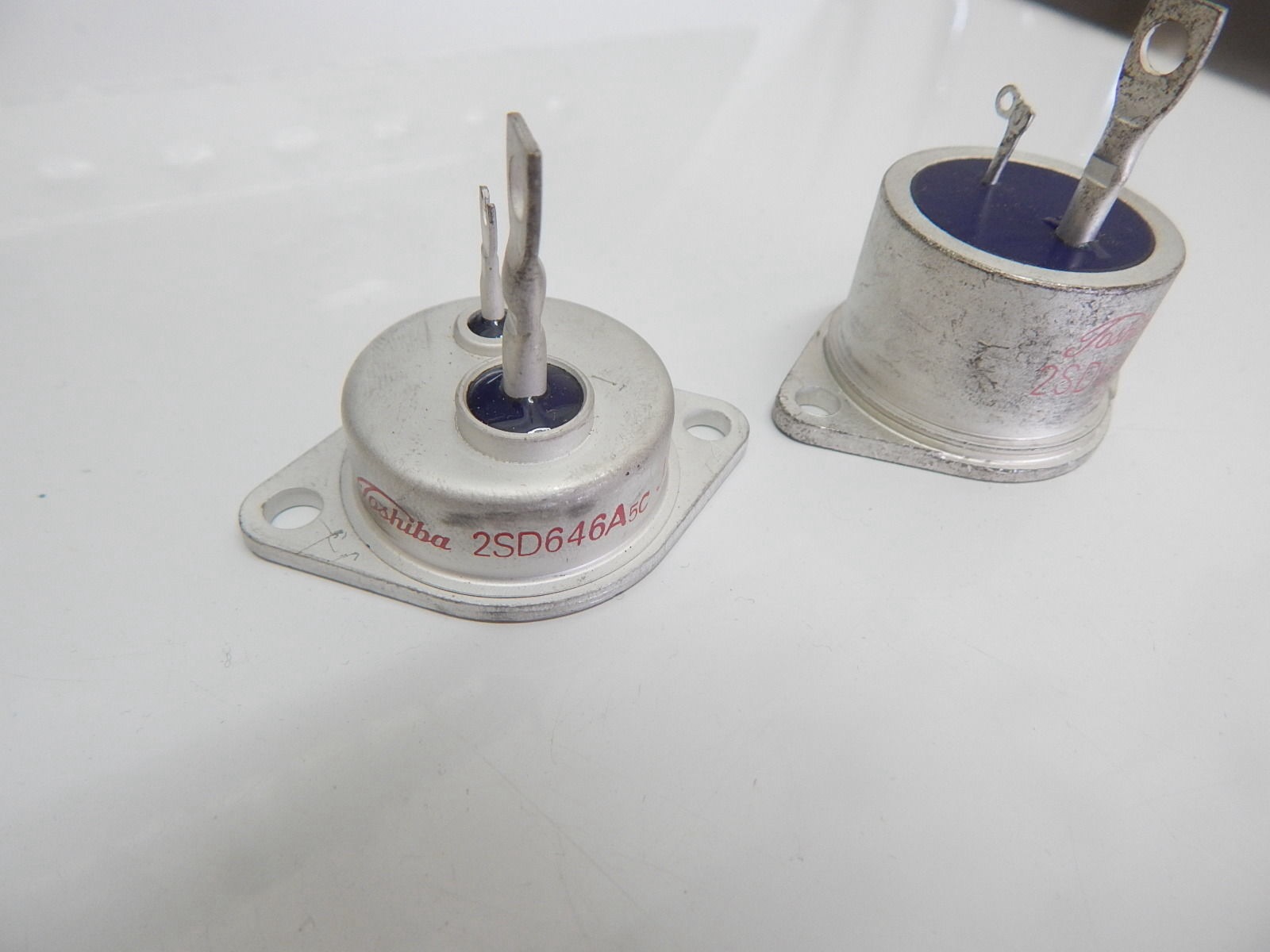

One photo with hockey pucks transistors this on left side look similar to 2SK182 ES but is not v-fet
the other on right are probaly most fat & huge transistor made by Toshiba
Greetings

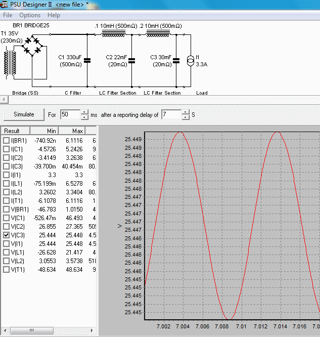

As for the power supply if found a way to have the right voltages both for auto bias and fixed bias.
I put the transformer secondaries in series and went for choke input with adjustment of the voltage by adapting the value of the first C.
Currently i am running the fixed bias amp version with 25.5V B+
The selfwound inductors take the voltage down to the 21.7 (@~1.65A)
Also there is a second choke and residual is now 3 to 4mV @3.3A
This supply is for both channels!
