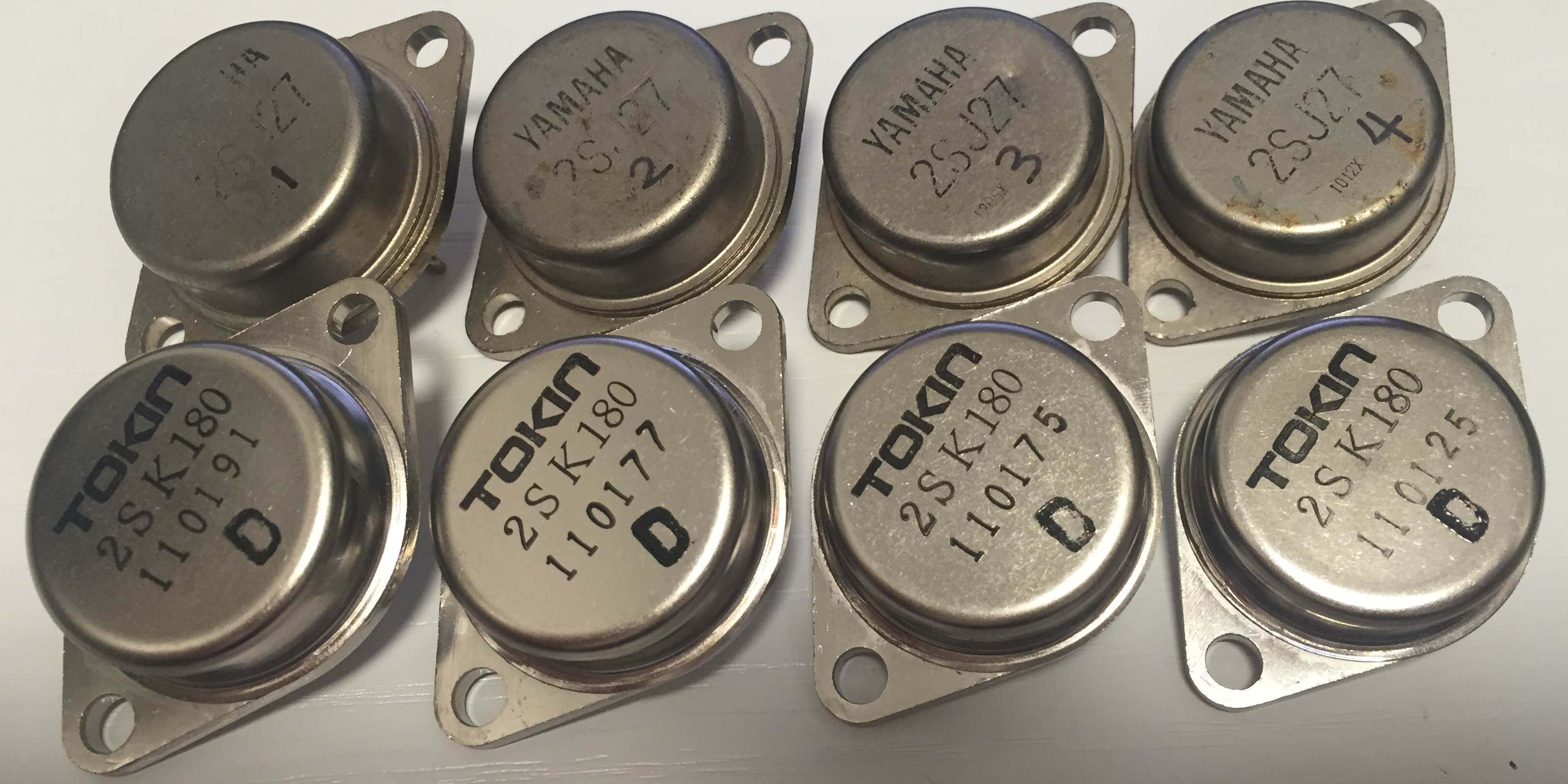

Pirate, here is mine and don't kill me ... they may not be as complementary as the 2SK82/SJ28 pair, but with a little source degeneration they're powerful pairs 😛

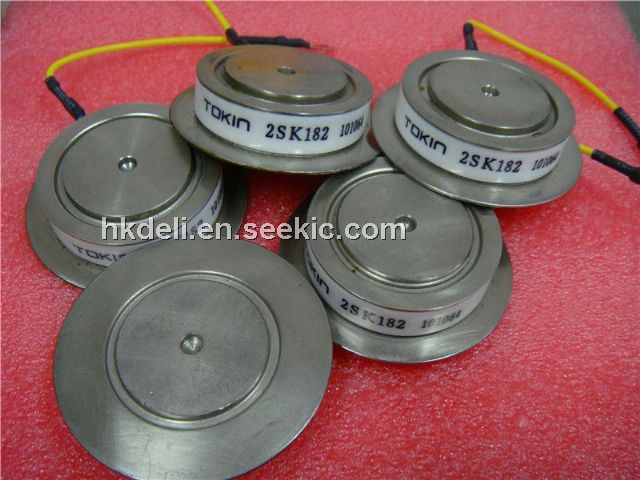

V- Fetron 75 watts power version made with big hockey puck sit's not 2SJ28 ?
Wait for more informations from Mr. MR update 🙄 Best regards

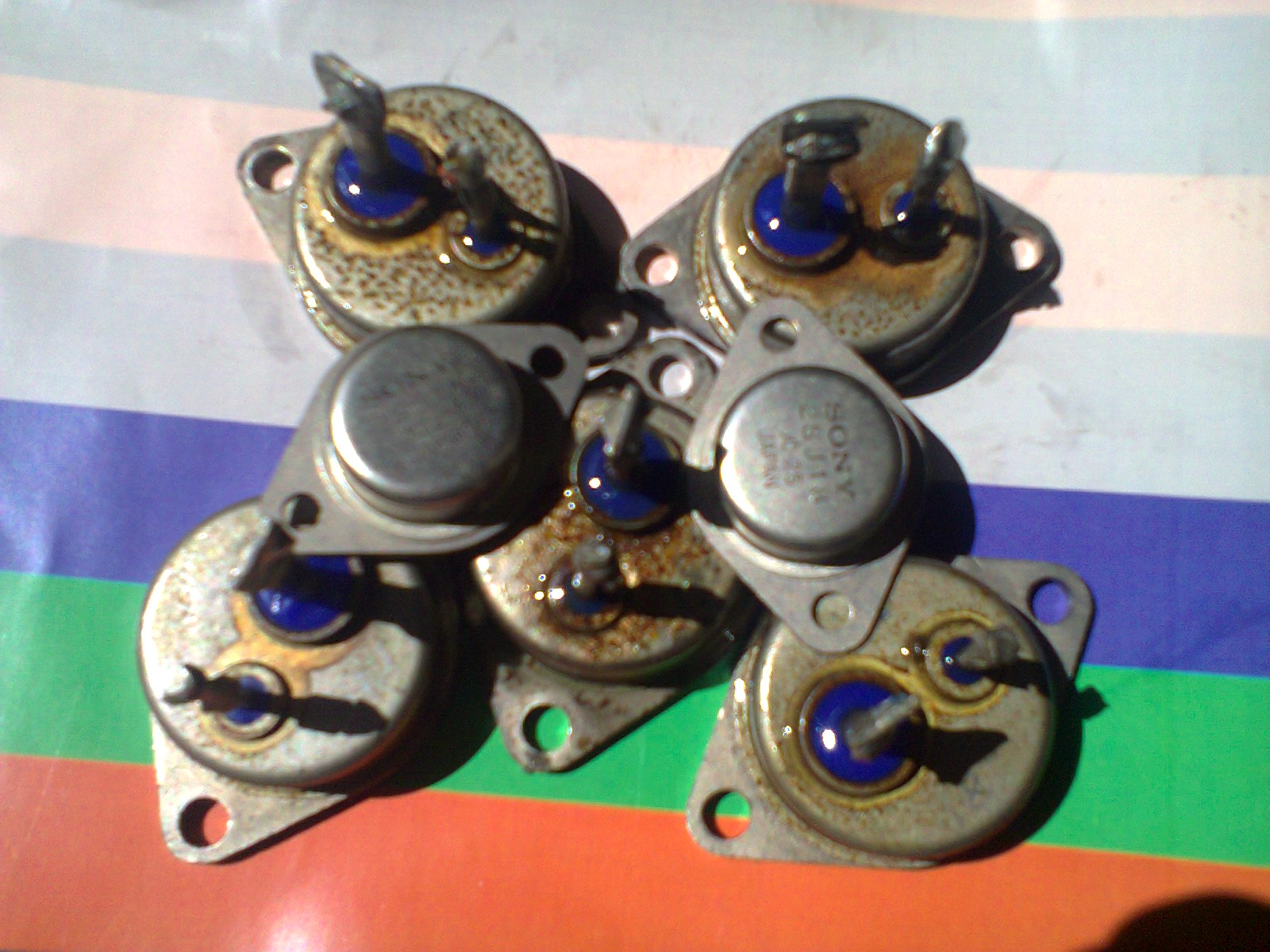

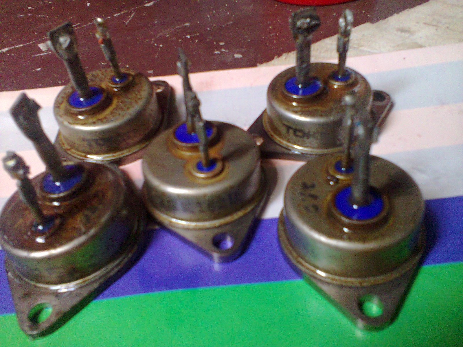

Hi all. Please caution with tokins. I have measure a lot of THFs and 2sk180, 182 and between them there are a lot of variability. I suppose that all what we can get from chinese sources are rejects from production. So may be necessary buy a lot, get curves and then select the better ones. I have mounted one lamp with two THF51 not very similars each other and really I can perceive what different are each other. Sorry
