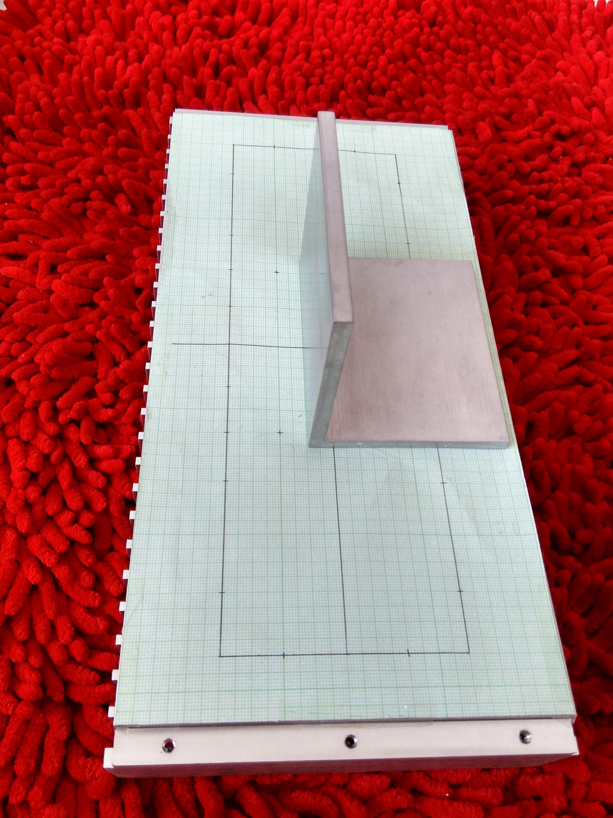

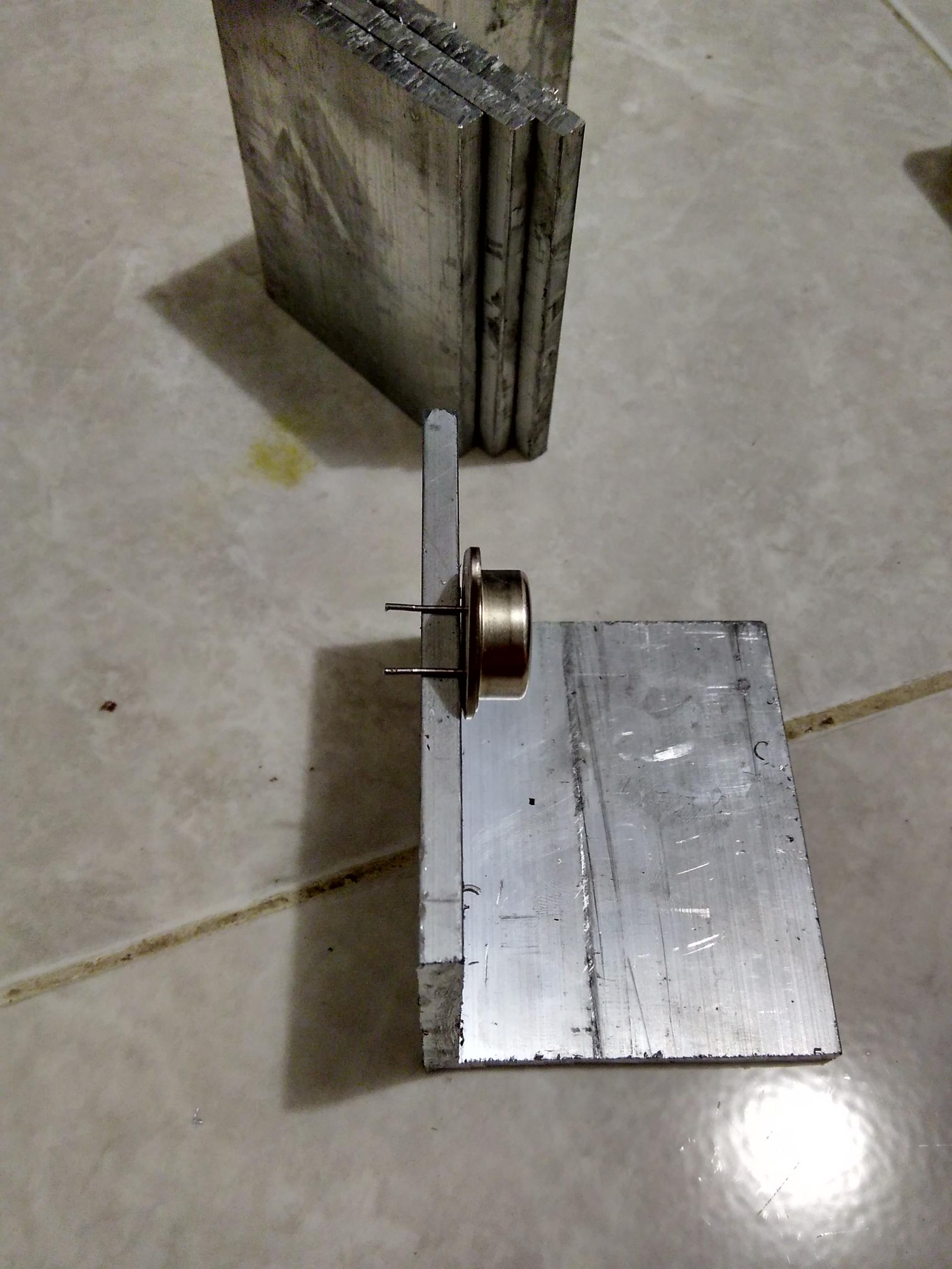

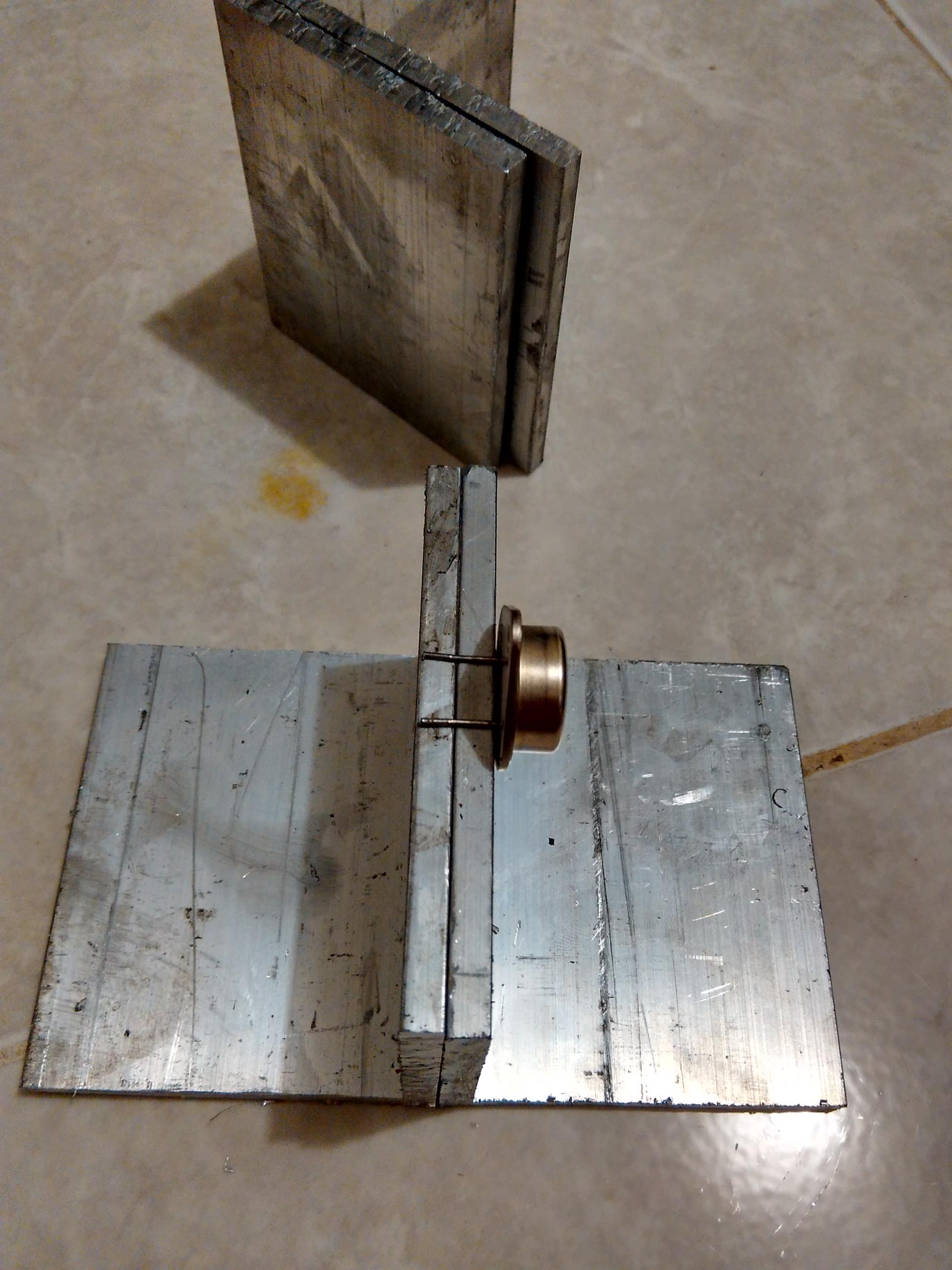

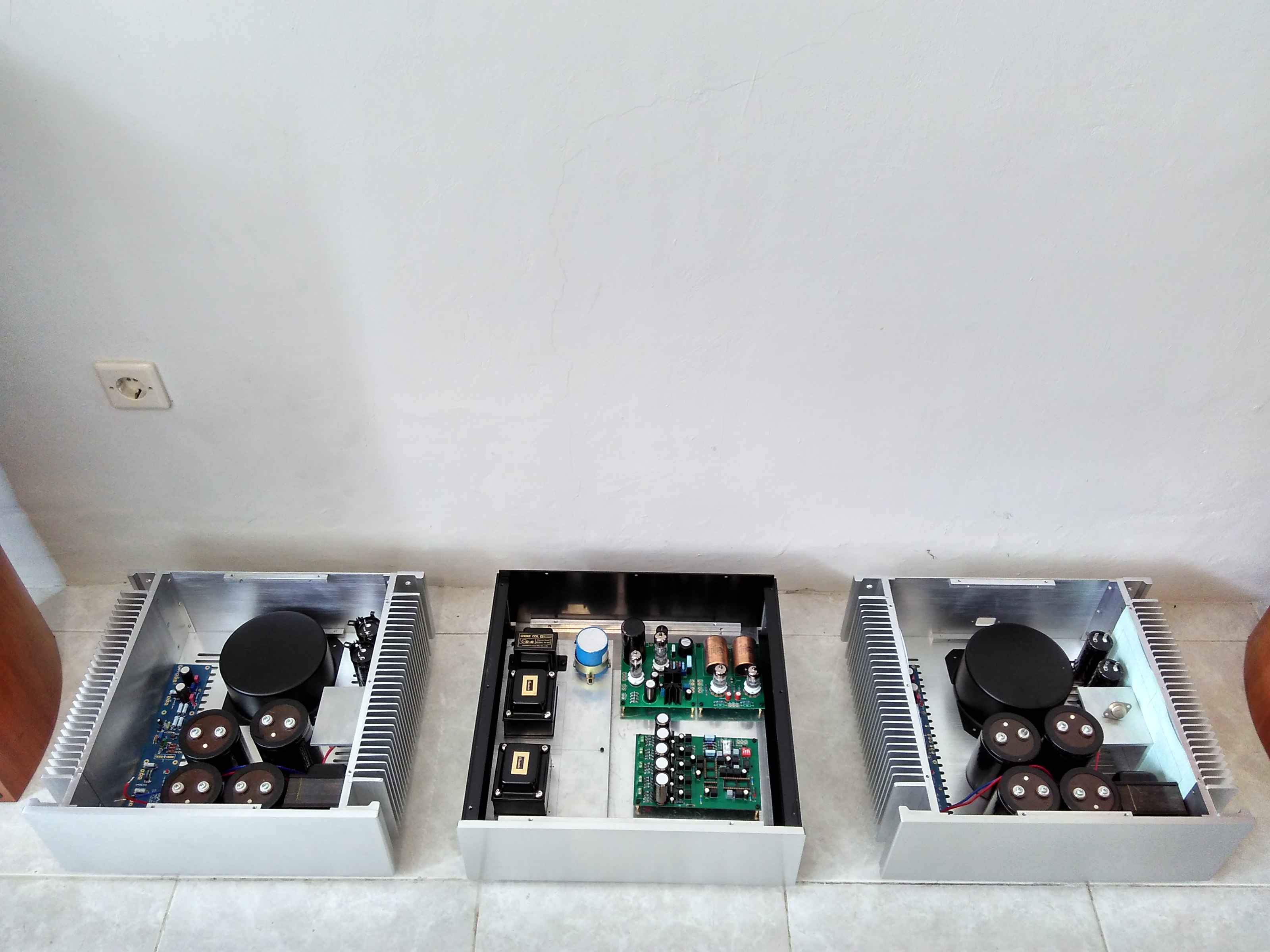

i got L profile 76x76mm with 6mm thickness, it's cut into 90mm length. it's spesified as 6063 alum. is it enough for SIT? or should i put them back to back?
@ Gadut
Back to back are little to much...

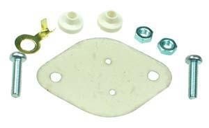

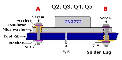

generic transistor TO-3 package picture show you all details.
Vfet Sony case is the drain.
Attach your L profile with minimum four screws
to heavy big heatsink with lot thermal paste grease
in between for good transfer of heat
like usualy in all class A amplifiers.
I try and its work for me to clean L profile
with small fine grains sand paper i polish
them is easy brigh like new and free from
oils or dust. Good luck in diy the amplifiers.
Greetings

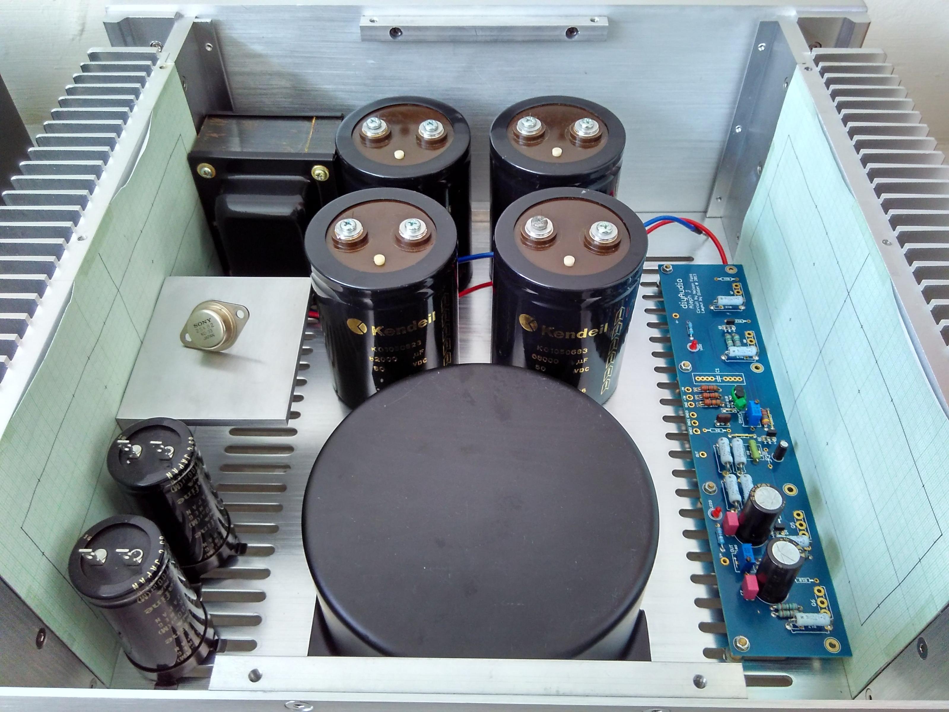

running 3 paralel projects : dac ad1865, AlephJ, SIT L'amp. each of them had been initiated more than 1yr but none completed, maybe i just love soldering and drilling.
for SIT, i got 4U chassis, together with AJ in monoblock. i'm still finding best compromised layout, already prepared UMS on heatsink to be drilled, L profile fits perfectly on the middle buttom of UMS
