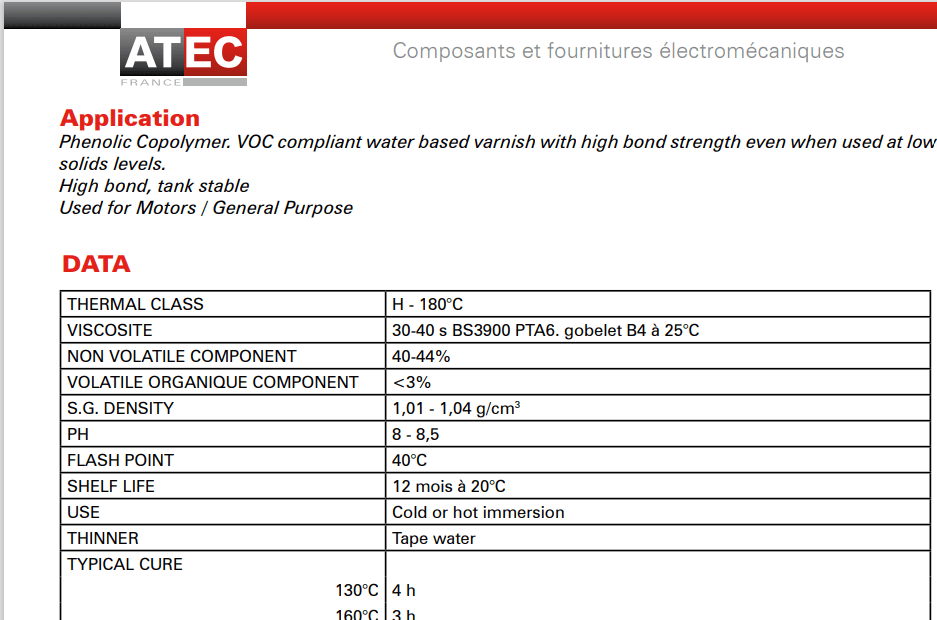

What is the glue's purpose?
1. Impregnating the dielectric?
2. Fixing a transformer winding in place
3. Fixing wire outputs or winding edges in place?
Hi
I varnish with a brush layer by layer to block the coils mechanically
For wood glue, I 'm thinking about "white glue" for assembly, polyurethane sealer for parquet that I'm using is also water base.
I dry it in an oven at 100°C.
Parasitic capacities become less important during drying.
