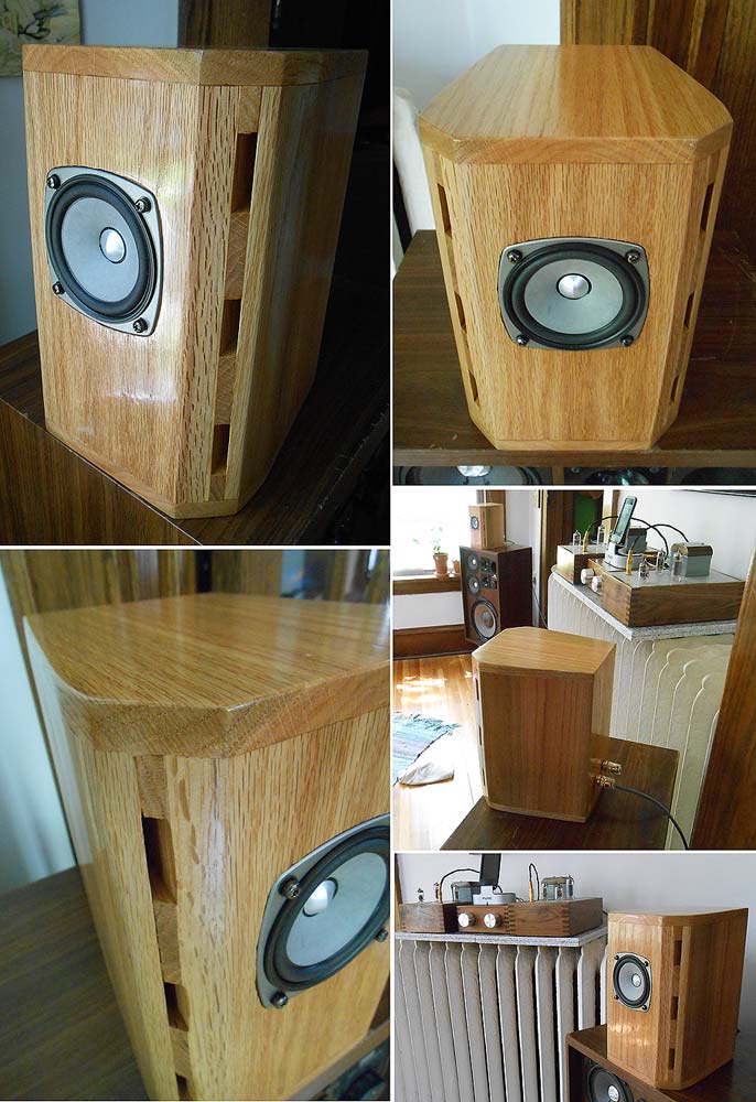

They look great. Did you use the lam oak with the grain running vertically on all vertical sides?Last year I built two projects from 1" thick laminated oak boards.

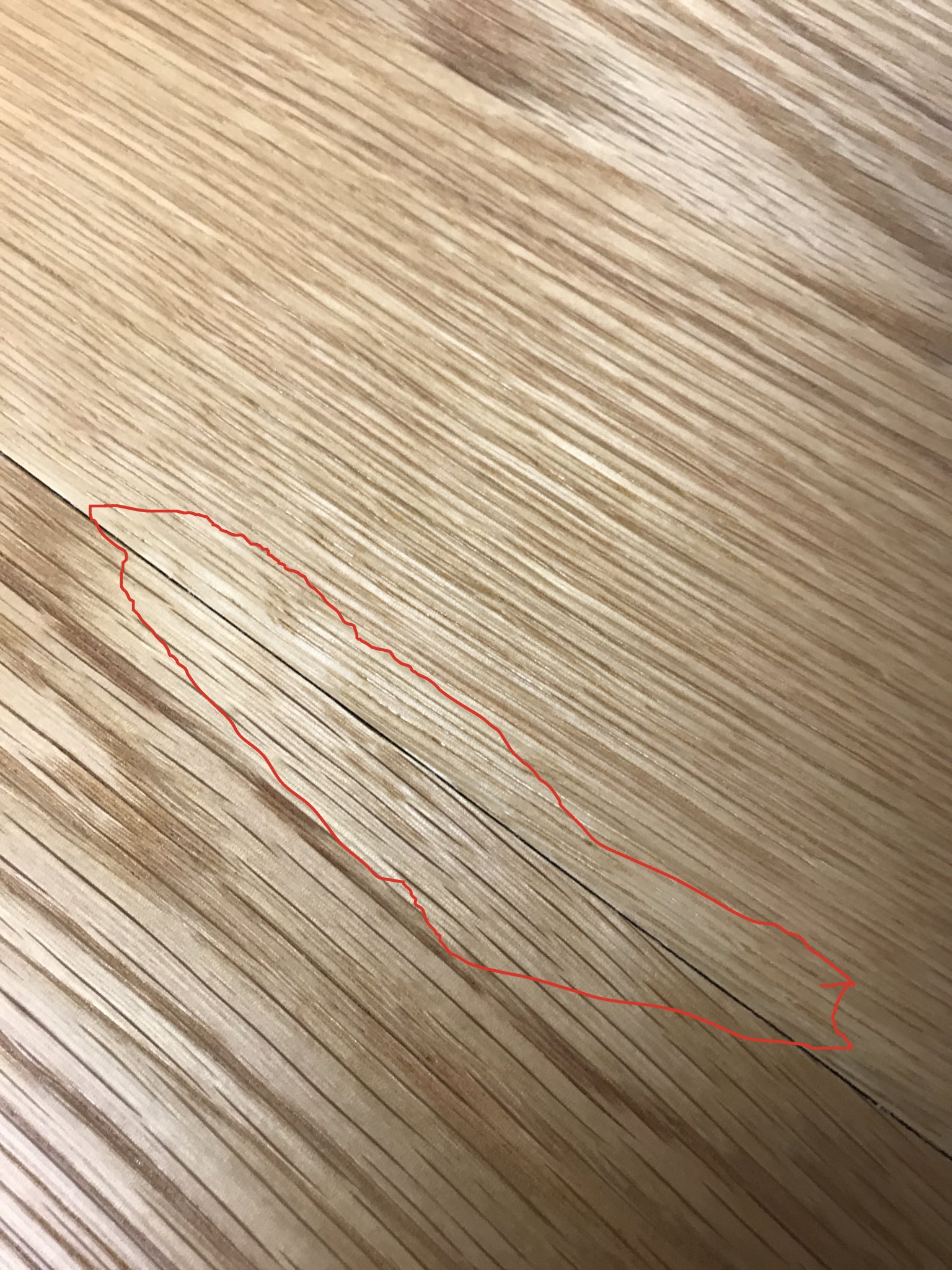

Where did they crack?The only slight issue I had was some minor cracking which developed in the dry winter months.
Maybe look at marine grade epoxy resin to seal the wood. All surfaces would need to be sealed. Screw holes too!I used a danish oil finish which probably wasn't heavy enough to prevent the wood from further drying. I think a varnish finish would avoid this.
👍Otherwise, the laminated oak is very rigid, quite heavy, and it does sound good. It's also nice to not worry about ruining the thin veneer that's found on plywood.

Thank you. Yes, I used the same laminated oak for all parts with vertical grain on all sides.They look great. Did you use the lam oak with the grain running vertically on all vertical sides?

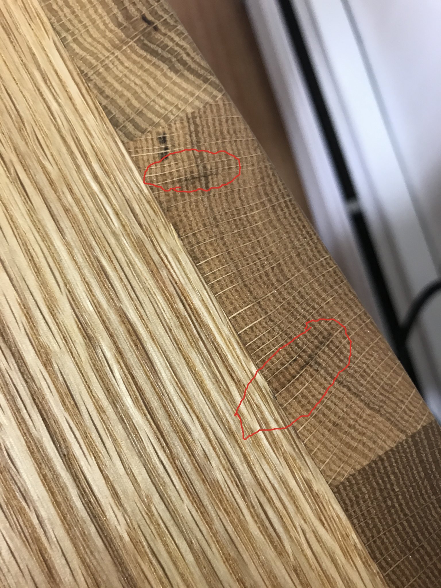

Photos below. One lamination seam opened up about 0.010" on the outer surface only. Two other cracks on the end grain of one board. All reverted a lot after winter was over and the humidity increased. The two on the end are closed now and not really noticeable.Where did they crack?
Thanks. I will look into a marine grade finish and possibly some humidity control.Maybe look at marine grade epoxy resin to seal the wood. All surfaces would need to be sealed. Screw holes too!
Photos below
Thanks for the high definition photos and circling the cracks as I wouldn't have seen them otherwise! I cant see marine epoxy being worth it for these speakers now they are finished. On the oher hand the humidity control in winter might make you more comfortable and look after the speakers as a side benefit.

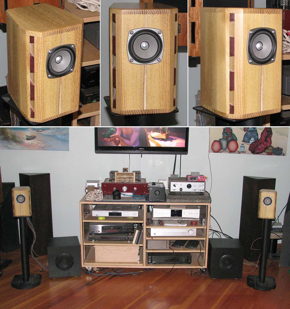

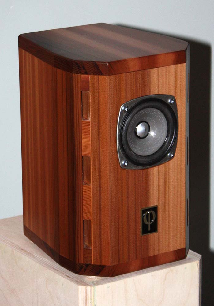

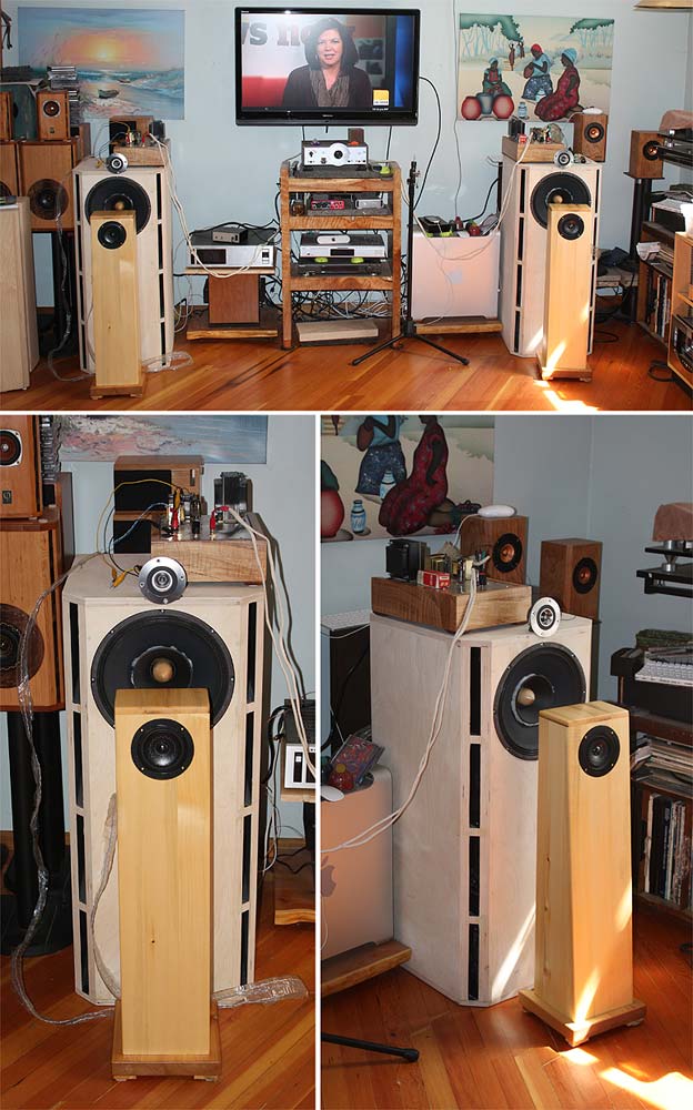

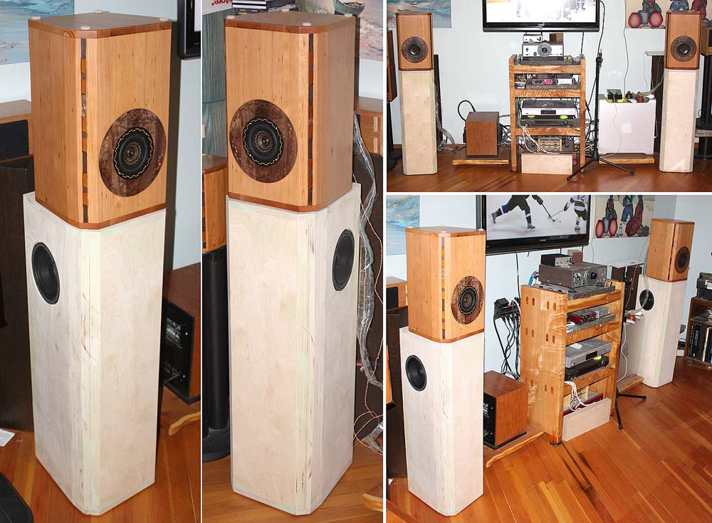

Some examples of Bernie’s work in solid. All edge laminated solid wood sheets.
and Nick’s:
dave
and Nick’s:
dave

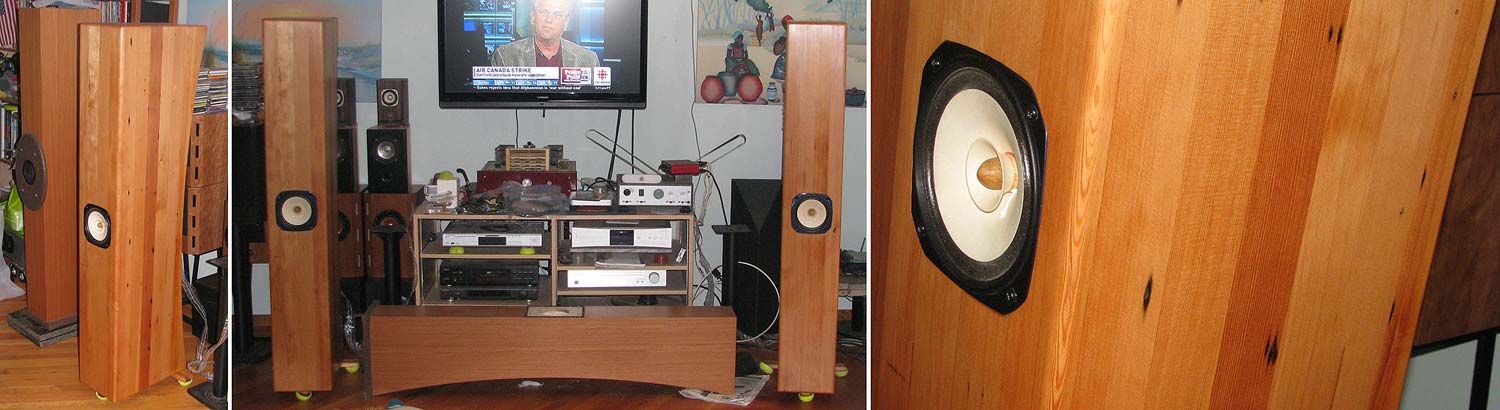

From the POV of cabinet integrity one of the best are the western red cedar µFonken. The downside is how easily it is bruised. The big ones are Douglas Fir (a pine), old growth aged for 70 years as Bernie’s floor. The Mar-Kem70T are as well. The Compact Floorstander Mar-Kel70 are yellow cedar.
Others are locust, yew, black walnut, mahogany, and oak.
The ones that most impressed are the cedar ones. Need old growth thou.

For Bernie and Nick (apologize but I don't know if they are posters here to tag), first, those are beautiful.Some examples of Bernie’s work in solid. All edge laminated solid wood sheets.
and Nick’s:
dave
Some of these designs seem to date back to the early 2010's, have they faired well (especially if that radiator is the functional heating system)?
Do they have any tips/methods on how they may have addressed the wood expansion, specifically where the tops and sides meet (it appears the top grain is aligned to the front grain and so the greatest expansion will match (side to side), but the sides' greatest expansion would seem to be front to back while tied to the location where the top would experience it's lowest expansion)?

I can’t speak for Nick's but the ones i have from Bernie have held up. He did need to do a bit of remediation on my Yew µFonken, as well as a set of highly abused garry oak.
Scott had a crack he had to fix in one of his yellow cedar builds.
