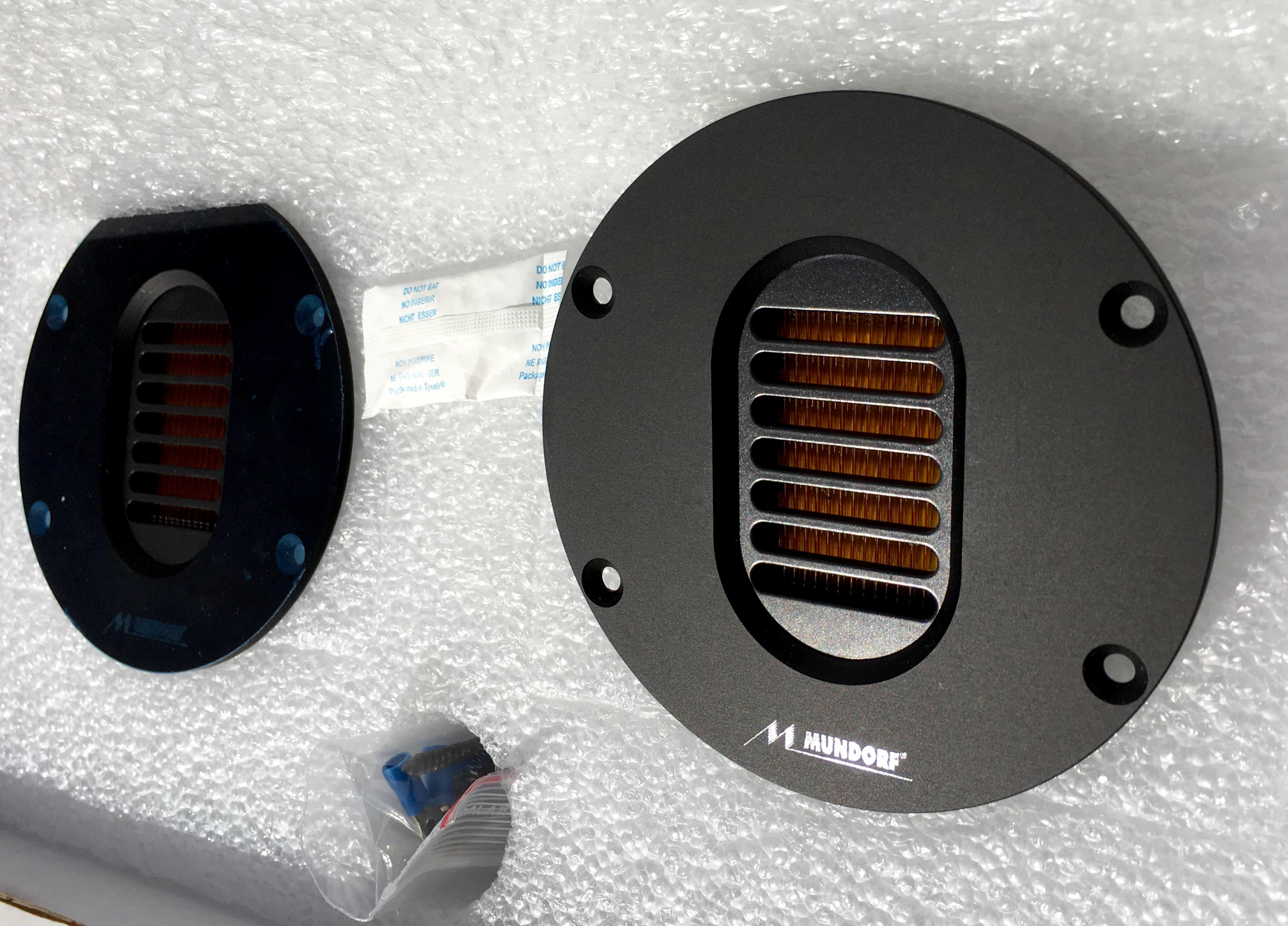

More 'trouble' from FedEx... It shouldn't take long to pop these into the test boxes...
