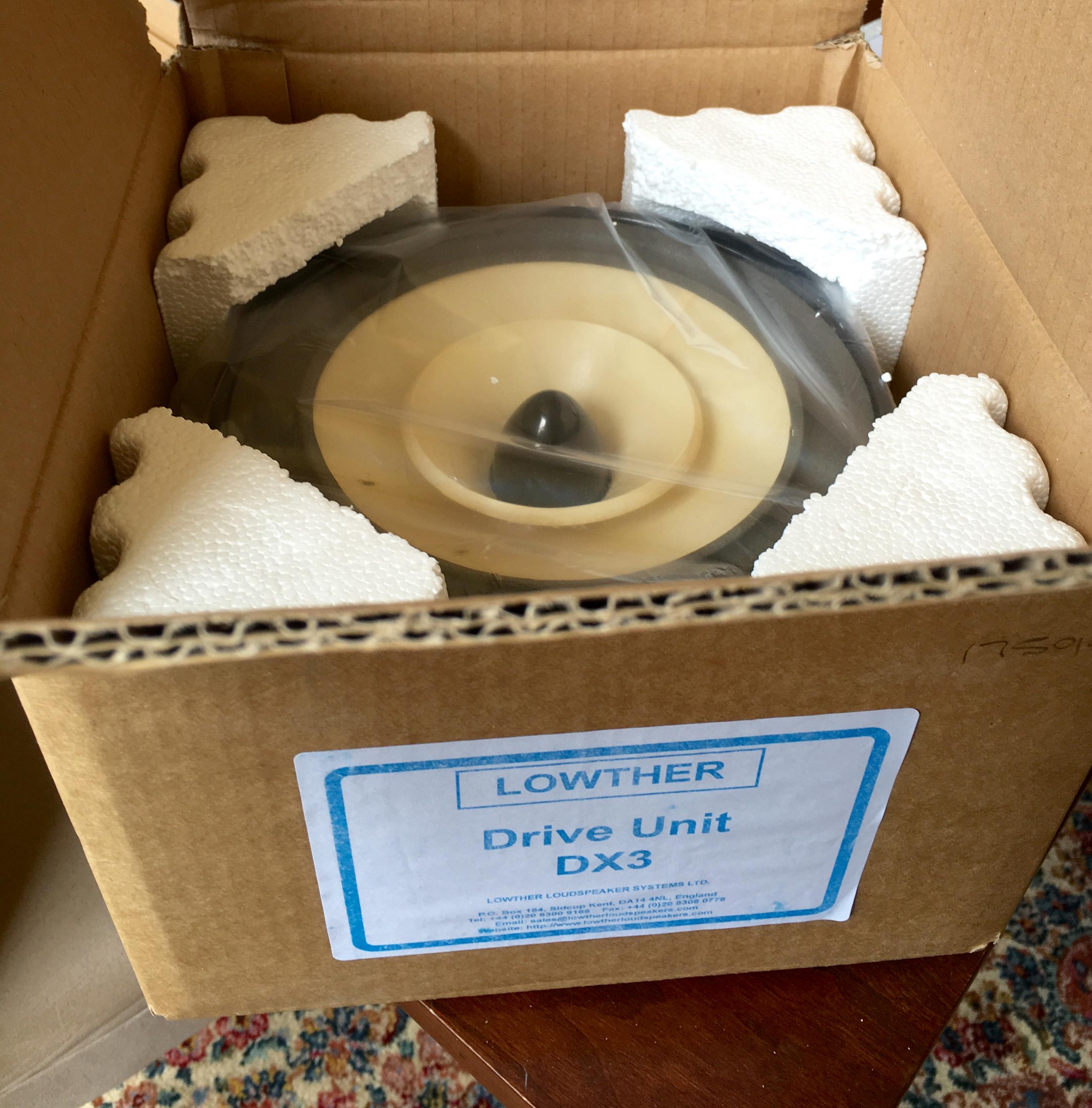

Trouble. Crossover experimentation time about to become (more) scarce. FedEx just delivered a pair of these, and new Mundorf AMT tweeters are OTW...
Lucky you!
Crossovers may not be so necessary, but I forsee some notch filtering in your future 😀
An unholy alliance of digital and SET tube amps perhaps?
Nope, I'm done rolling tubes. I had a triode preamp that sounded SO sweet running NOS government radar surplus 6SN7s. After they were no longer available, nothing else measured up. I 'graduated' to an all balanced signal chain and have never looked back. I'm replacing some vintage JBL LE8T-H drivers, one of which is getting 'raspy'. The nice thing about a full range driver as midrange is that vocals can stay completely within the mid band. Cheating, perhaps, but it has been very effective in the past.
