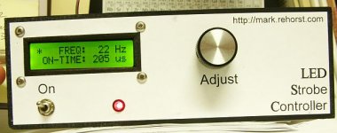

Use a CAD program or other accurate drawing program to draw an outline of the panel in full scale. Add center points (crosshairs) for holes to be drilled. Add text as desired.
Print at 1:1 scale using a laser or inkjet printer. Spray front panel piece with spray-on adhesive. Apply printed front panel. Drill/cut holes as required. Peel off front panel label. Clean adhesive off with goof-off, mineral spirits, or whatever is handy.
Print another copy of the label. Spray the drilled front panel with adhesive again. Apply the label again. Cut holes through the paper where there are holes in the panel.
You can run the printed label through a laminator before gluing it to the front panel. That will protect it from dirty fingers and wear.
Here's one I did recently. It takes only a few minutes and the result is pretty good.

davidlzimmer said:Very nice! But what if you want the natuaral metal finish?
Then you do something else.
Natural metal fisnishes are so industrial. Use more imagination... How about fractal patterns in 64k colors? Photos of clouds or tornadoes or lightning? Beautiful nudes reclining on chaise lounges? Your favorite anime characters?
