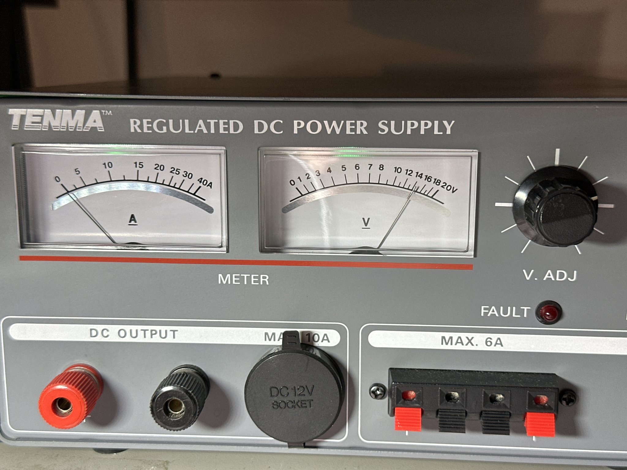

My power supply has not been able to go up to 20v since I got it, I had gotten it to go up to 14v but it does not want to go higher than that.
Recently it has decided it won’t go above 10v (second photo, voltage knob is turned to max)
Any ideas on how to fix it? Should I recap it?

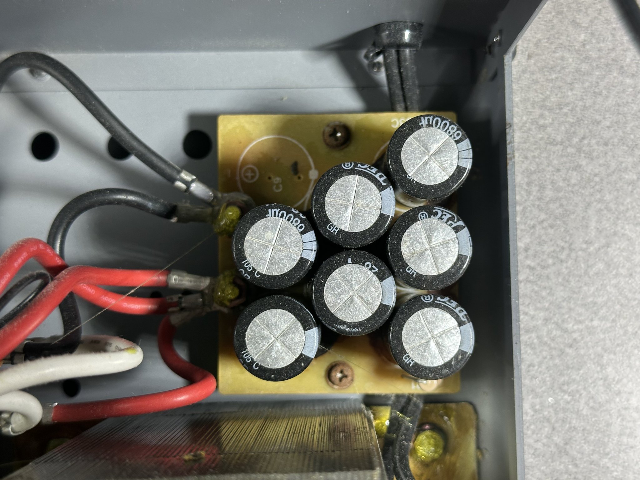

Does it get worse with load? What voltage is there across the ten 4700 uF electrolytic capacitors?

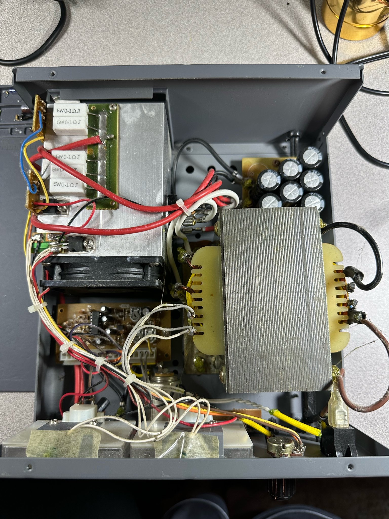

You are right, I missed the A. I haven't a clue whether the schematics are the same, but I assume yours is also a series regulated lab supply with a high maximum current. If so, there should be a bank of fairly large electrolytic capacitors used for smoothing the rectified voltage.

I do feel the caps you describe are bad

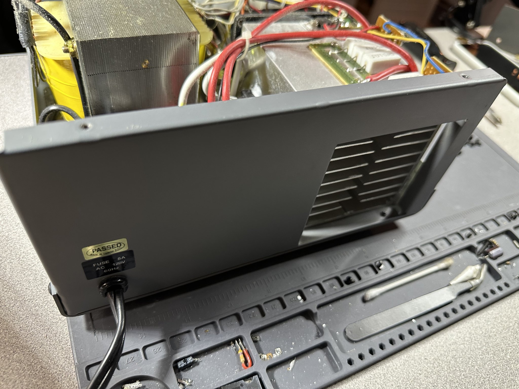

Just to be sure: is there a switch for different mains voltages at the back and if so, is it set correctly?

No switches on the outside besides the on/off

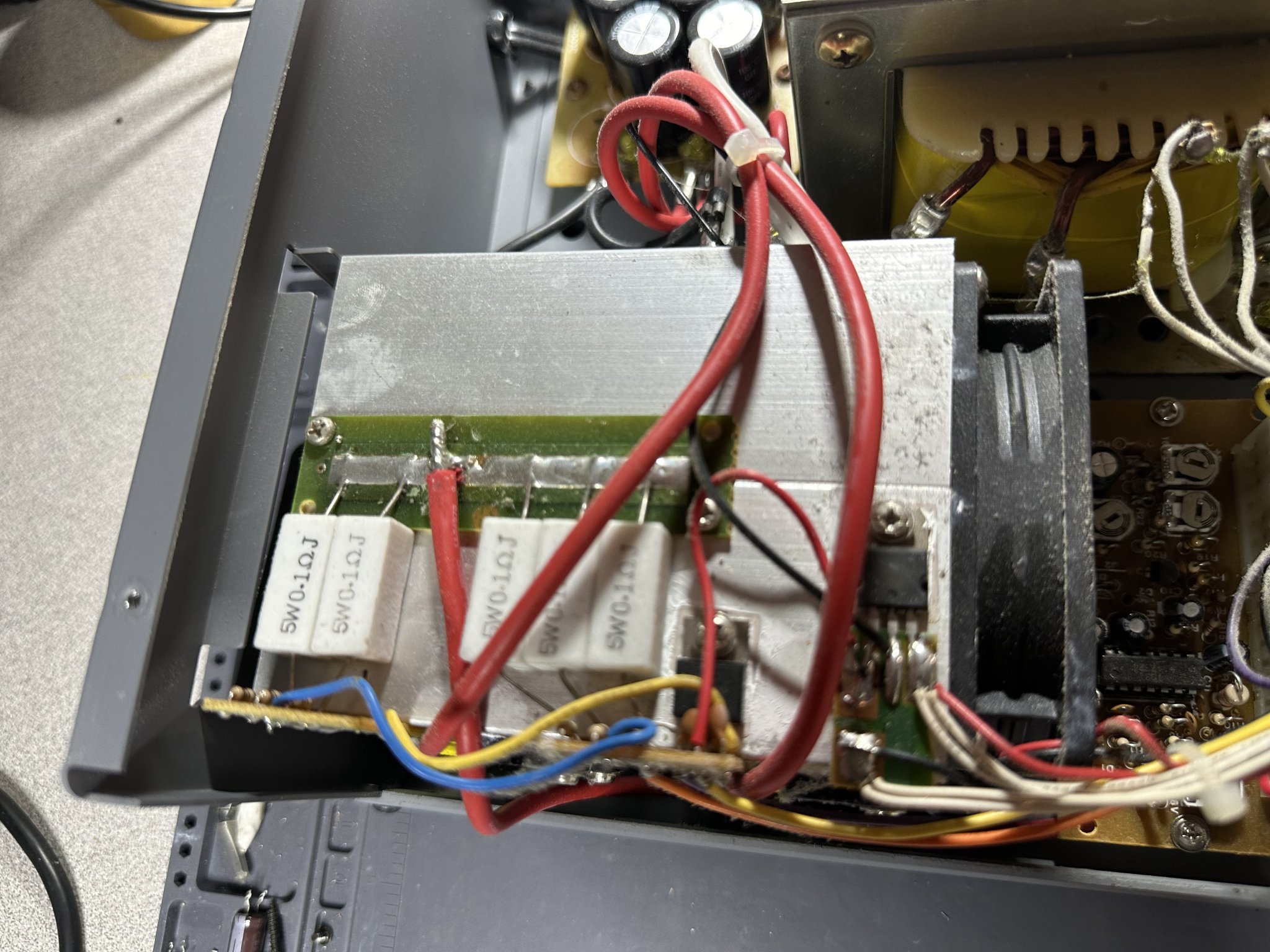

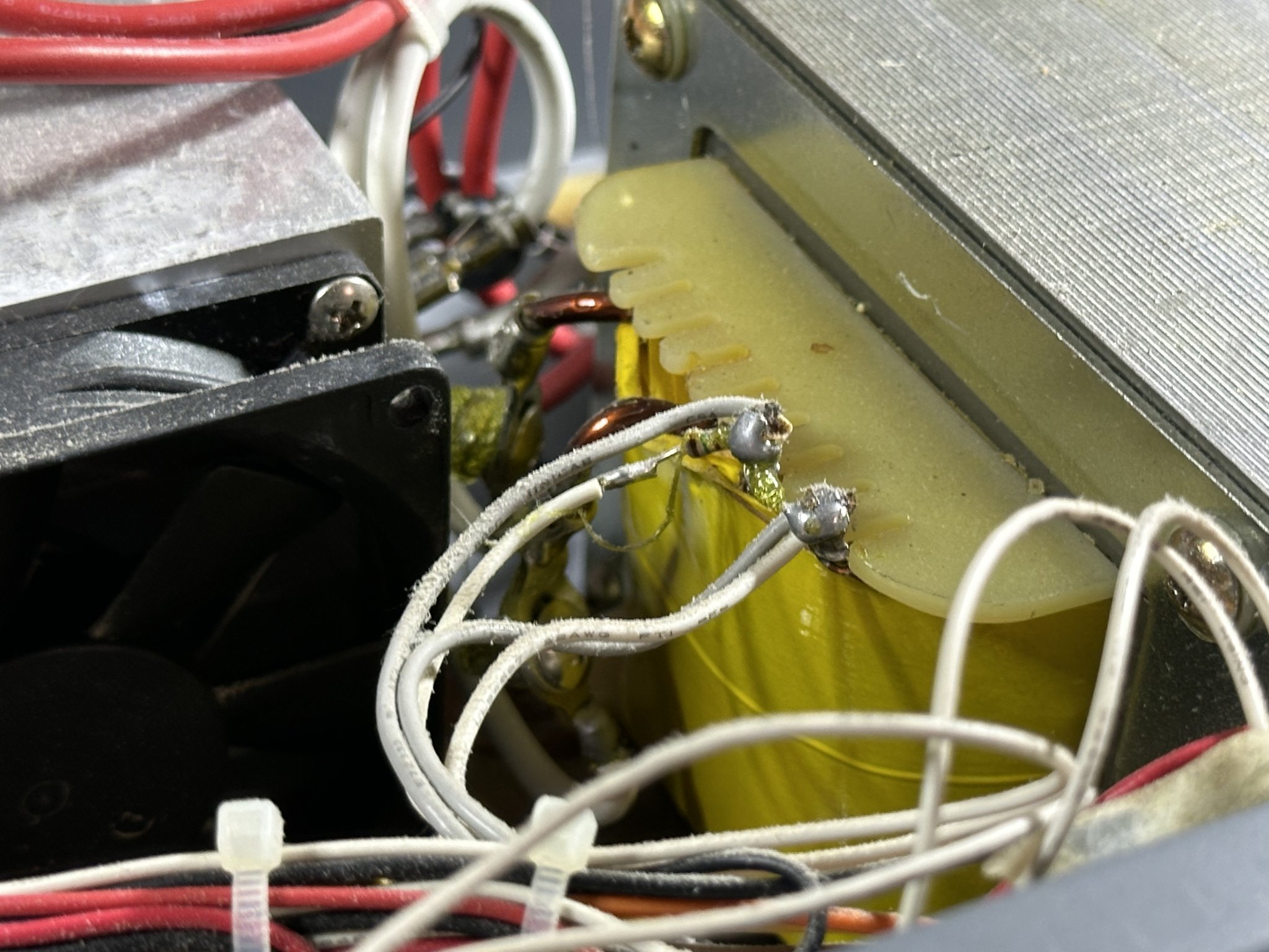

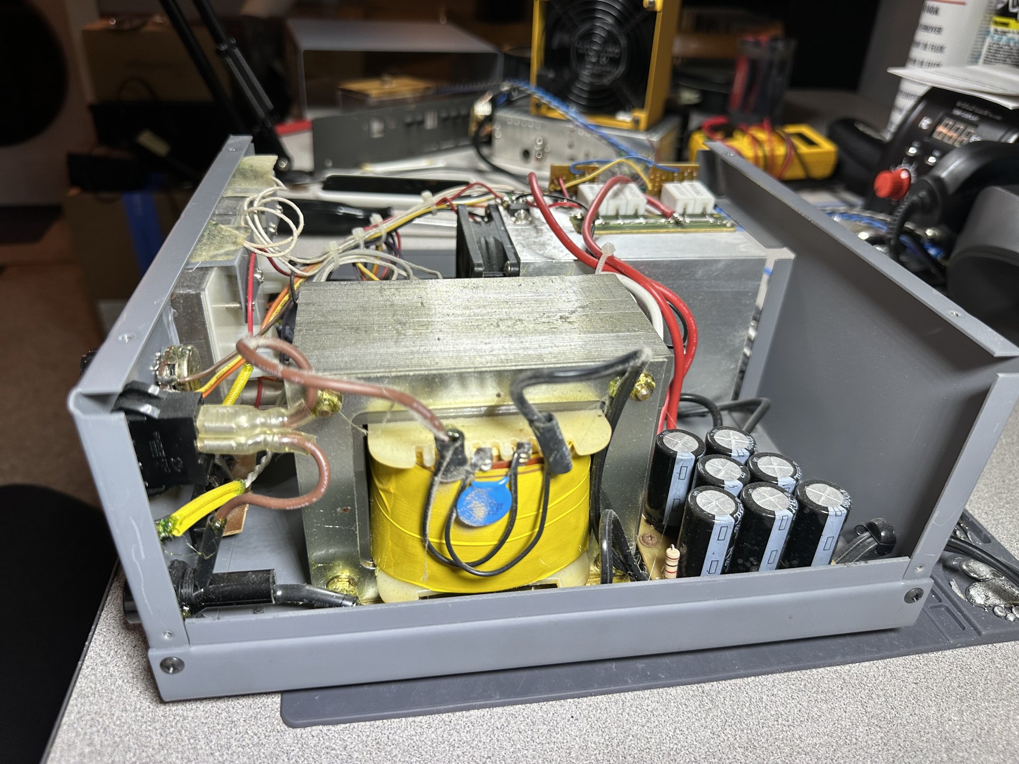

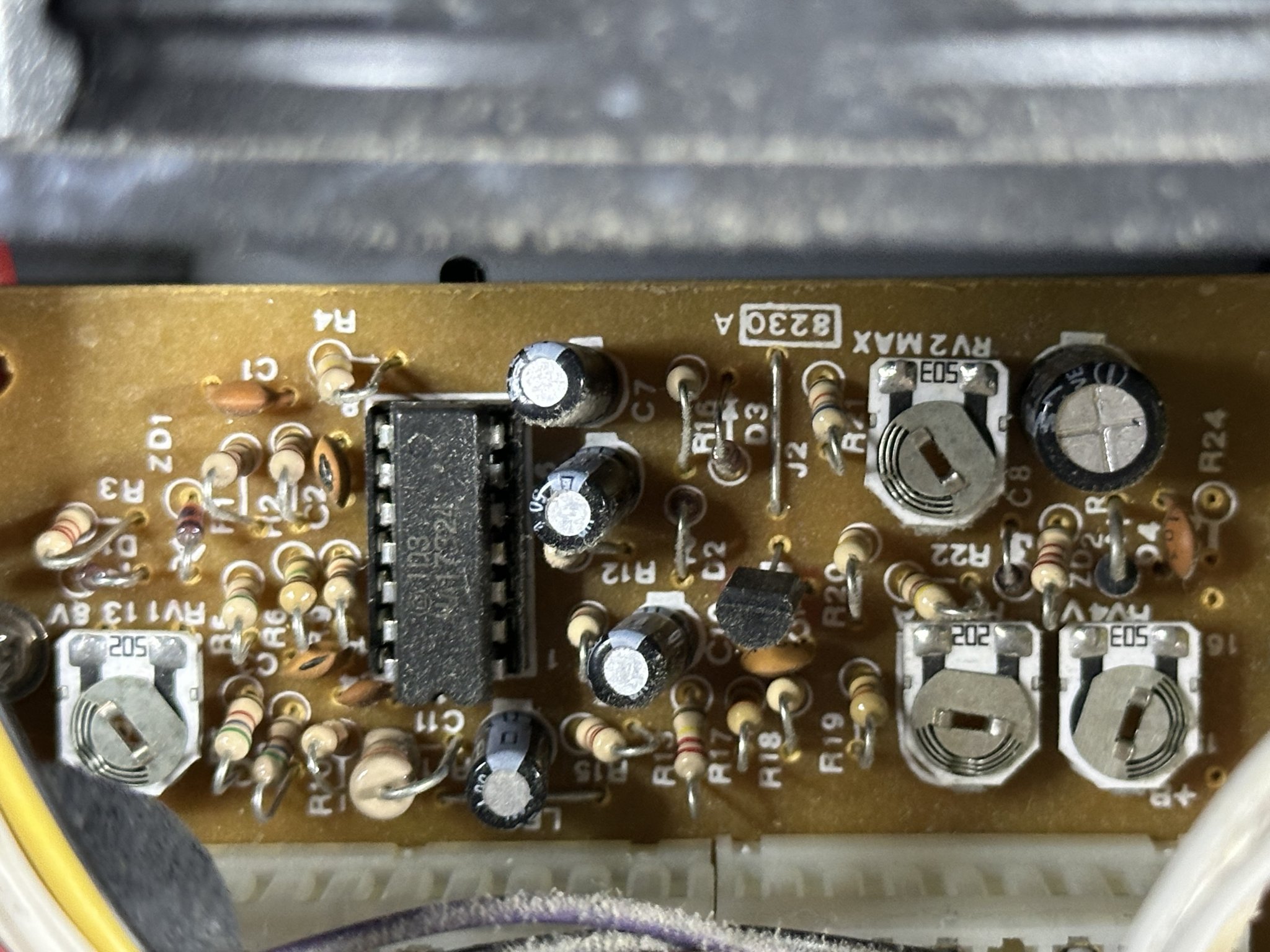

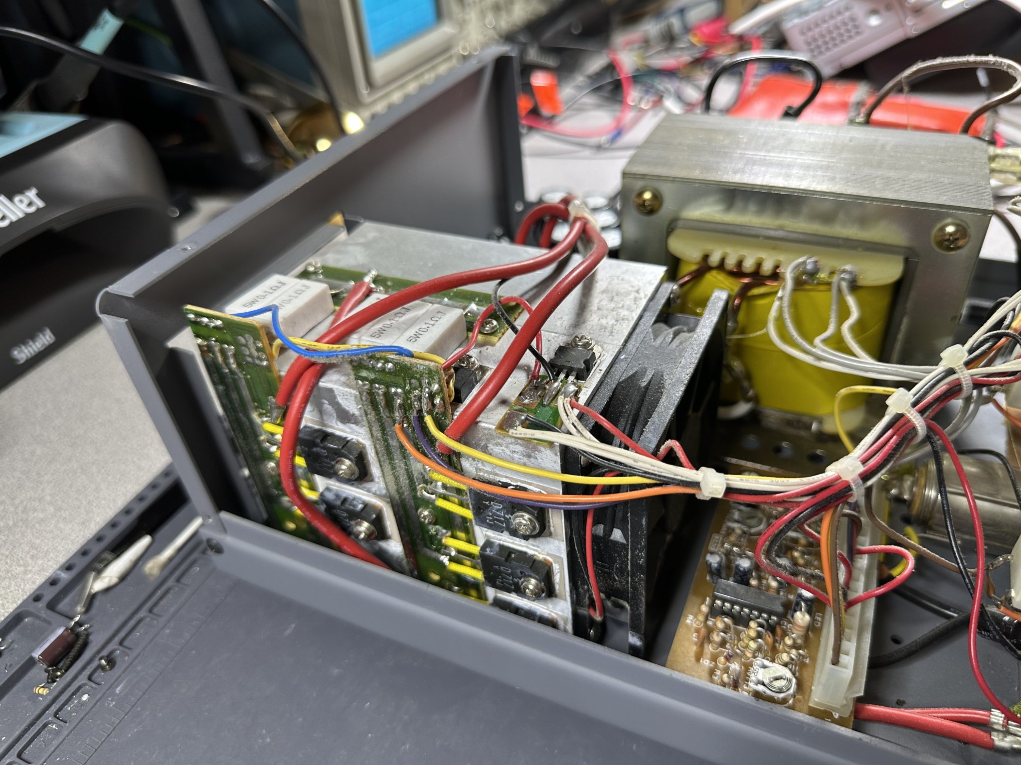

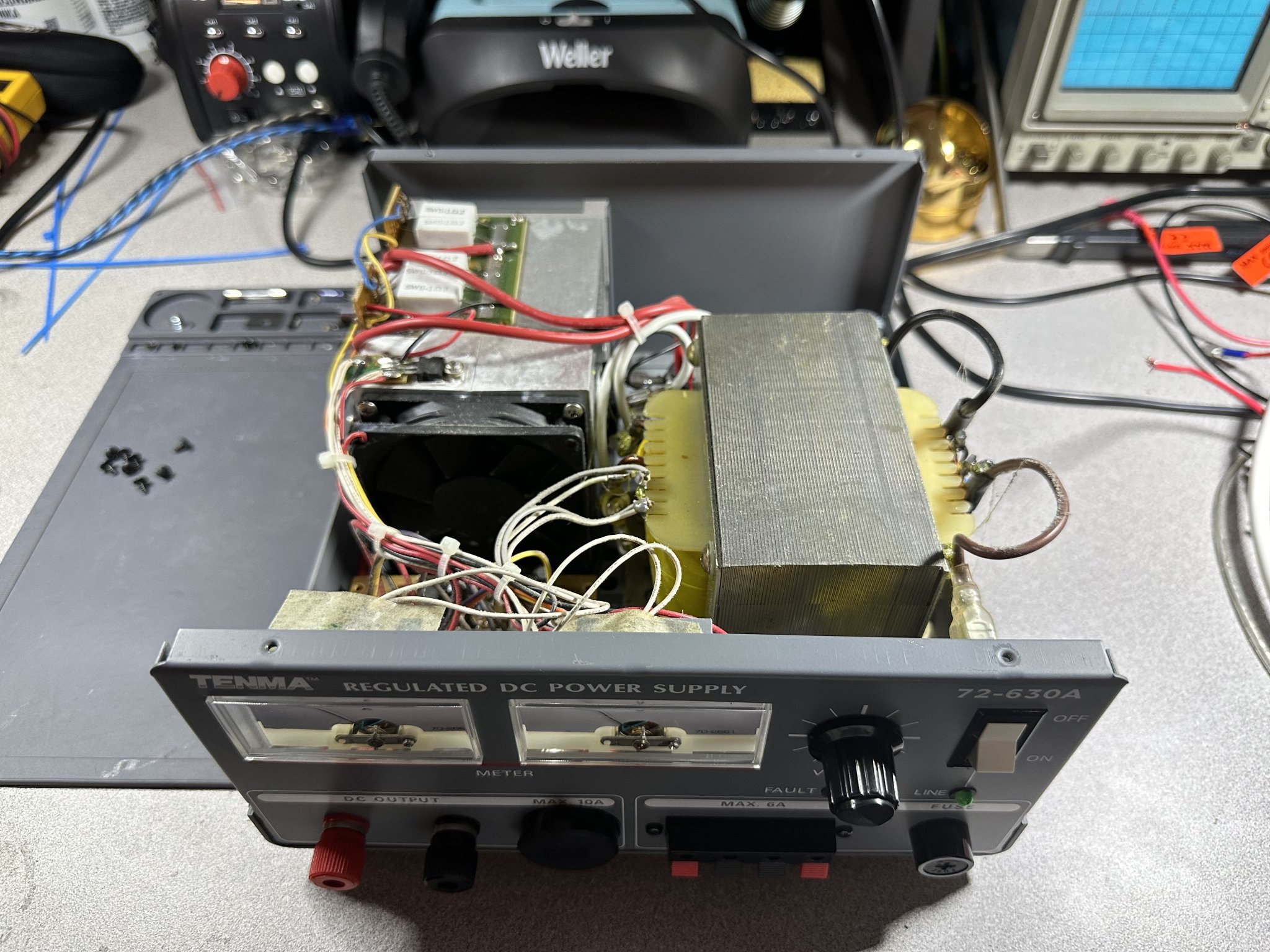

Here are some photos of the internals
I have a feeling one or few of those caps in that bank have leaked (6800uf 28v)
I believe the schematics could be fairly similar to the other supply you linked above but not sure

If I get new capacitors for that bank, should I add the one that is missing or just replace the current ones?

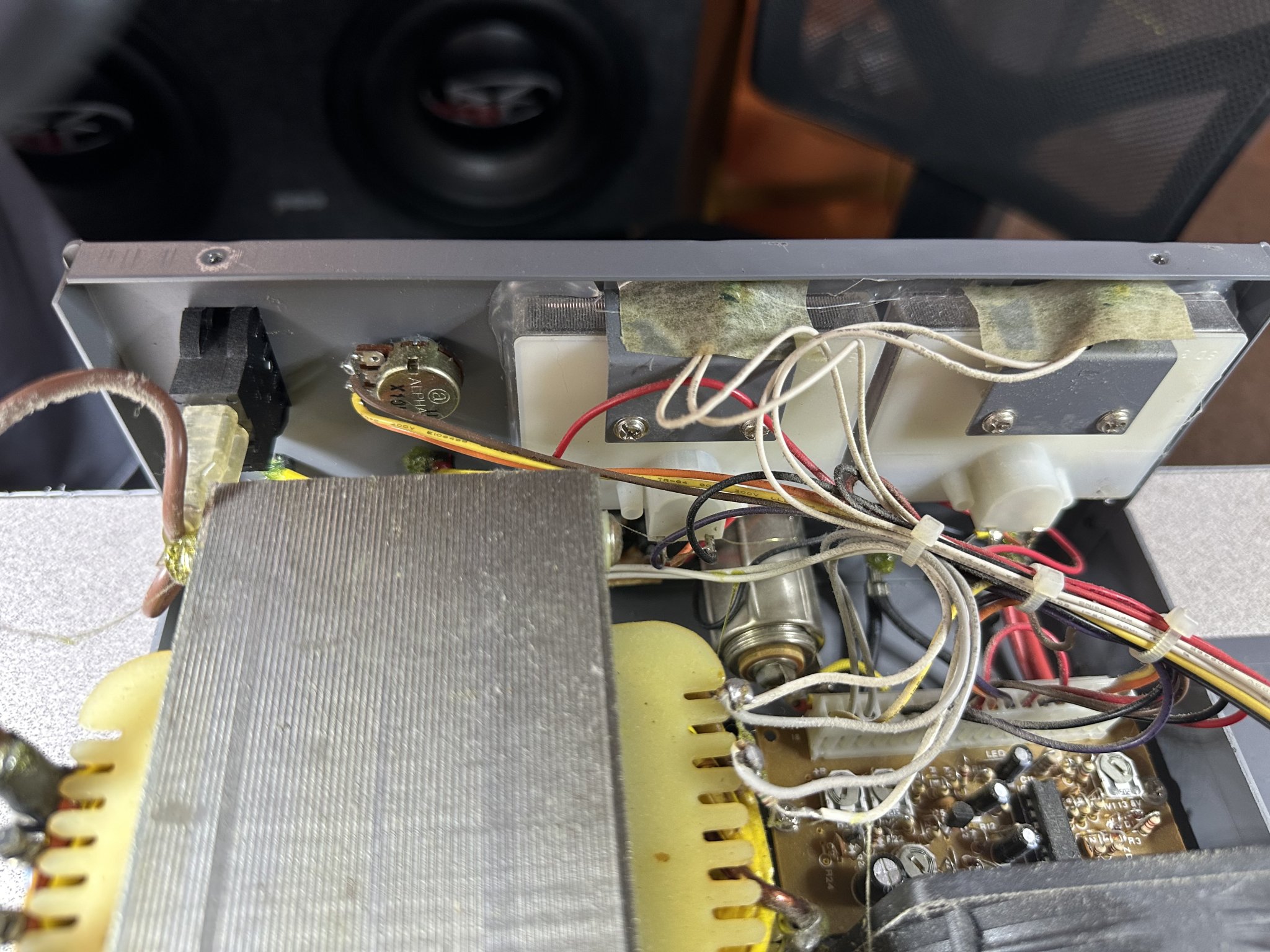

In the schematic of the Tenma 72-630 (link of post #2), there is a trimming potmeter RV1 that's used to set the maximum voltage, which is 15 V for the 72-630.
On the photos of your 72-630A of post #7, there is a trimming potmeter RV1 with a note "RV1 13 8V" right next to it. Are you absolutely sure that your supply isn't by design limited to 13.8 V maximum voltage?
As to why it sometimes only produces 10 V or so, I can't imagine it has anything to do with those smoothing capacitors. I suspect it is a rotten contact somewhere. Dirty V.ADJ potmeter maybe, or a dirty RV1? (The other trimming potmeters have nothing to do with the maximum voltage, at least not in the 72-630.)
If the problem reoccurs, you could try to clean the V.ADJ potmeter and RV1 with a mild contact cleaner. (I write a mild contact cleaner, because some are so aggressive they do more harm than good.)
13.8v isn’t set max, or its been messed with then, as im getting 15.05v with it now
I have deoxit D5, would that be safe to use?

Are you judging the output voltage by measuring with a DMM or are you going by what's indicated on the moving coil meter on the supply? The meter circuit in the supply could be defective.
D5 or FaderLube would be safe to use on the trimpots. Personally I prefer Deoxit FaderLube (F5?) for pots.I have deoxit D5, would that be safe to use?
I'd measure the ripple voltage across the main capacitor bank. If it's reasonably low, especially under load, the capacitors are fine. The smaller electrolytic caps could be suspect, but unless there're signs of leakage I'd probably leave them alone for now.
If you have the service manual, I suggest giving the trimpots a squirt of Deoxit and exercising them a bit. Then recalibrate the supply.
Tom
Meter on the supply and a multimeter. The supply gauge is accurate.Are you judging the output voltage by measuring with a DMM or are you going by what's indicated on the moving coil meter on the supply? The meter circuit in the supply could be defective.
How would I measure ripple voltage on the bank? Just voltage across the red and black wire going to it with multimeter in DCV?
