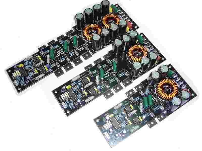

Re: class d
Interesting...
Where can I get more information on these modules?
Have you tested them? How do they sound?
Thanks!
