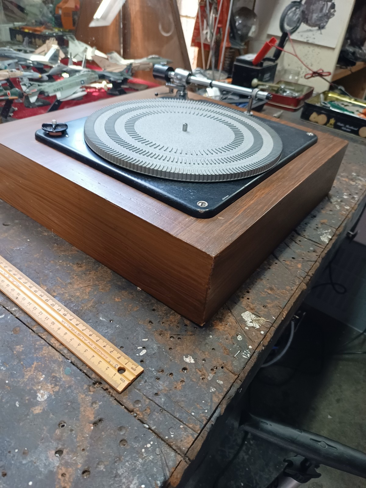

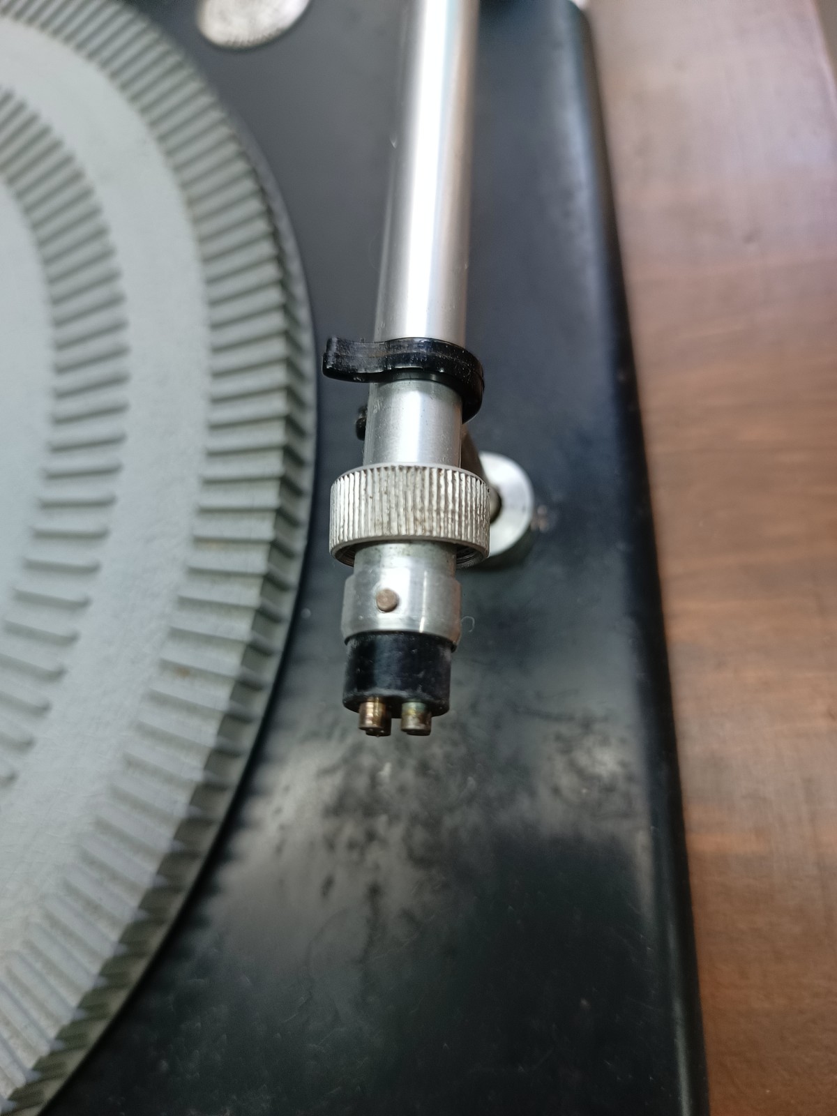

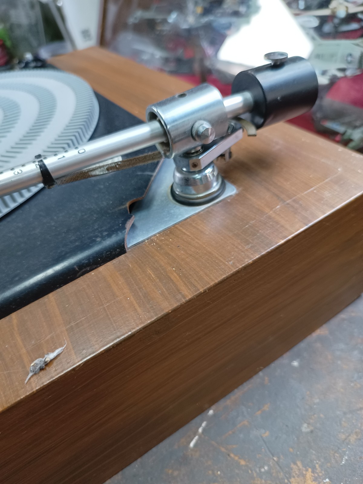

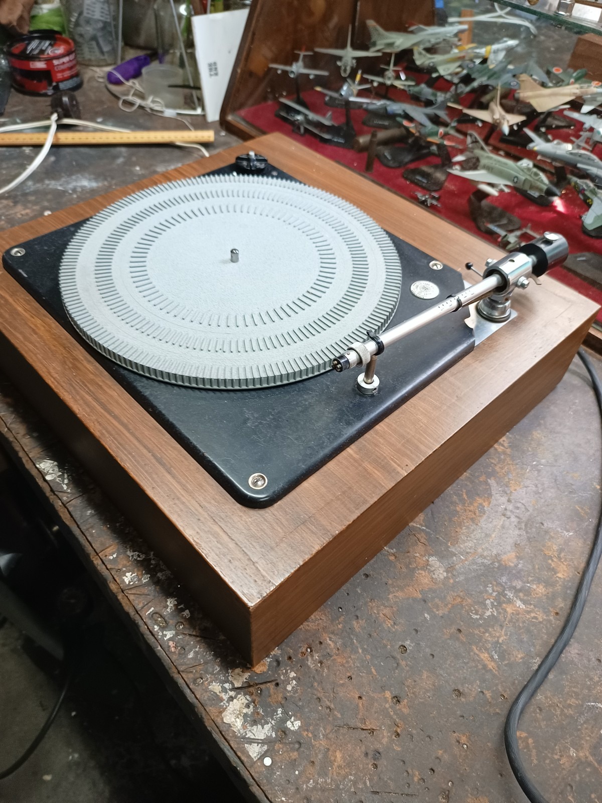

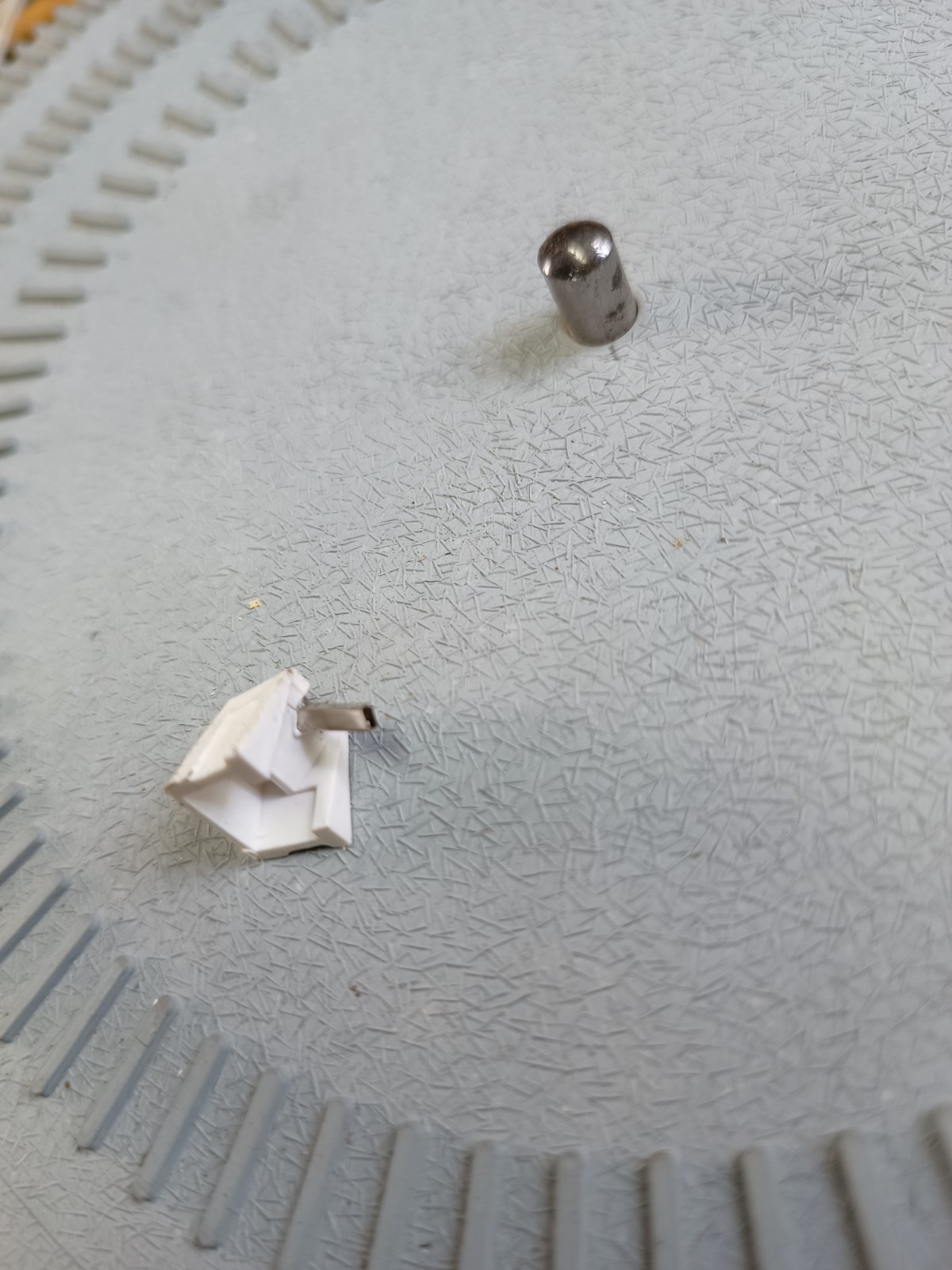

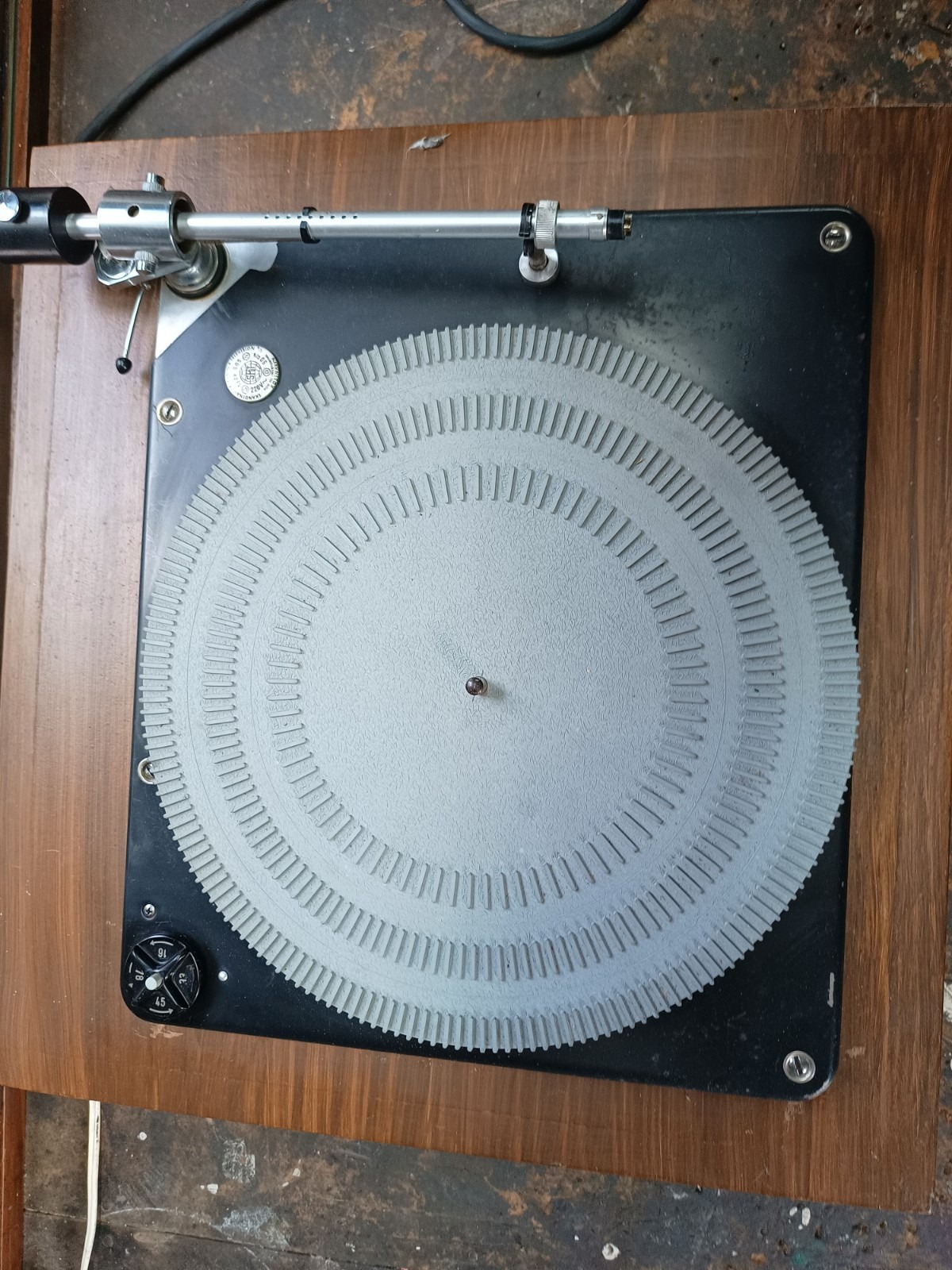

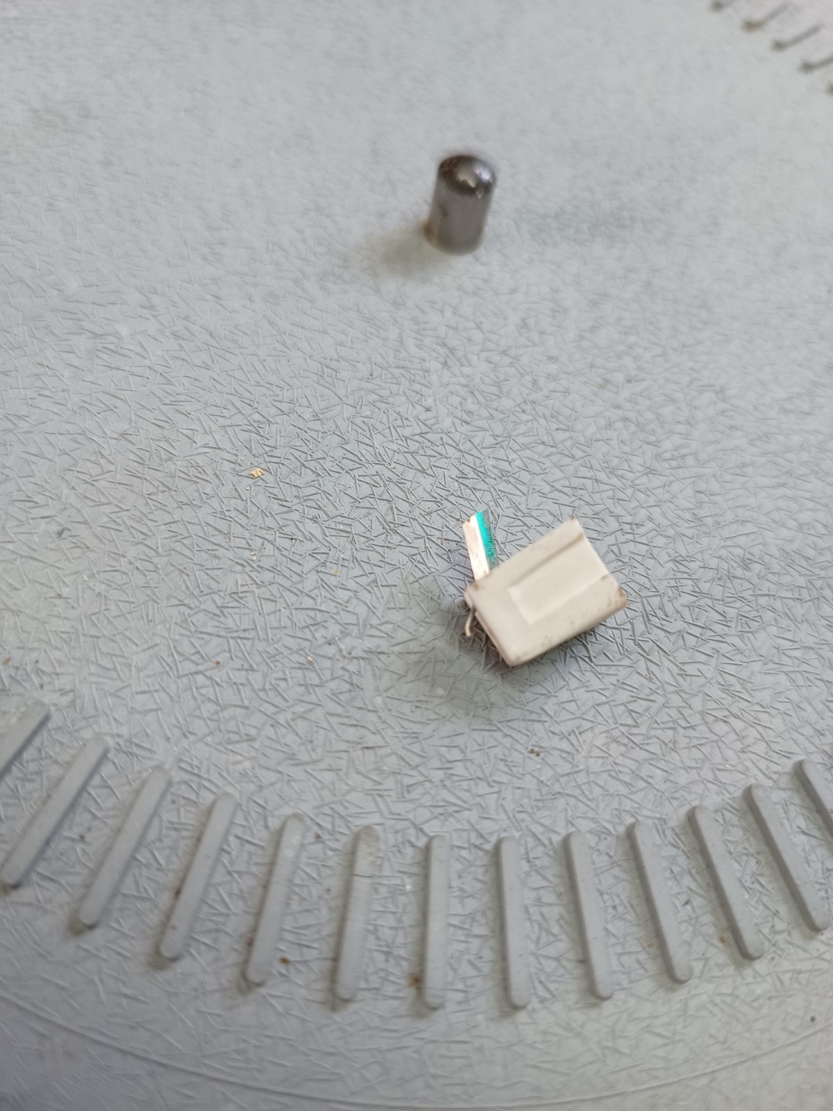

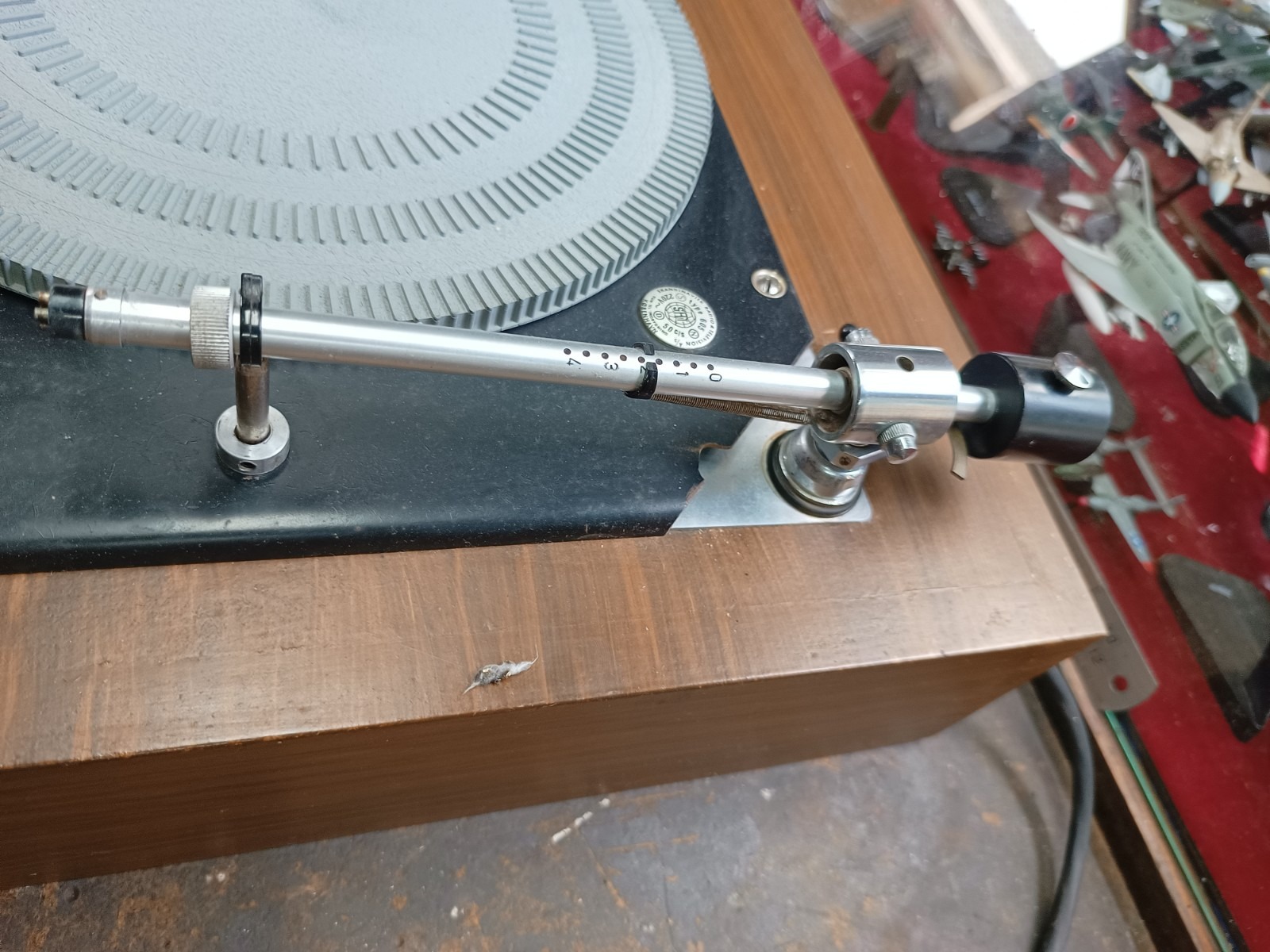

Thanks for the photos, that may be a white stylus assembly I see in the middle image.
The correct description of your turntable is Skandinavisk Radio & Television (SRT) type 605. The otherwise identical Labcraft 605, made by SRT, has a 9" platter rather than the SRT's 12" one.
There are some nice images on US Audio Mart: https://www.usaudiomart.com/details...-radio-amp-television-srt-type-605-turntable/
And there are details on Radio Museum: https://www.radiomuseum.org/r/hismasters_chassis_605.html
The tone arm and pickup cartridge are from B&O and a circuit board underneath houses a preamplifier which allows connection to the auxilliary (aux), or line level, input of an amplifier.
Also, the jack socket output you spoke of appears to be for headphones.
There's lots of mechanics and electronics to fettle - looks like you've got yourself a corker of a project there, Cliff!

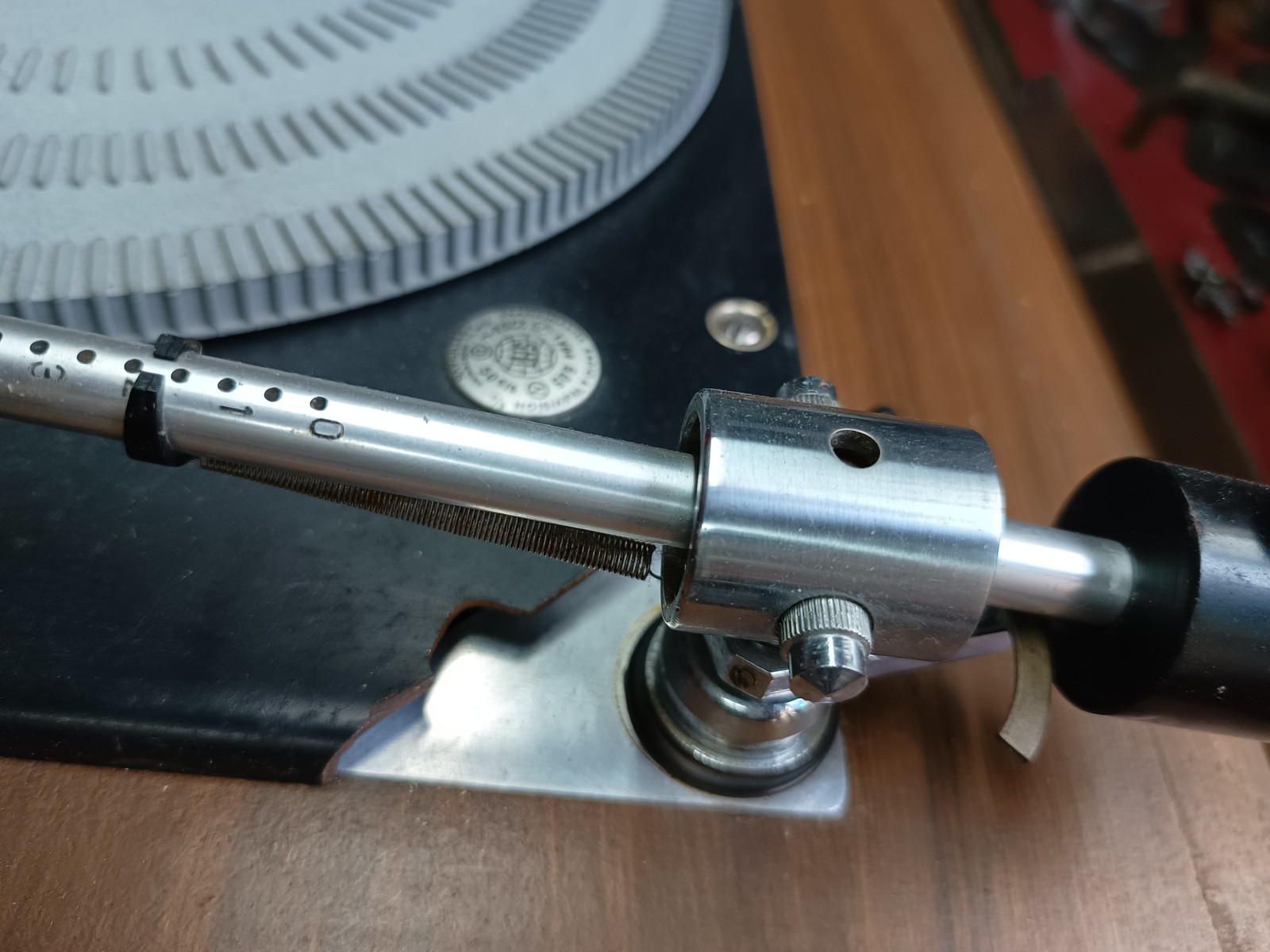

Looking again at your headshell, I see that removing the two retaining screws will release the old cartridge from the metal mounting plate and then you should be able to fit a cartridge like the AT91(R) in its place, but using longer screws. In that case you require three screws of longer length!
The AT91(R) is held in place with 2 screws ½ inch apart on each side of the cartridge. This standard ½ inch mount must surely apply to your headshell.

In terms of the headshell cartridge, I have the original stylus, removed for safety, so will try using this before attempting cartridge upgrade.

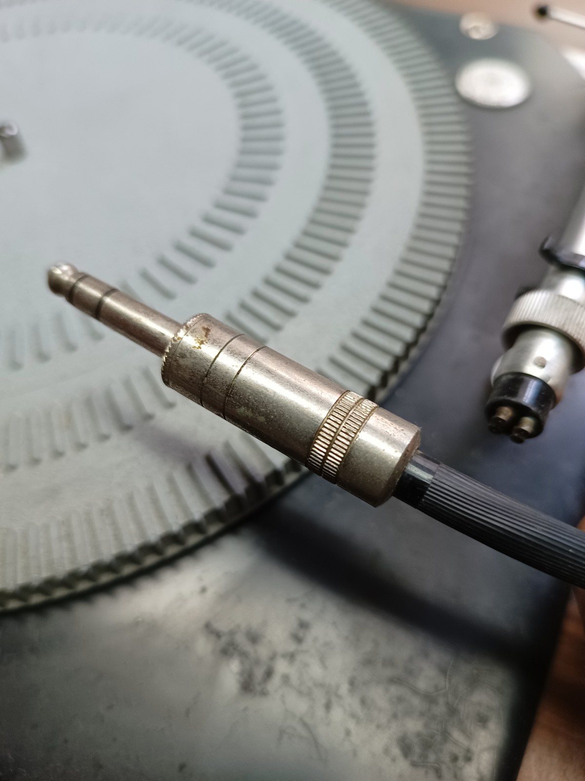

OK, but note that this deck is said to have a headphone output, which I presume is the jack socket.
Does that mean I'll need to be aware of this TT's output volume?OK, but note that this deck is said to have a headphone output, which I presume is the jack socket.
Would this TT's output be better suited to Aux, rather than Phono, or it was their way of removing competition from TT's of other brands?
Certainly keep the volume near minimum till you see what's what.
Doesn't the TT have dedicated cables to connect to the amplifier in addition to having a jack socket? I'd like to see photos showing the jack socket as well as all cables exiting the plinth.
Since there is obvious electronic circuitry in your photograph, I presume it provides a preamp (to enable connection to an aux input rather than a phono input) and/or a headphone amp. I did read there was a preamp during my research.
If using the jack, connect it to aux - or why not simply try plugging in headphones?
Hi Galu.If using the jack, connect it to aux - or why not simply try plugging in headphones?

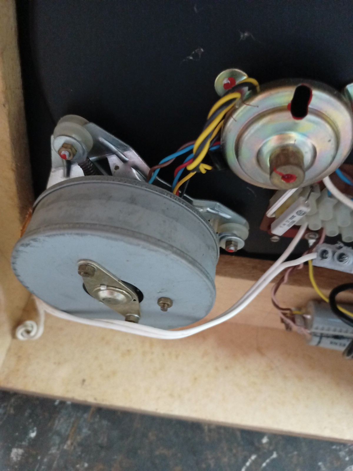

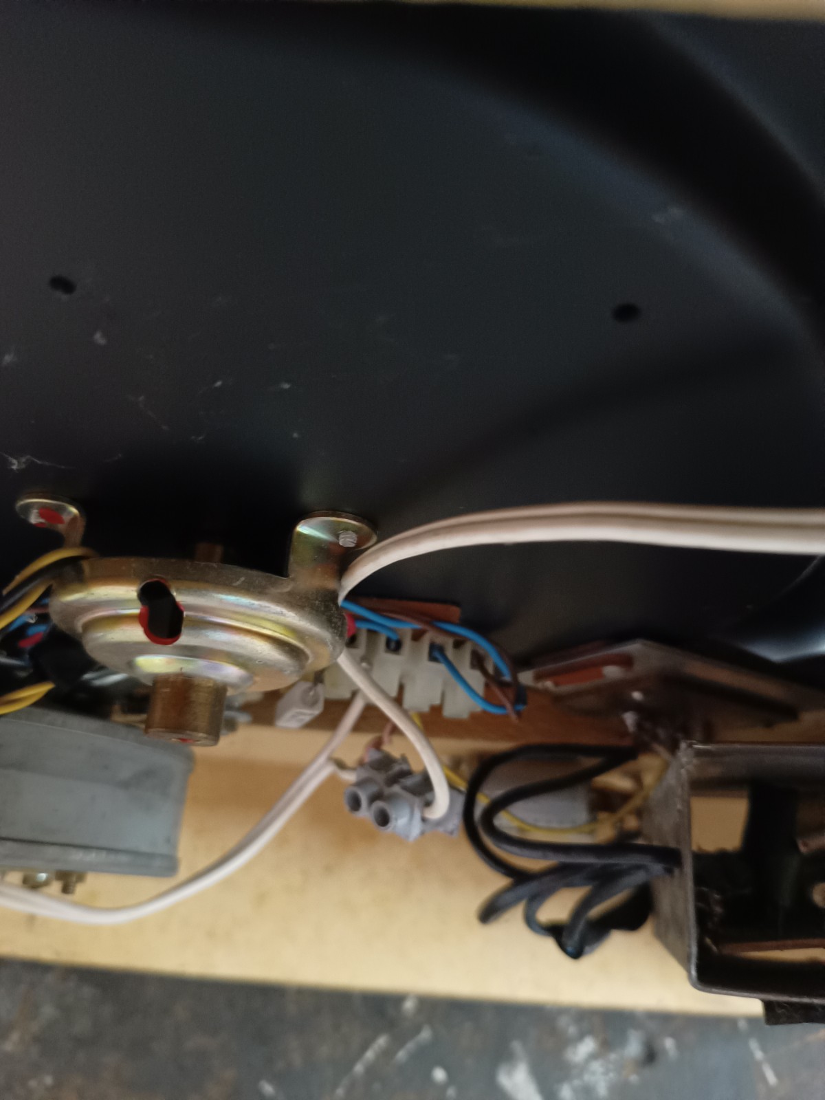

I've examined the plinth carefully but the only cables are the 240v electric cable, & another cable terminating on a headphone style 6.5mm male socket.
If it accepted headphones, wouldn't the fitted socket be female?

I'm hoping the female 6.5mm to 2 RCA cable I'm putting together will allow quick conversion to regular Amp?If using the jack, connect it to aux -

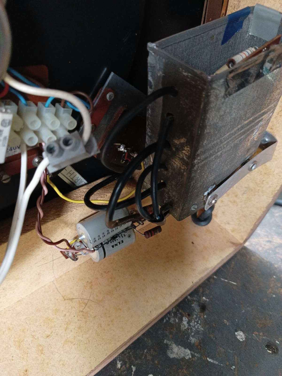

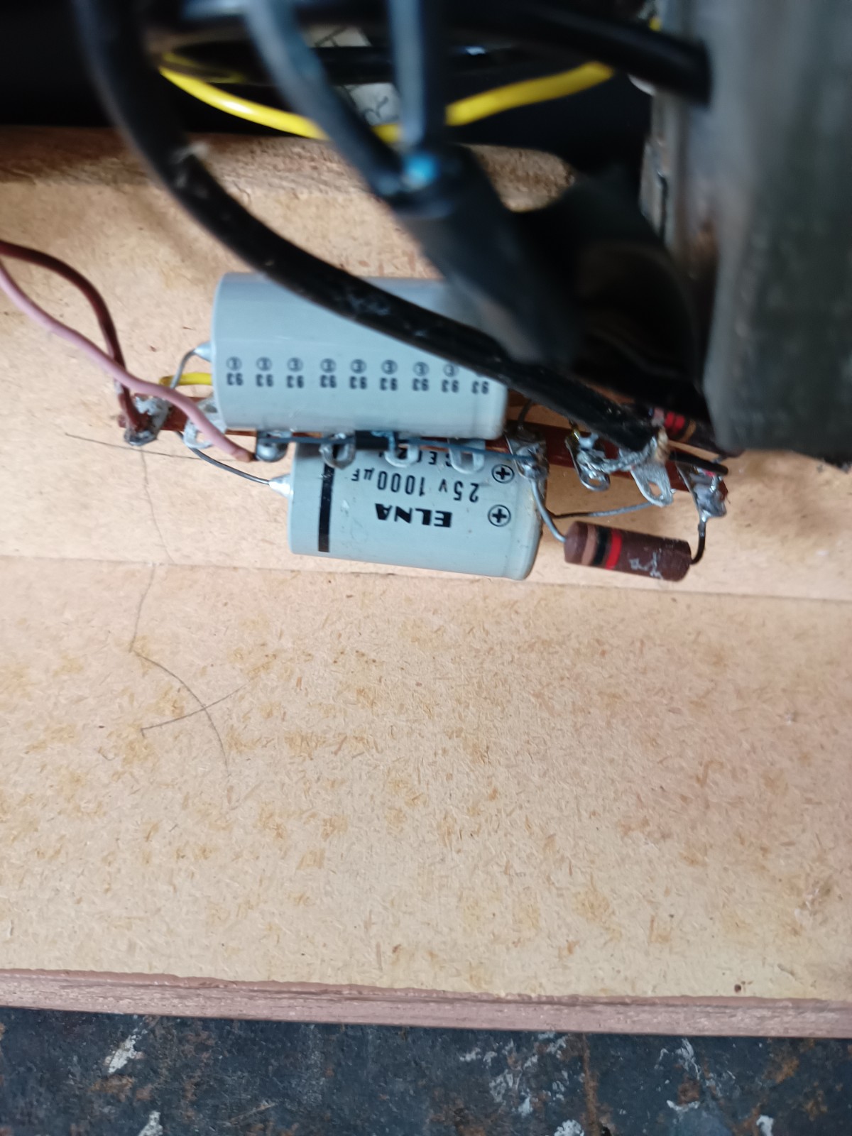

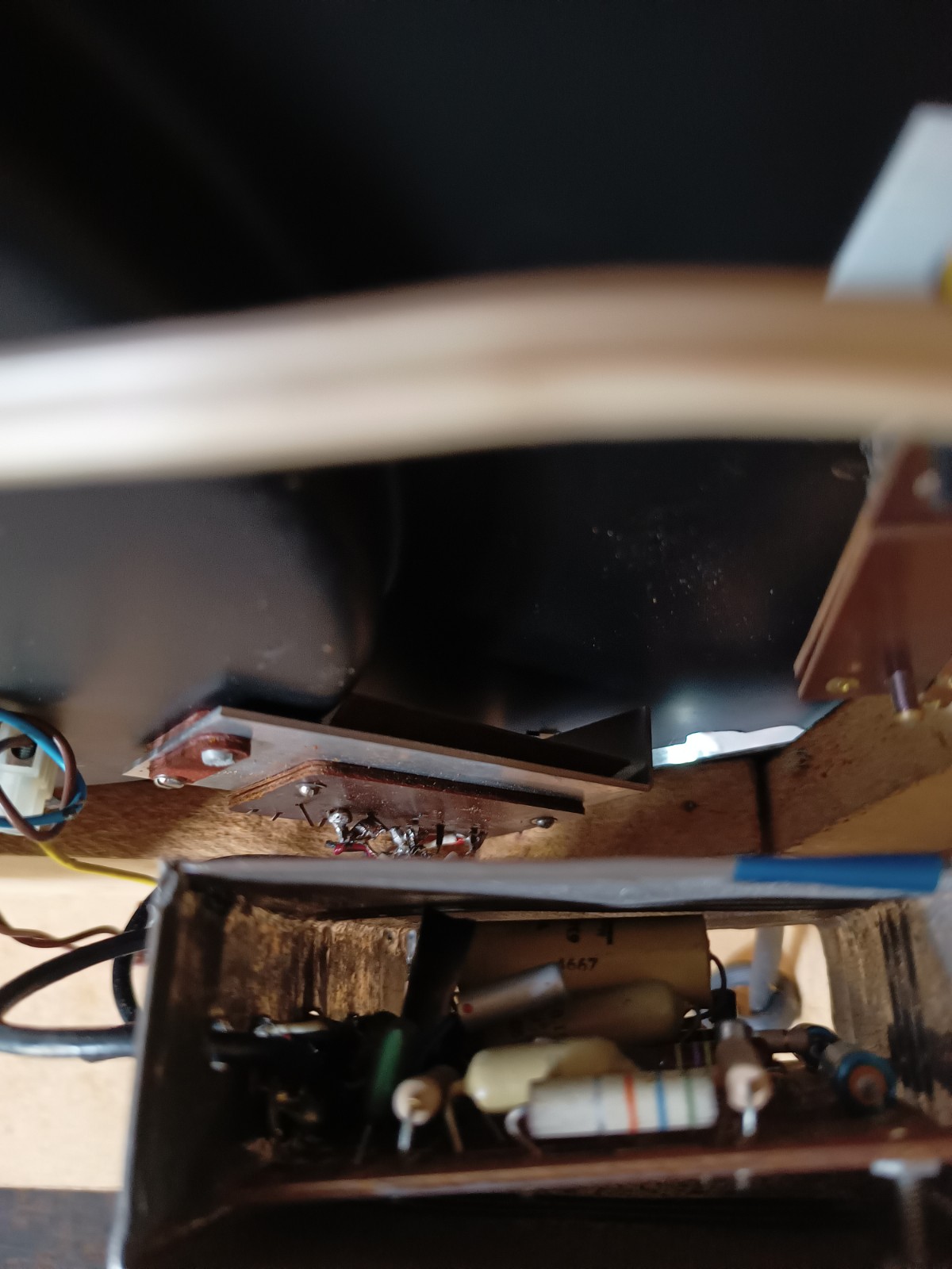

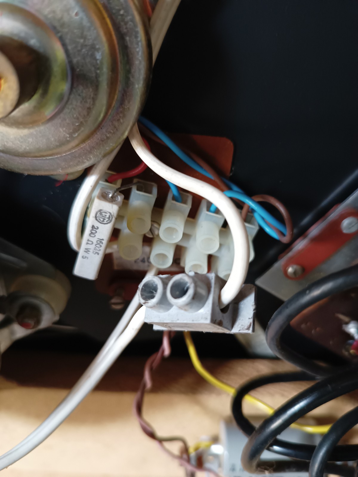

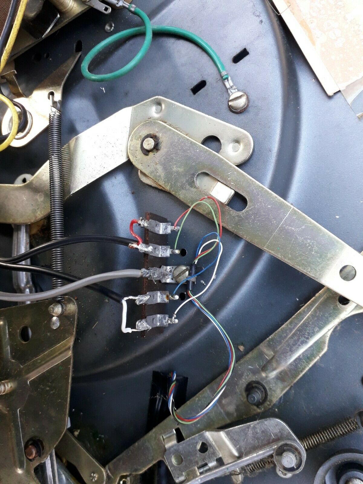

I presume that the wires emerging from the tonearm enter the preamp, and that the jack plug cable exits the preamp.
That particular detail is not visible in your photographs.
There's no telling how the preamp will sound, as the electronics may be in a bit of a state by now.
It may be that you will need to bypass the preamp altogether, so that the cartridge may be connected directly to the phono (MM) input of the amplifier.
A well secured terminal strip and a suitable length of twin screened cable, terminated with stereo RCA plugs, would do the job - similar to the Garrard arrangement shown below.
The two black cables on the left are the right (top) and left (bottom) channel screened cables. The fine wires on the right come from the tonearm/cartridge. The grey wire on the left can be used to connect the metal chassis of the turntable to the ground terminal of the amplifier if hum is found to be present.
Great tip.There's no telling how the preamp will sound, as the electronics may be in a bit of a state by now.
I'll run it as is to gauge its performance first.
Then bypass preamp if needed. 👍

Back to the turntable, would you really want to use the built in preamp when the amplifier amost certainly has a superior one behind its MM inputs?

Regarding TT preamp, I'll tke some photos which trace the signal path to work out from where I divert to direct RCA in order to access MM on Amp. 👍
