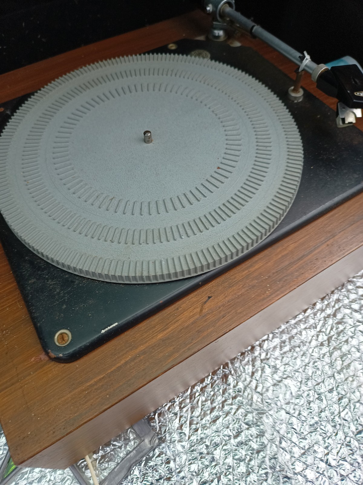

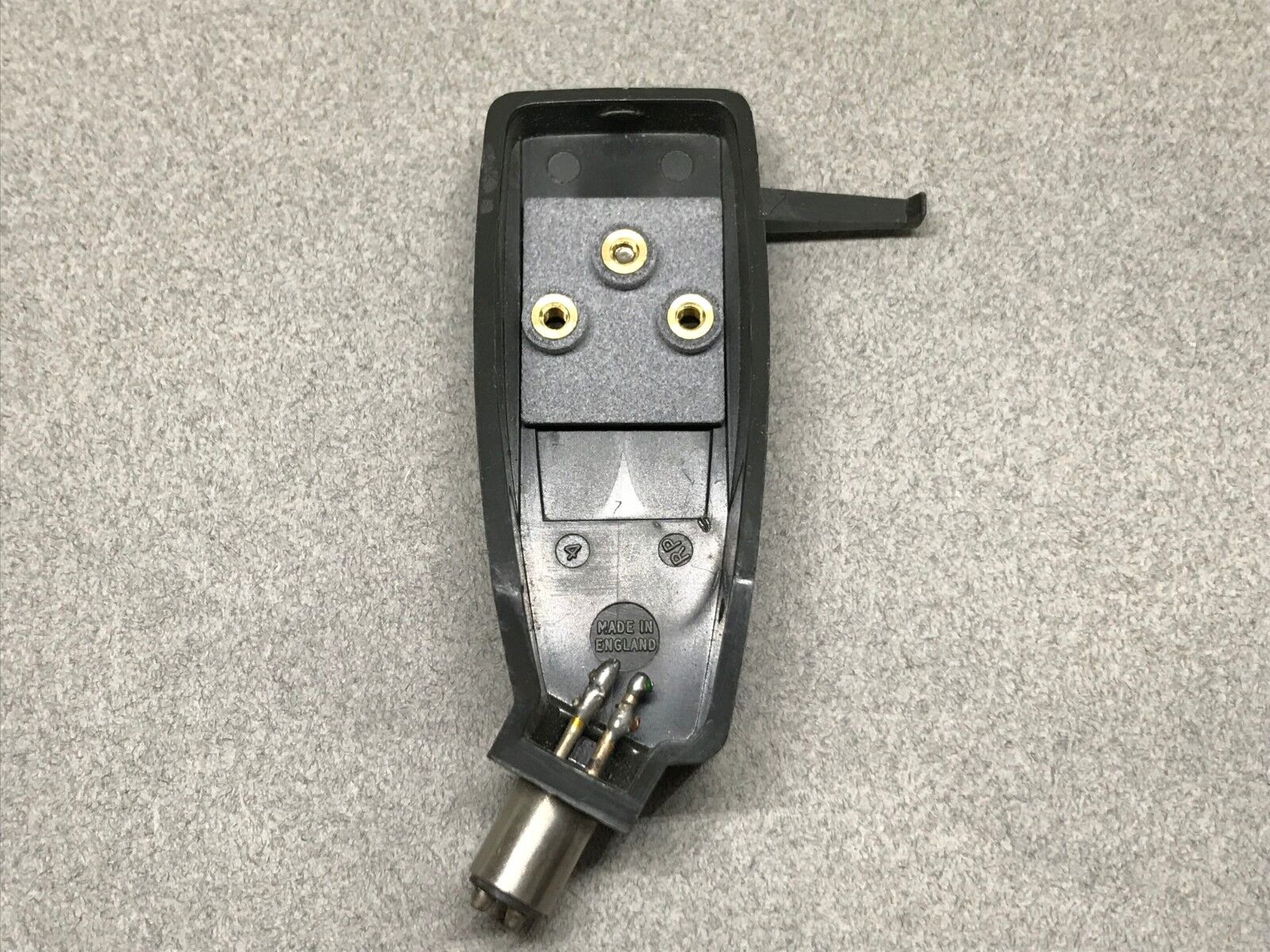

Working on a Lab Craft Type 605 Scandinavian Turntable and noticed the fine screw which holds the Cartridge to the Head is not long enough.
I suspect partial thread stripping in initial part of the cartridge plate.
The Cartridge includes the Markings "2R2 Japan"
The fine screw has under cap thread length of 5mm.
I'd say it needs 7mm-8mm.
What thread size would this be.
Are such screws common or readily available?

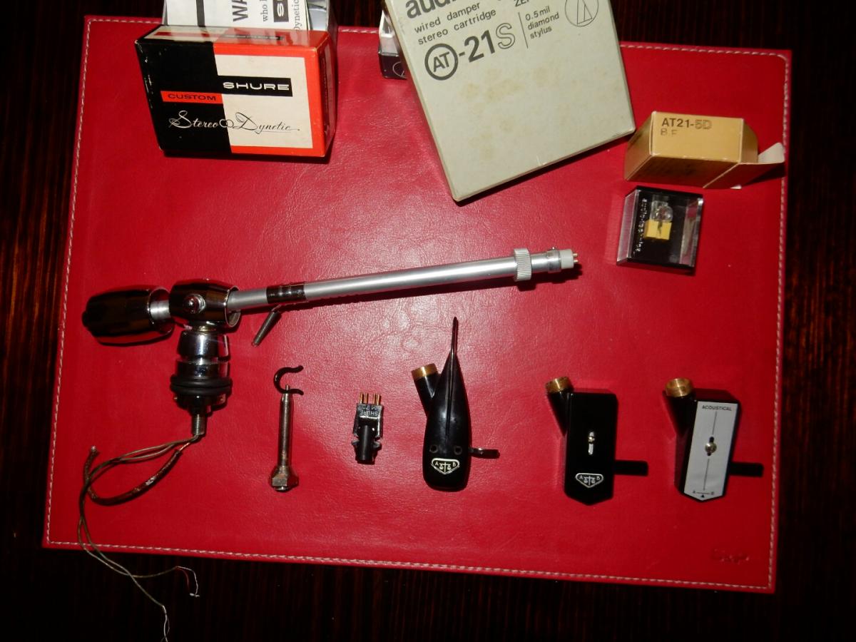

Thanks Galu.My research reveals this to be a B&O headshell, the one in the centre of the group of three headshells in the attached image.

Cliff, it may be a trick of the photograph, but the connectors/solder joints at the rear of the cartridge look to be very close together, so make sure they aren't touching each other. A new set of cartridge connection wires may be a good idea.
Also, I don't see a stylus in your photos, and the cartridge is unknown, so you are probably going to need a new cartridge.
A possible solution to your problem is offered here: https://www.patsaudioparts.com/single-post/2019/04/28/Garrard-Turntable-M7-Headshell-Mounting-Plate
Although intended for use with the Garrard M6/7 headshell, you could probably utilise this US $15 mounting plate (which uses standard M2.5 screws - as described in the link) to mount a new budget cartridge of AT91 mounting style in your headshell. You would have to rotate the mounting plate through 180 degrees compared to the one in the attachment so that the two cartridge fixing points were in in front of the mounting plate fixing point.
P.S. I would be interested in seeing a photo of the actual turntable and pickup arm.

I made a little edit there: the tracking geometry would be optimised by moving the mounting plate (loosen the single fixing screw) fore or aft in the headshell in accordance with the instructions that come with an inexpensive cartridge stylus alignment protractor.

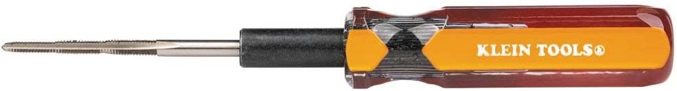

But there is a cure. Triple Tap!
https://www.amazon.com/Triple-10-32-Klein-Tools-625-32/dp/B000MAWKZQ/
Keep pushing and turning until you get a thread you like. 6-32, 8-32, 10-32, all normal 60 degree threads (not 47deg or whatever BA uses).
