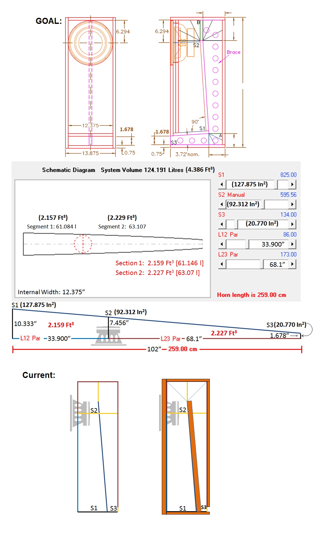

I have been trying to translate tb46's hornresp data into an enclosure but so far am failing miserably.
Can anyone assist? Thanks, Steve

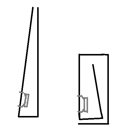

Oh, the TQWT? If it was me, I'd either build it in one tall peice, so it essentially looked exactly like the schematic looks in hornresp, or fold it over once backwards, then loop the mouth back around so it ends under the driver.
Edit: A crude sketch.
Edit2: Driver position should be higher, but, I think that's the general idea.
Thanks, I had thought that's how it would look but was having doubts.
For bass duty [<120 Hz], just folding the long ones in half and either spacing it up for bottom firing or cutting out the terminus [mouth/'vent'] in one or more sides is fine. Also, IME there's more performance advantage to mounting the driver at the extreme closed end ['top'] to maximize boundary gain/negate floor bounce regardless of what a typical sim indicates.

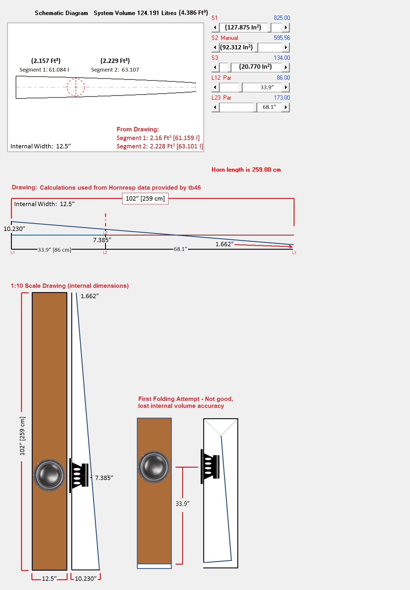

Here are my initial efforts for developing an enclosure for the model provided by tb46 (see attachment). I think the unfolded is pretty accurate, but somehow my calculated volumes did not perfectly match the Hornresp data from which the parameters were taken. Error is probably because I converted to Imperial measurements instead of working in metric. 😱

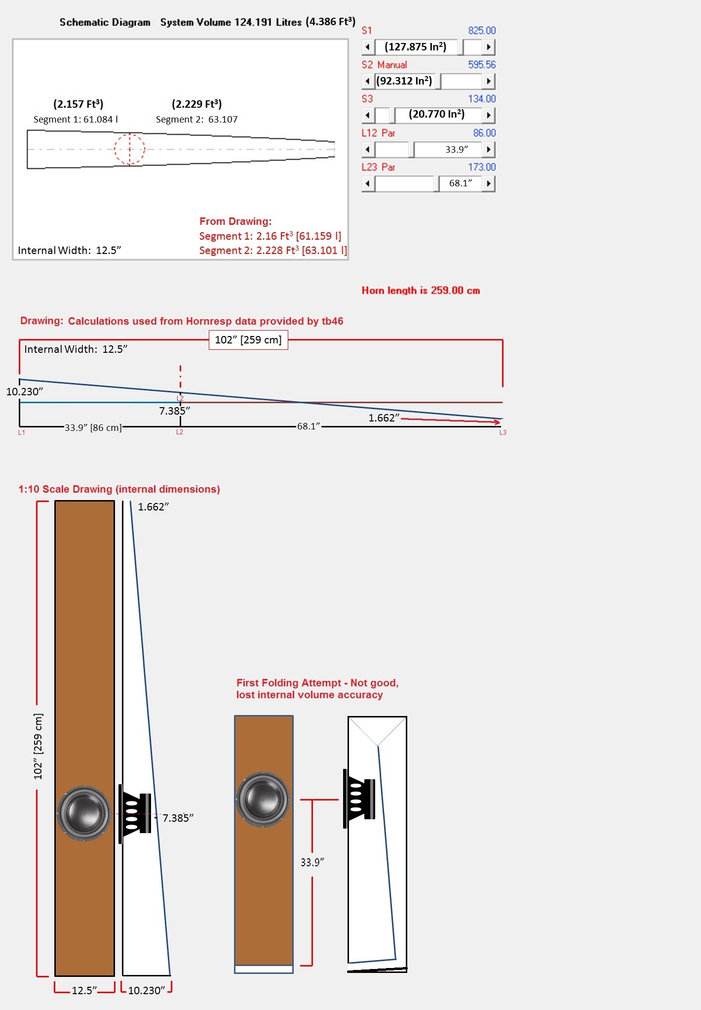

Are the volumes too high? It might be the fold right at the bottom, you'd probably have to manipulate that last turn (bottom back) to keep the taper even.
Edit: Something like meow.
Yes, with folding I gained to much volume. Its a tall bugger at 102" but with proper folding it should be quite manageable. All I can say is folding is hard (at least for me).

Single fold = 51". Double fold = 25.5".
I'm not smart enough to figure out a single fold, let alone double fold.😕
Attached is my latest stab (only took about 6 hours).
I have the L12 and L23 lengths correct, not positive about the volume. However, I can not figure out how to make the L23 fold twice to reach the front of the enclosure (based on Oliver's drawing from the link of page 14).
Hopefully one of the pros will jump in and assist with the folding.
Aaargh, spent way to long today on this and still cannot get it how I want it.
Aaargh, spent way to long today on this and still cannot get it how I want it.It's driving me nuts (well nuttier, my wife already thinks I'm nuts).
Hah, yeah, I tried to fold one once, I'm sure there's some tricks to it that once you learn make it easier.
One of these days, maybe Oliver will make a youtube video in fast-motion of how he does it with AutoCAD 🙂
I use (or more correctly try to use) PowerPoint and Paint. Not the best tools for the job! It does seem to be a black art.
