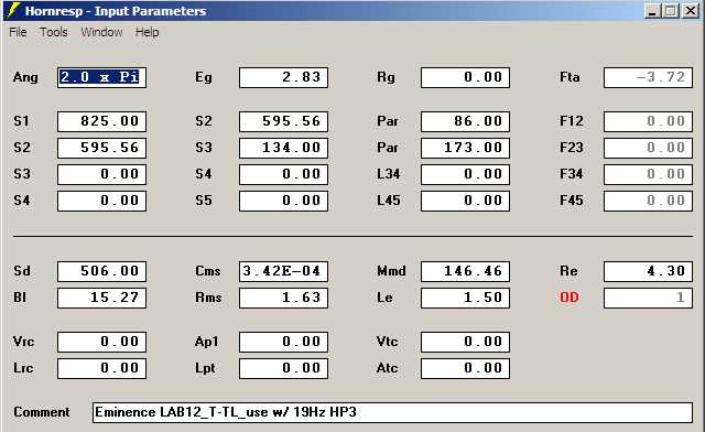

I went to the linked thread and played around with Hornresp. I ended up with fairly decent SPL profile down to 19Hz before the rolloff, but the enclosure was huge. I am so not good at Hornresp.

For this type of TL you don't even need 3 sections in Hornresp, give it a try with OD and 2 sections, in the Wizard set S2 to Auto, that way you reduce the number of variables.

LOL, that's a heck of a bomb to drop, it looks like the response is nearly the same!

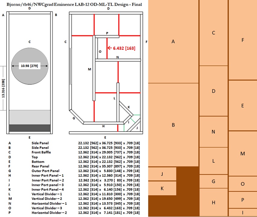

I've decided that I'm just going to build the "proper pair" with mdf again because it's cheap and I keep going through and trying different designs, so there's no telling how long I'll have them. They're about 80% completed right now, I just have to finish working on the S3-S4 angled pieces (that are giving me grief, my old saw just doesn't cut like it used to!).
Before I button it up this afternoon, I do have one remaining question. From the worksheet posted by bjorno, it appears that the S1-S2 stuffing should be fairly thick and S3 should be thinner. I'd like to make sure that I have the stuffing perfect before I PLP the side on, can anyone confirm the appropriate stuffing amount? I'm planning on using a roll of fiberglass insulation because I have it handy already.

The OD-ML-TL, my usage of proper pair was a contrast to the hastily assembled test version I did with a single driver just to see what the performance would be like.
That TQWT Oliver posted, which I believe to be along the lines of what you were talking about, is probably next on my project list, but I'll fire up a build thread if I do a couple of those.

NWCgrad's OD_MLTL? Your link justs goes to the top of the page............ http://www.diyaudio.com/forums/atta...gn-bj-b-t-n-lab-12-od-ml-tl-final_f3-21hz.jpg

Sorry, it was meant to go to the post where I uploaded a picture of the one I built, it was a quick-ish assembly with extra glue and uglyness that I really did just to see how the OD-ML-TL would sound.
I've spent the last couple of days off and on putting together a pair of them with a lot more care. I have one finished and the second one just needs to have the driver opening routed and the last side glued on.

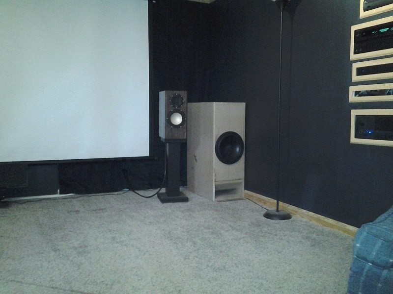

Here's the one that's done. (No finish work yet.) The other one is coming later today!
It does look ready for business, can't wait to hear impressions of two of them. I am leaning towards using mine in a 2 channel music only system and going with a few 18" subs for HT. But everything is subject to change. Still have a few more months before I can start cutting plywood.

I finished the second one yesterday and spent a little time listening to the pair of them. I'm going to have to have the placement dance, I think I'm going to end up with a lower LPF and subs toward the back of the room again, they sound a little anemic when they're up front like that. Plenty of wall-breathing down really low, but hardly any visceral "kick".
My girlfriend actually commented that she was "spoiled" on the tapped horns and wasn't very impressed..I'm going to blame 75% of it on placement.
Once I find a spot where I can get a little hair-raising out of em, I'll try some real full-power testing. To me, they have a lot of potential to be very musical and "vanishing act" type subs, but I might have to augment them with another giant tapped horn just to have something that'll suck the breath out of you for HT and for when the girl feels like dancing 😛
