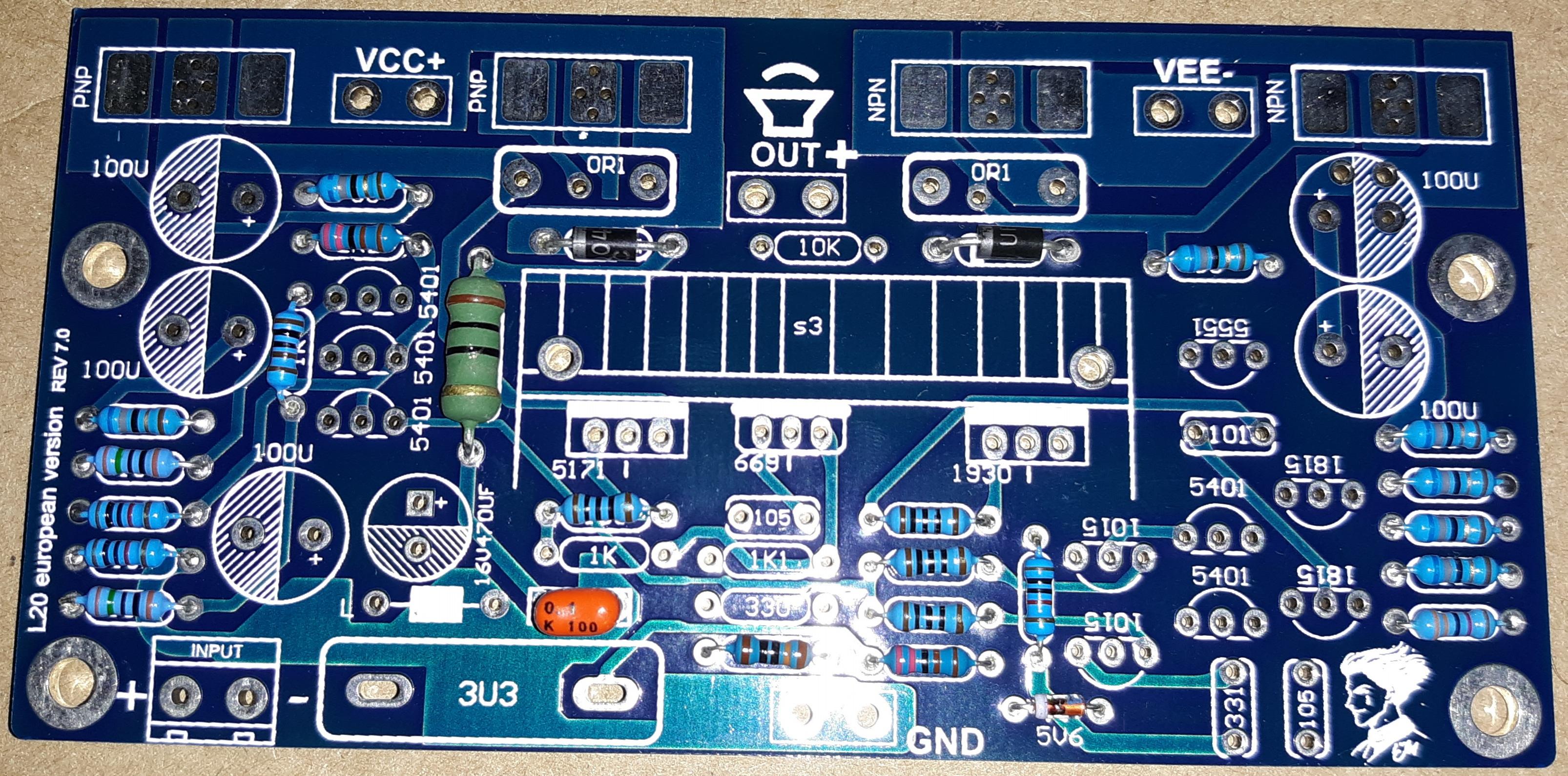

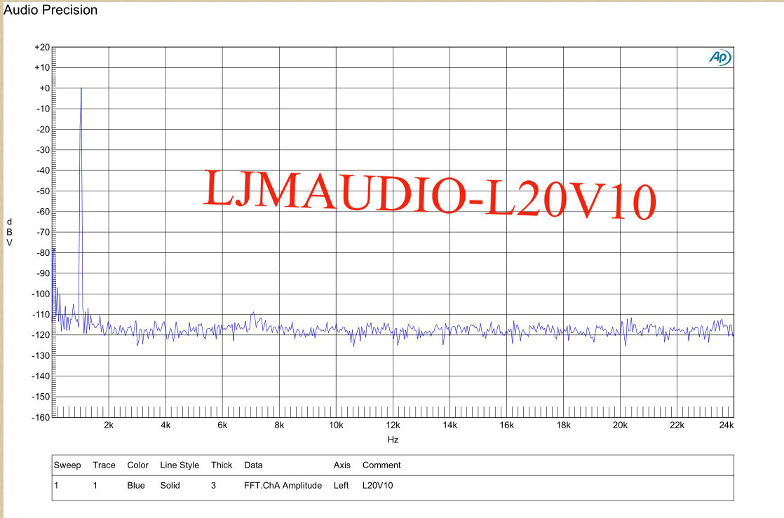

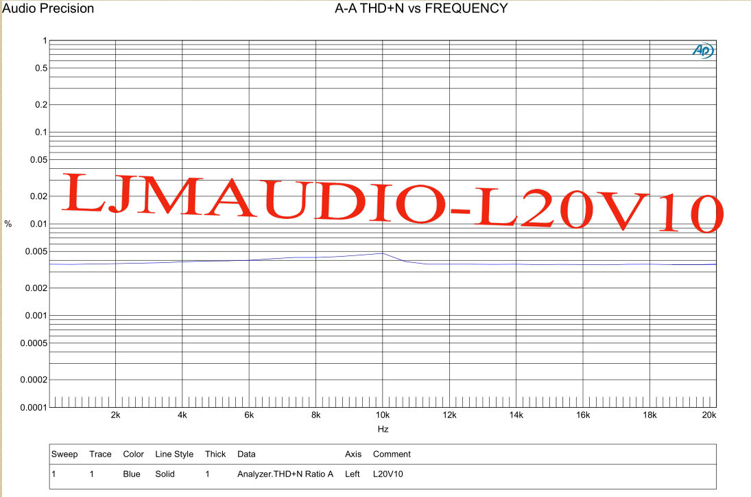

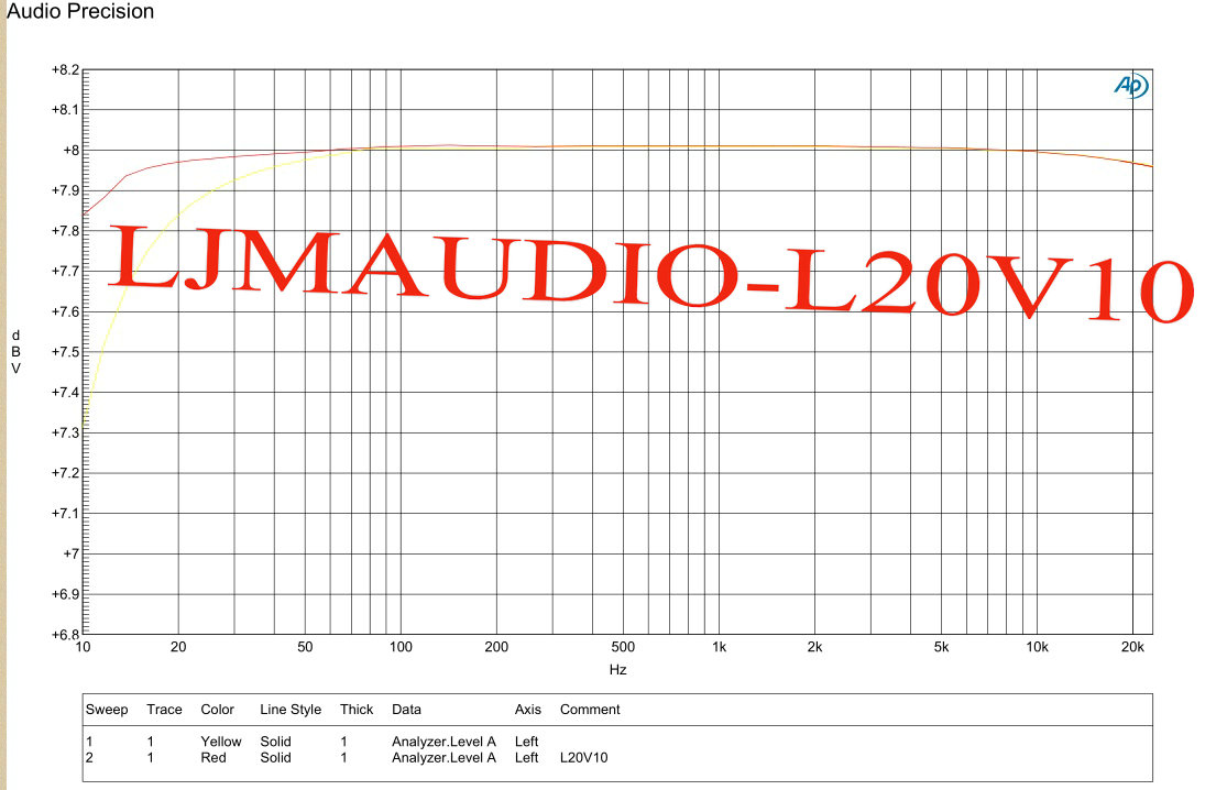

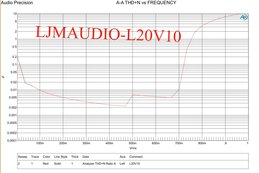

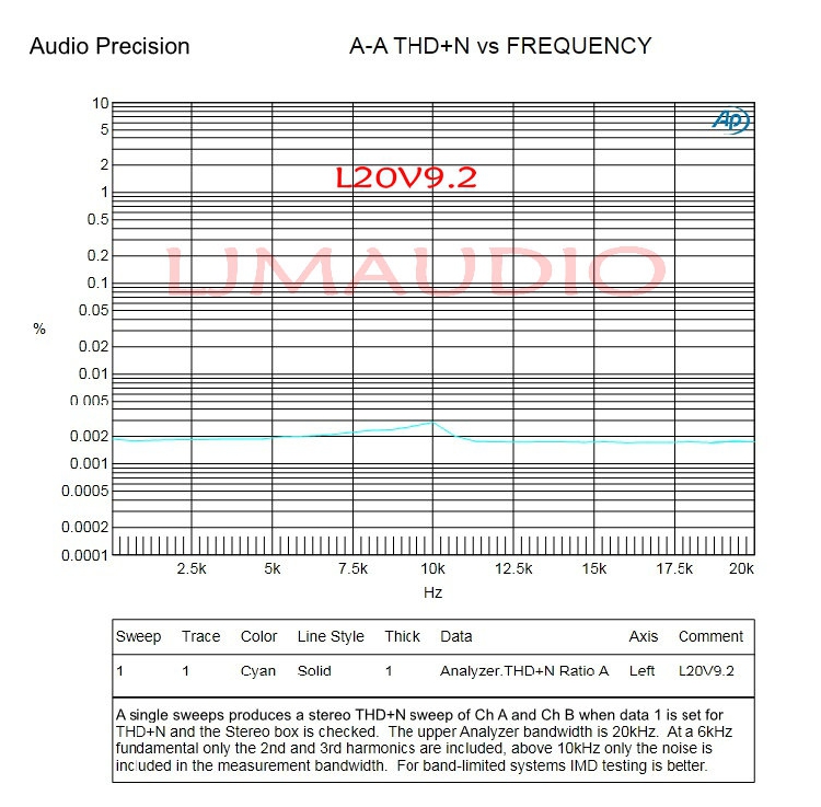

I am also going to respond to a chart showing low distortion posted today by designer LJM.
The chart is very interesting but after 55 years of, seeing , measuring and producing such items myself for various and sometimes obvious reasons. I must comment that they are really only usefull to me if they accompany a reason for such measurements. Ie Their is a noted sonic reason for the measurement. This should then be explained in the text. .
I point this out because there are quite a few of these various boards available worldwide and the measurements are meaningless unless you know the
quality of other factors.
Manufacturers of components and chips in particular often quote figures using laboratory isolated power supplies to get best results. These results vary wildly when used with rouge noisey supplies but I am not saying that this produces a worse result. just different and sometimes these colorations satisfy the consumers need. Hell , how many tube lovers would like the results of their microfonic tubes and micro temp changing compononts really published. Again it may be meaningless and will only satisfy the acadamic type cheerleaders I suspect.
In line with my histroric (slow) method on analysing componont changes in a methodic and simplistic way, I continued modifications to this excellent board especially trying to erradicate some sonic vageries.
Whilst I am still not totally sure of how each individual part sonically impinges on this circuit IT is now fairly obvious that the ElCaps supplied in the kits are of similair low quality sonically to the resistors fitted.
These produce IMO poor metalic dullish and grainy sonics including some ringing .. Even after longish run ins.
My favourite Silmics are difficult to fit as replacements on this smallish board and Panosonics (slimline 100v) seem to produce a solid not weedy sound.(hint)
I am almost finished upgrading most of the resistors to Vishay bulk foils. Yes this is now becoming an expensive board but possibly equaling and eventually beating any amplifier costing many many times more.
It is quite surprising where these replacements have created implovements.Not that I havent done this many times before. Even on early weaker LJM designs.
Sadly I will again have to wrap up development soon on this kit due to family issues and the need for a holiday.?

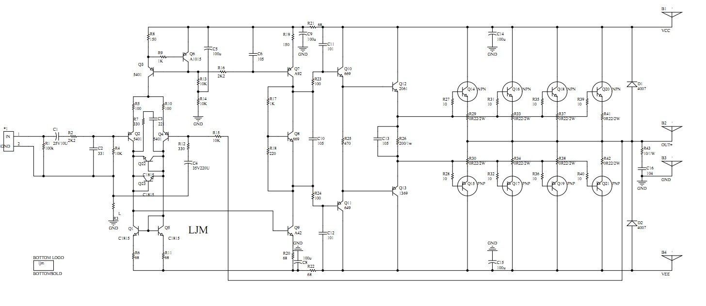

I have been considering the large ceramic 1 watt 10R resistor next.
On a previous amplifier design I by-passed the equivelant 2 watt version type Caddocks with a Vishay bulk foil to some small effect.
Note on this board I have slightly lifted the resistor from the board for improved heat potential.
I also noted somewhere in an earlier thread that it is possible that this output design might benefit from this being lower ??? than the 10R.
The only original elcap to replace is the 1000uf 10 volt.
Anyone got opinions on this part of the circuit ???

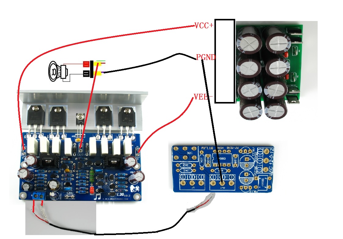

I have an Lm20 V9 amplifier and today I connected it according to http://www.diyaudio.com/forums/attachments/solid-state/406197d1394980052-l20-v8-l20-jpg The difference to the previous working setup was leaving GND board terminal unconnected as in picture. Now the board is dead. Previously I had GNG terminal connected both to speaker and GND of power supply and it worked. Any suggestion what might be broken?

L20V9.2 is very stable. But it still makes me feel unsatisfied.
I made another version. But maybe they have different styles. Nor can it be a substitute.
VER10
It can only be a different style version. I'm not sure it will be better.
But I think it should be made. Because it has another sound that L20V9.2 does not have.
Its voice will be slower and its bass will be better.

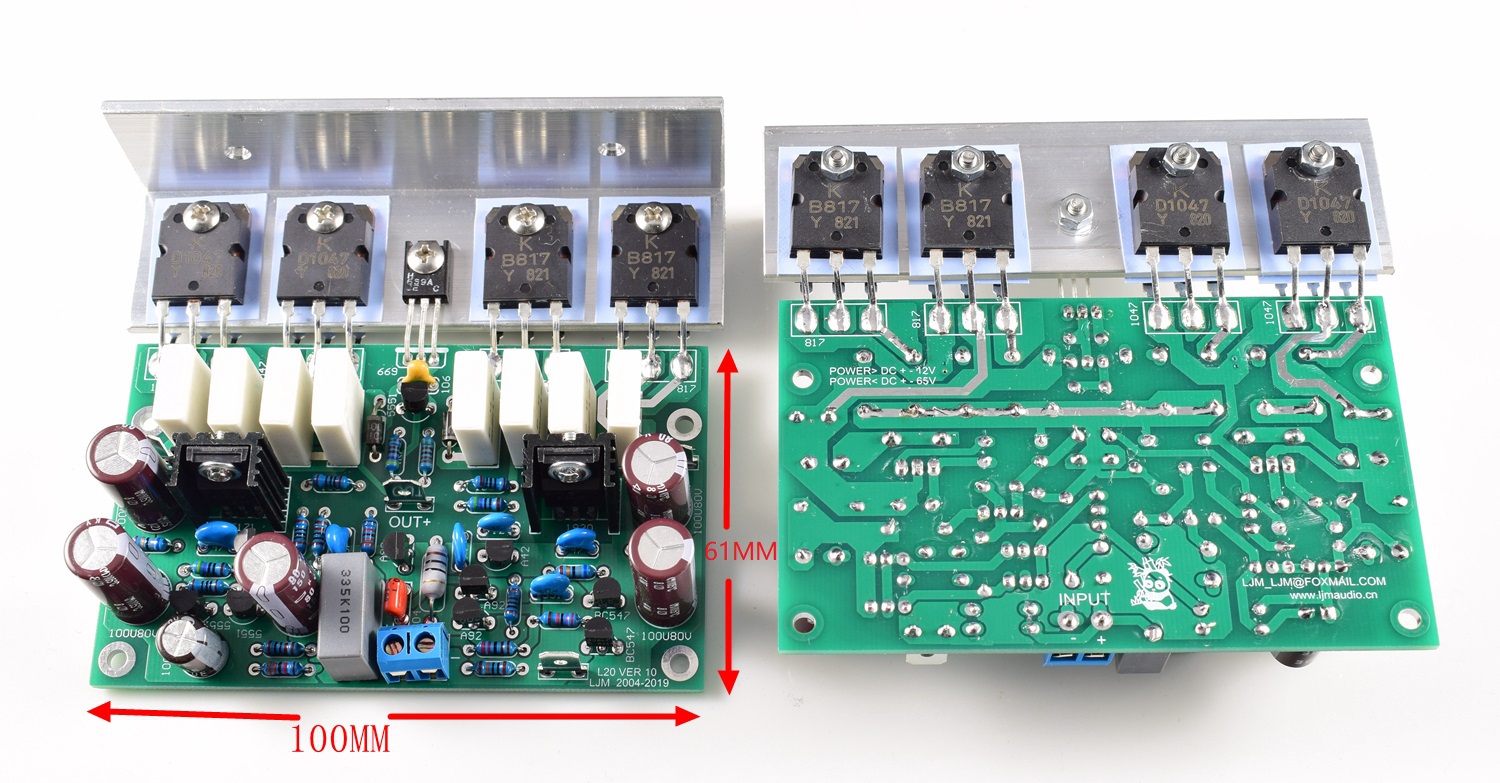

The main changes are as follows.
The output is changed from 3 to 2. This reduces the phase distortion and makes it more stable.
The input impedance increases. 27K input impedance allows us to use MKP 3.3 UF capacitors. And the low frequency did not decrease. 20HZ-0.15 DB
Use slower transistors. A42 A92. (But complex compensation capacitors are needed)
Used to reduce the feedback depth of the amplifier.
Distortion increased slightly. 0.004% THD+N
But it's still very low.
It can make the voice feel warmer.

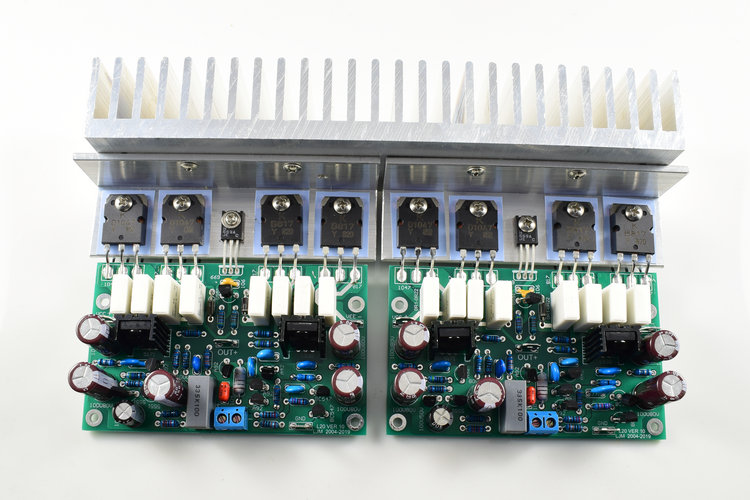

Also in his last posting he confusingly states new board has reduced drivers from 3 to 2?
The latest pictures still show 8. Obvious difference is central location on board for signal inputs.

I just started to assemble my L20 V7 kit (see attached photo) however I just noticed that there is only one pair of 0.1 Ohm resistors for 8 output devices. For other L20 versions I noticed that there is the more expected four pairs of emitter resistors for the four pairs of output transistors.
I am concerned that the amplifier will fail/burn the output transistors without the emitter resistors. I noticed that the L20.5 also has eight resistors, one per output transistor.
What should I do? I am putting together this L20 V7 since the MX50x2 and MX50SE can't handle the transformer in the chassis I am using. I don't want this one to also blow the output transistors.
I also noticed that the schematic I found for V7 shows 8 resistors while the boards only have 2 resistors. (Also attached.) The schematic is obviously wrong and not for this output stage design.
