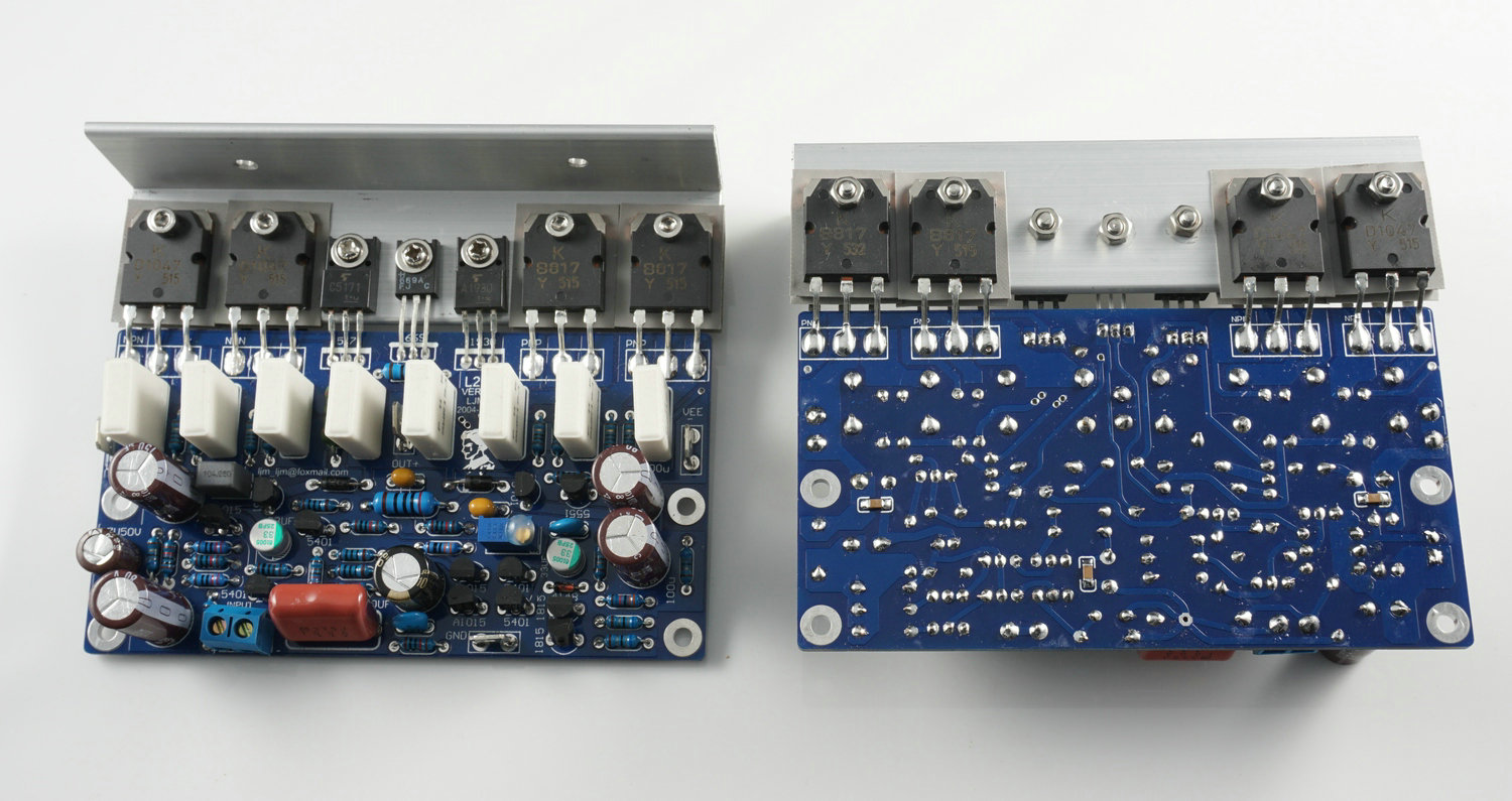

Analog amplifier - Acquista a poco prezzo Analog amplifier dai Fornitori Analog amplifier Cinesi a LJM AUDIO DIY su Aliexpress.com

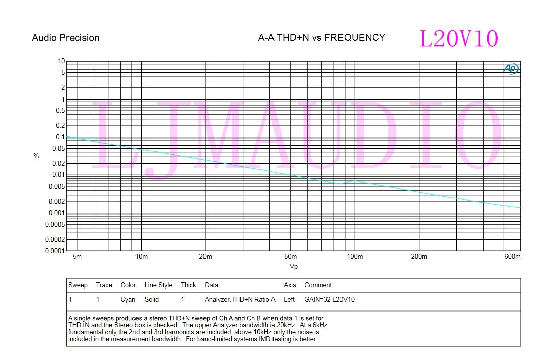

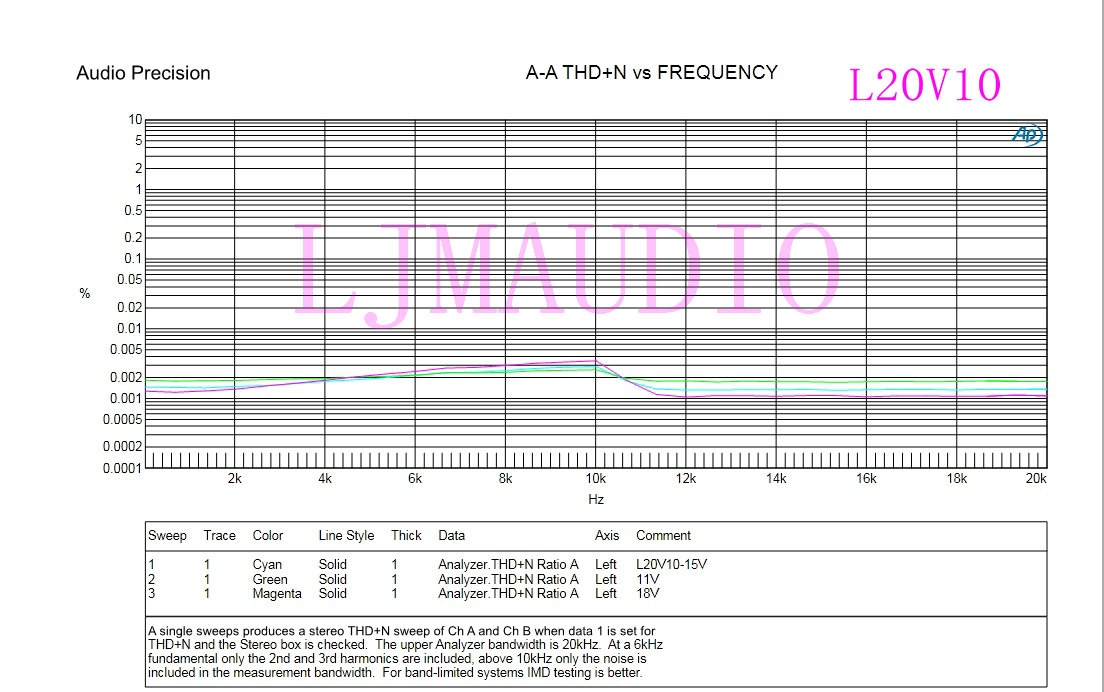

The latest test L20 The latest version.
THD +N< 0.0015% 50W 8R
THD+N <0.003% 50W 8R 20HZ-20 KHZ
2016-6-22
VER10. Has the strong driving ability.

LJM, Can you recommend a reputable supplier for L-20 v10? We read so much about bad quality products that give your (excellent) designs a bad name. Who can we trust to buy from?
Note: I tried to PM you, but your mailbox is overfull. I think others would be interested as well.
Thank you for your help.
