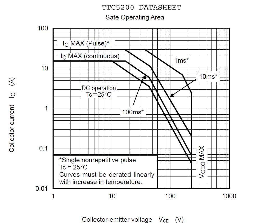

Here is the SOA of the TTC5200's and I see that they have very low current capacity for the voltages that I want to run, i.e. 50 each way.

At 50Vce they have good current capability, about 2.4Adc
It's @ >60Vce that they collapse. Down to just 1A @ 70Vce and 1.6Apk for 100ms single shot.

@~97Vce
But your output device can only have this Vce (from +-50Vdc) if it is driving a very reactive load with a very out of phase signal. This necessarily reduces the duration from DC to maybe around 10us to 10ms, not DC.

I get it, 😕 the speaker is only a few ohms and not a piece of fencing wire!
This can only be a good thing; 🙂 as I have always looked at the 'DC' line of the graph and tried to stay within it's boundary, meaning that my output transistors are usually under-stressed. [provided I use a 'speaker' on the output terminals!].
On the other hand: When I come to think of it, the 25 degree transistor-case scenario is an ideal. The size limitation of my heat-sink (if it 'is' to fit within a case inside my lounge room!) will substantially reduce the SOA once again.😉

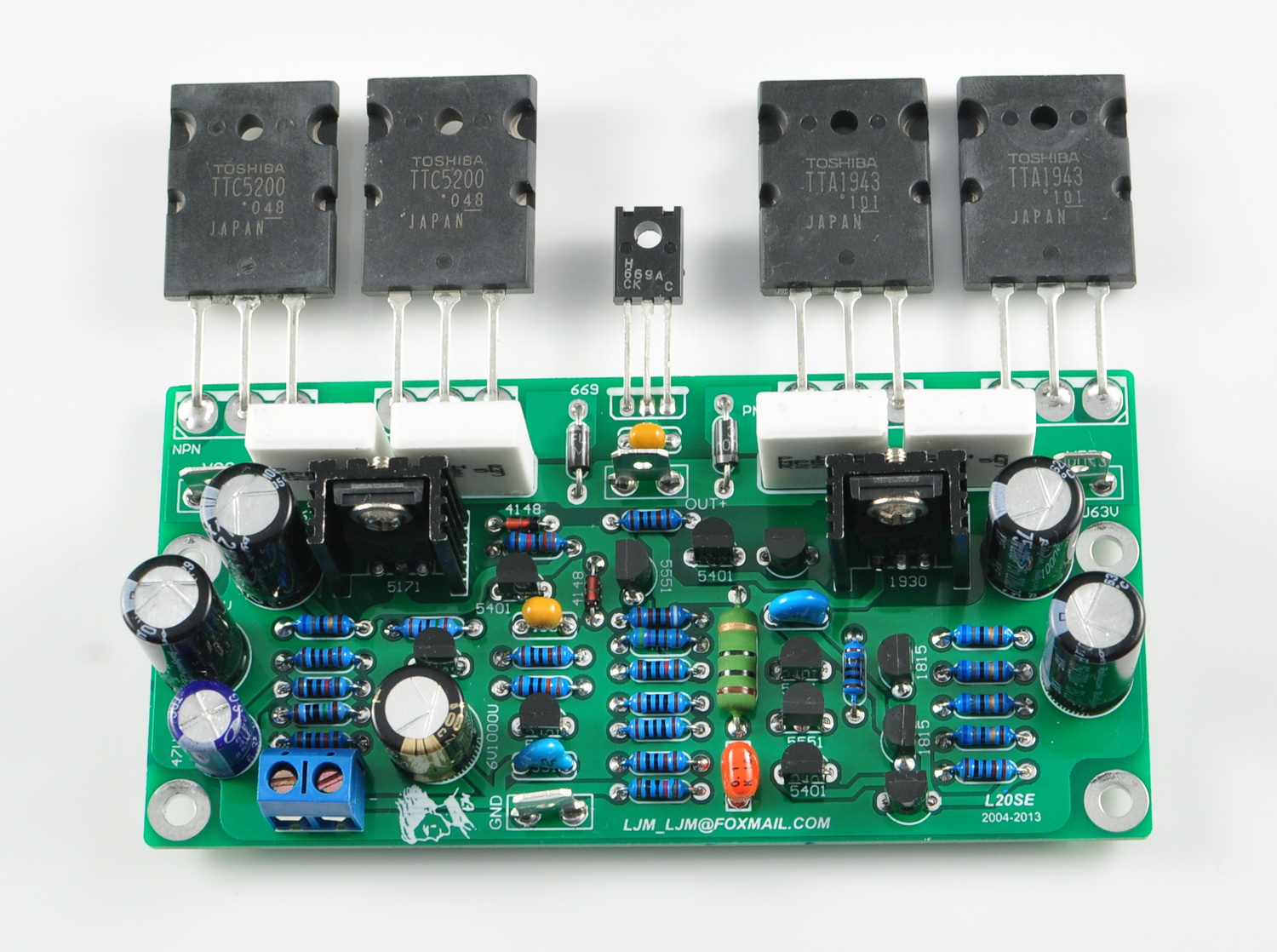

Funny that one channel is getting hot and the other not without any load at all. Leads are indentical in both channels.

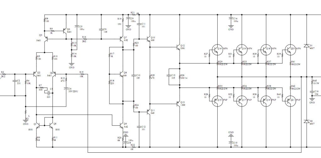

Now I am sure because I measured no bias in one channel. This is going to be difficult to fix because off no schematic.
Got this last full schematics
input up to 1.5V RMS
still got some DC
A bit different compared to my 9,2 version. Diffeerent drivers and mine has no resistors on base of output transistors. Mine gets very hot . Maybe oscillates a bit. Have very low dc less than 7 mv.
I modified a bit to get the bias up.
how did you do that ? i have a lot of cooler,doesnt get even warm to touch
i guess it was about r17 and r18 default is 4k7 and 1k .
I have same 9.2 version.please tell me how to bias.

L20SE ,L20 VER9.2
There will be some heat.
If you want to reduce quantity of heat. Reduce the static current.
Reduce 9 k1 resistance, the use of 8K5 OR 8K2
OK
got it so R1 from Voltage divider bias of 669 2SD669 should be lower than the default
Might be because a batch production of parts D669 VCE voltage than a slightly higher in the test.
So to make the static current.
I then to purchase the product batch number. Correct L20SE without debugging.
After installation of static current about 18 to 25 ma. A transistor.
If the static current is greater than this value. Can be adjusted by 9 k1 resistance.
To reduce the resistance value.
