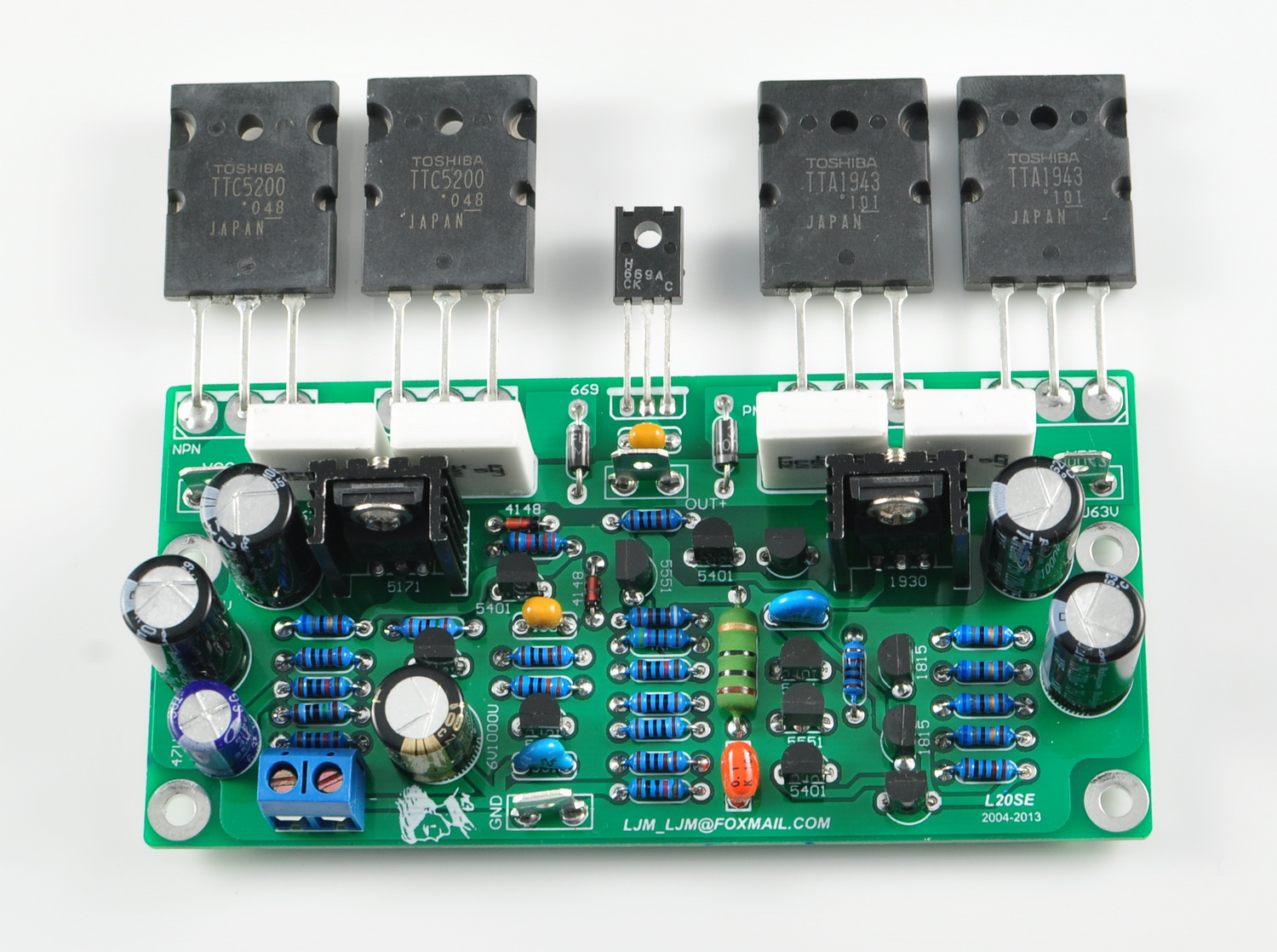

I think L20SE recently, it simplifies the L20 power tube number.
I think, L20SE needs to design circuit board. A new L20SE circuit board.
Its source, L20V9.2 circuit structure.
Reliability is better,
Yes, it does not need to input capacitance.
I think it is suitable for the voltage range is lower than that of DC + -60.
Using Toshiba transistors instead of ONSEMI. It has better stability,
The radiating area more.

As AndrewT says, if you want to use only one pair of output devices, the maximum voltage should be +/- 35V. Anything more will cause the transistors to fail when driving a 4 ohm load hard.
NONE OF THESE BOARDS HAVE ONE OUTPUT PAIR - THE MINIMUM IS 2 PAIRS.

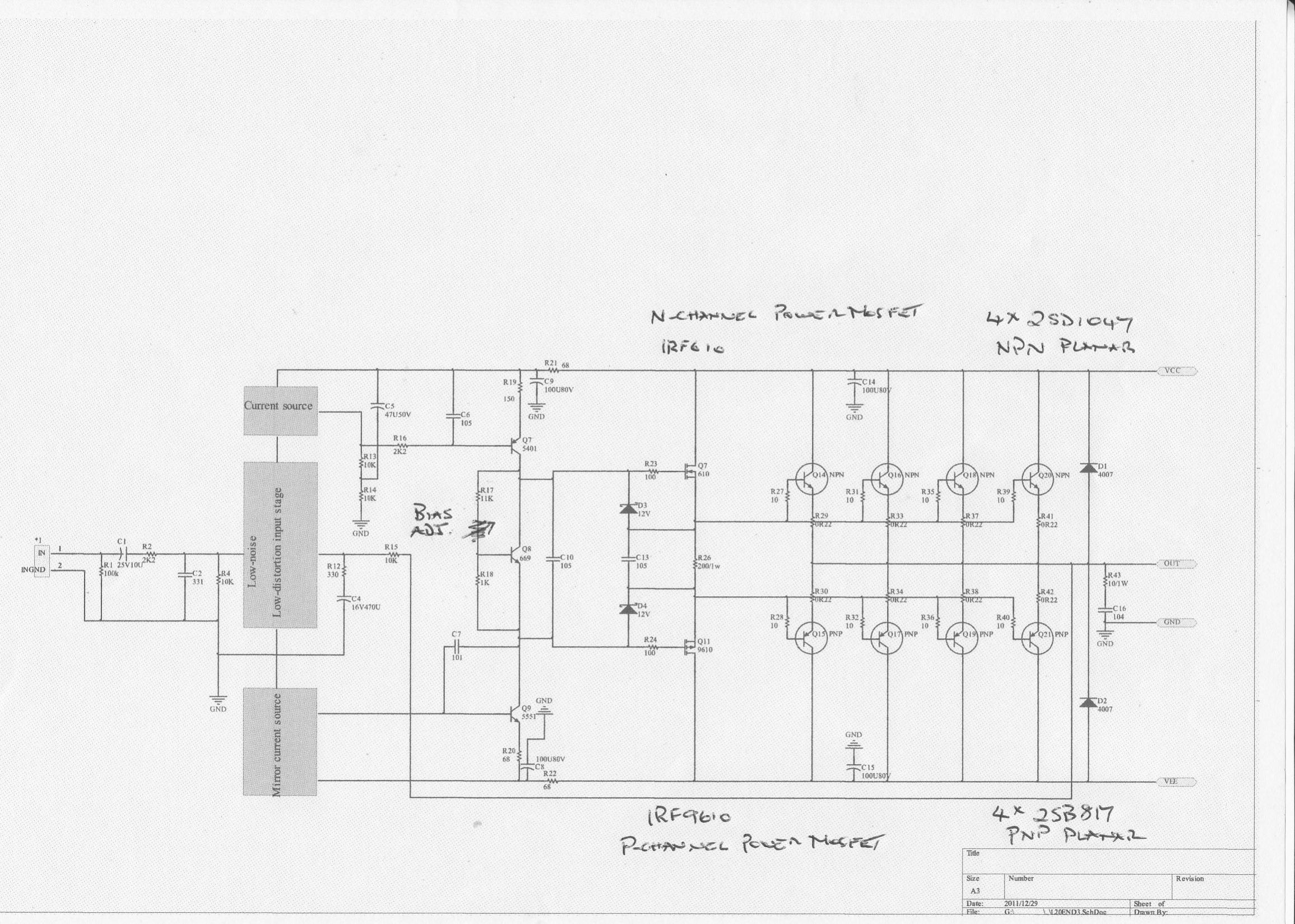

Appeal to LJM_LJM for Schematic L20V9.2
Hello from Tasmania LJM' could you please post the schematic for the L20V9.2 and circle the capacitor that you talk about in the previous note. I just brought a stereo pair kit with the TTC5200/1943 (two pairs per board) It represents terrific value and by all accounts sounds great to the ear.

Ok cobber, I have given you what I reckon is a pretty good rave - so how about a schematic for the L20SE with the two pairs of 5200/1943? Green board on ebay at the moment.
Don't post that crappy blasted thing that got put up before, it is obsolete. Please draw another one showing the schematic for the green board that you mentioned (and I purchased). It should only take a man of your caliber about 10 minutes to draw.

The kit components do not match or even resemble the overlay on the board. There is no schematic. There are no explanations from LJM.

So, have you read the thread and noticed the schematic at #14? That doesn't leave much work for you to do with pencil and paper to fill in just the input stage which will be fairly standard - CCS, LTP, Cascode stage and Current mirror but I suspect it may borrow from L12 which has an unusual feature in the current mirror - that's for you to trace out and ponder over..... I feel like I am banging my head on wall....I don't want to change anything. I just want to understand the circuit.....
Don't forget, L12 was published with errors to throw copyists off the scent too, as you'll read. If you want to respect his IP, don't post your findings here where his competition is just watching and waiting for any free information.
