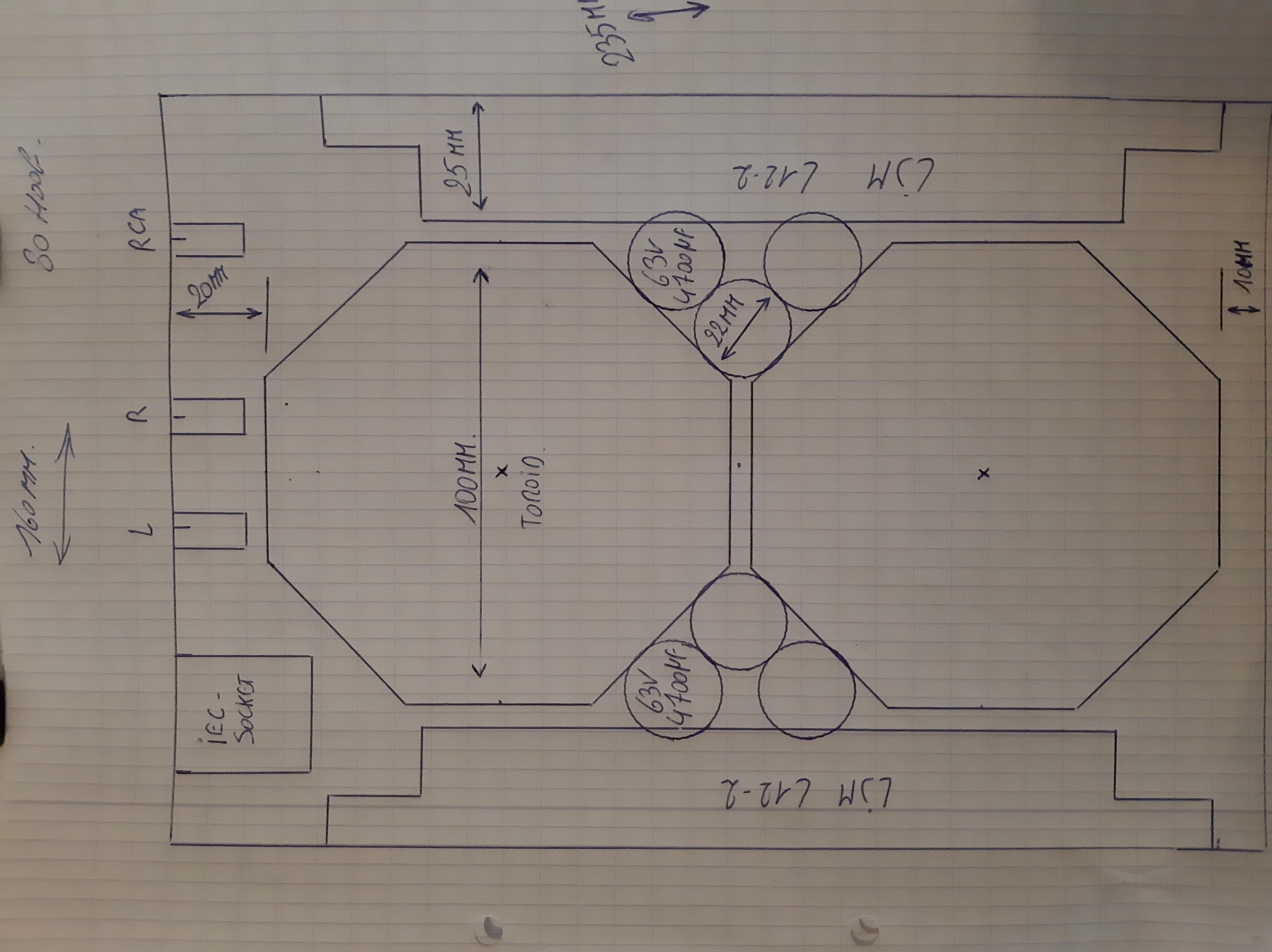

I want to build a amp around the l12-2. I already have them.
I also have a case where i want to put everything in, but it's a tiny case. I can fit 2 toroid transformers in it with a max diameter of 100mm and max 50mm heigh. This means a transformer of 120va for one channel.
I don't want to use all of the power, i'm happy with 40-50w@8ohm.
But i don't want to destroy the PSU and want good quality sound.
Is this possible?
I can get 2 amplimo 2x35v 120VA toroids.
If it's possible, how much uF of capacitors should i add per channel?
Min. 10.000uf?
A sketch of the setup i want to use if possible

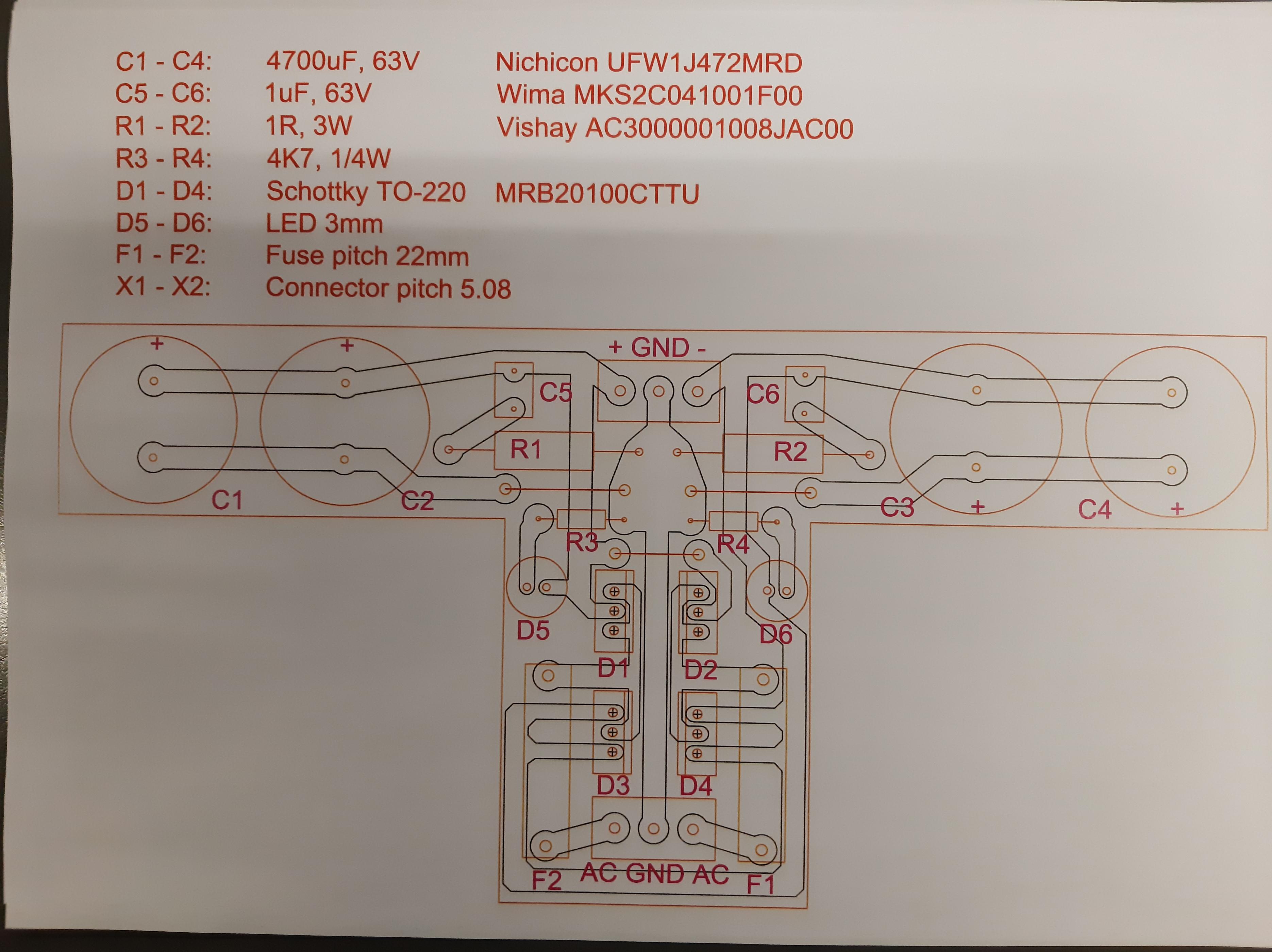

I'm thinking of 4 schottky diodes (to-220).
4 4700uf caps (nichicon)
2 1uf cap + 1R resistor.
2x fuse
2x led (1 per rail)

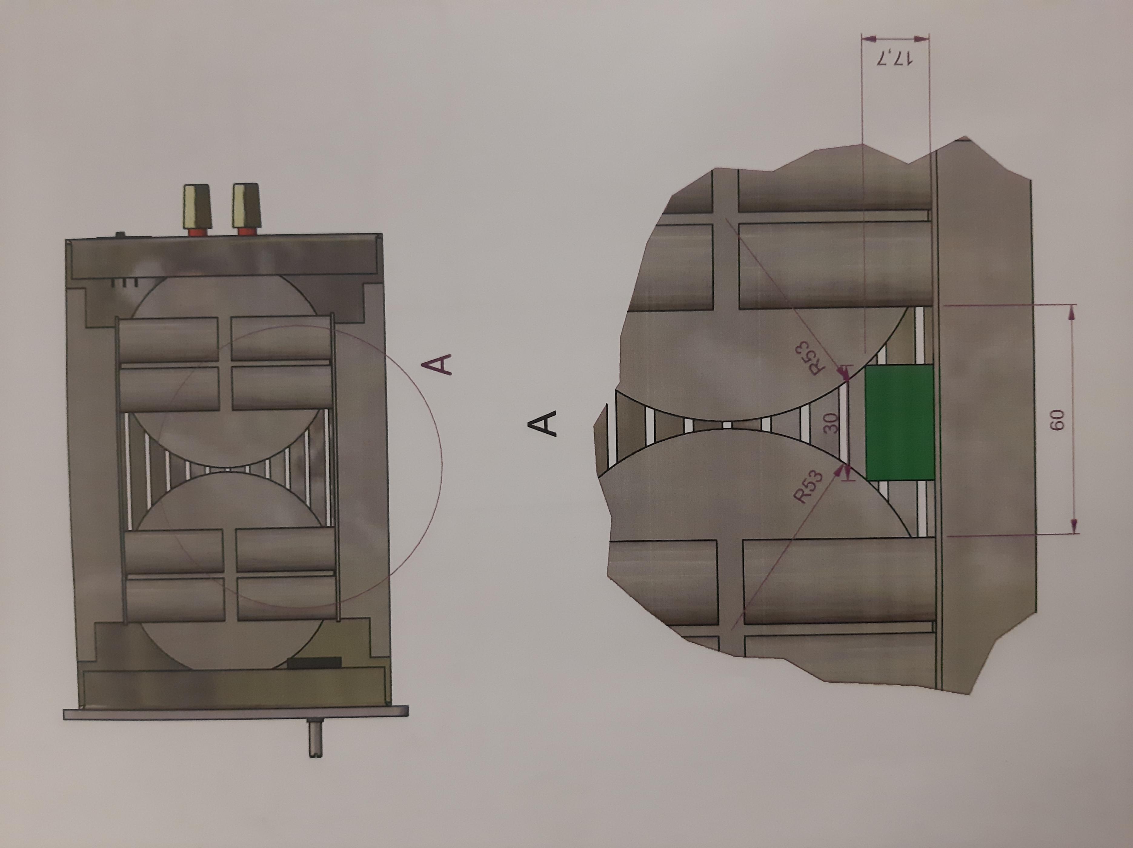

I made a board layout for milling a pcb.
The caps fits over the toroid's, the schottky's between the toroid's. (Green square).
