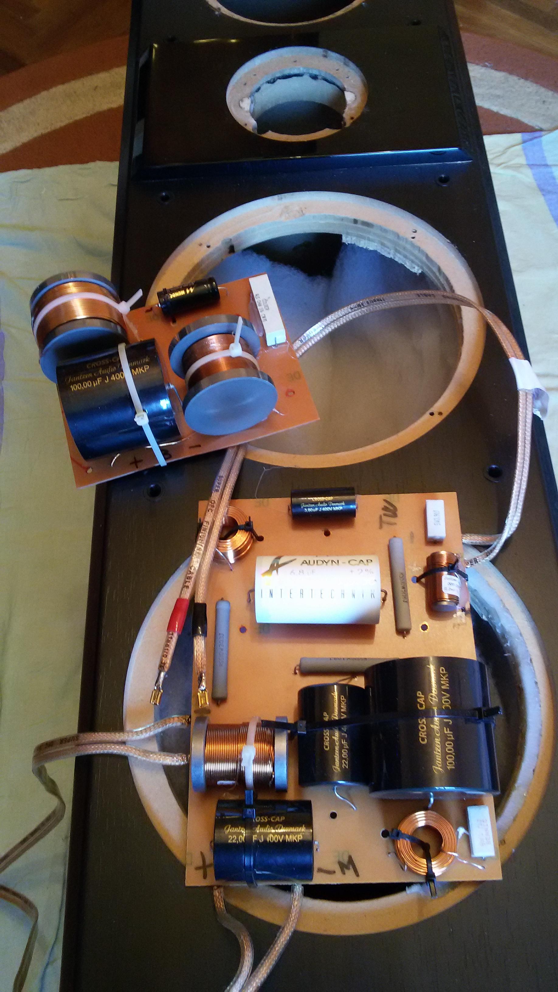

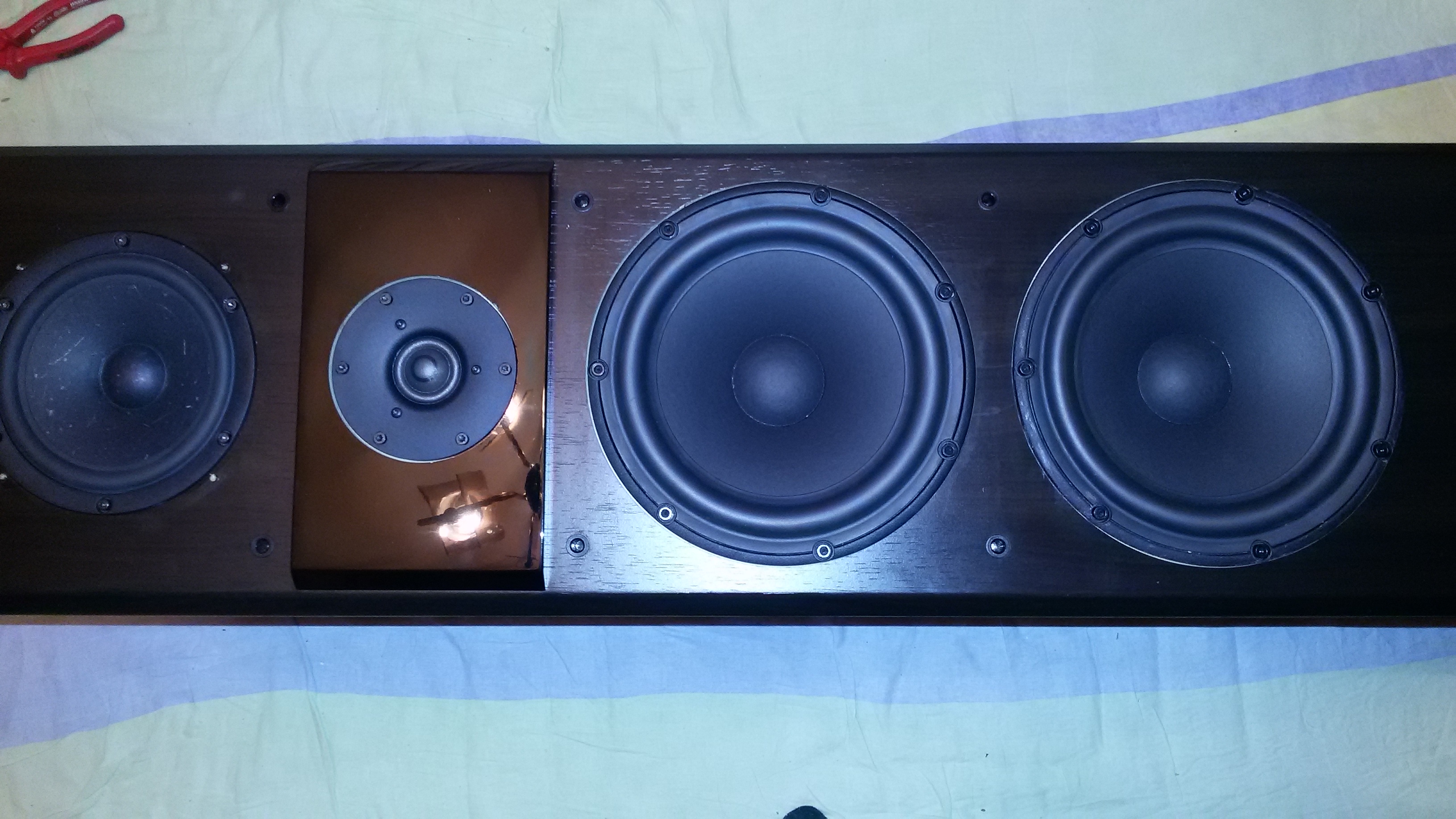

Thank you very much for your help, I have homemade 4 ohm speakers made by me, I would like to make an amplifier from "0" as well as Diy for my 4 ohm 3 way speakers with scanspeak TWEETER D2904 / 7100-03 speakers - 4 OHM, MIDWOOFER SATORI MW16P 4 OHM, WOOFER 22W / 8851T - 8 OHM 2 Pcs, but I think I'm going for this option, I have a defective Sony TA-5650 amplifier with the defective power amplifier, and I saw that the voltage that pulls it off Sony TA-5650 for amplifiers is +/- 47V 6.3 A, what do you say I put the L12-2 modules in the Sony TA-5650?
my speakers ,,,,,
my speakers ,,,,,

And please don't post any more schematics or pictures of loudspeakers only relevant to you in this thread - it is the wrong place for it. You should instead start a new thread for your amplifier project.

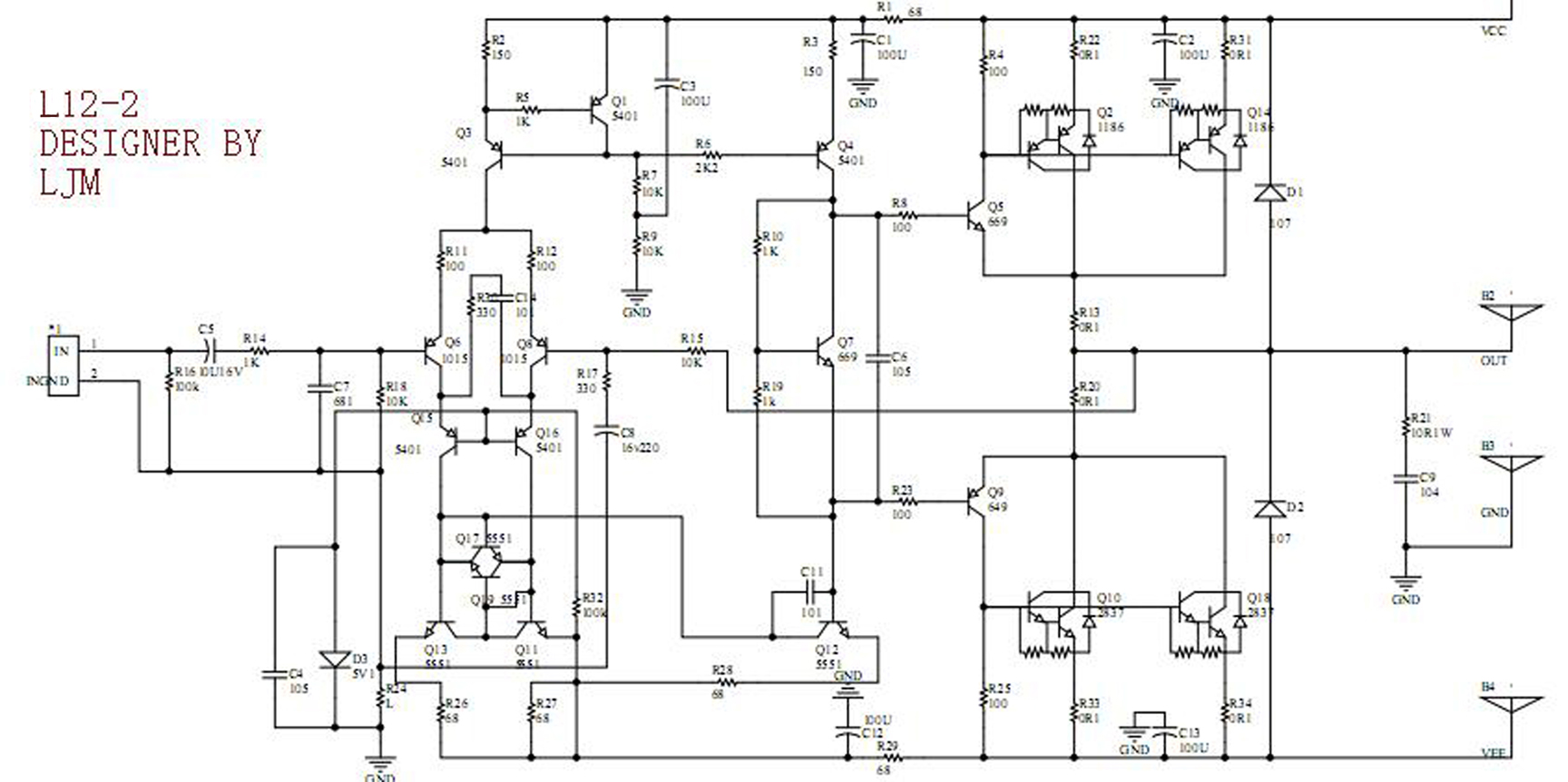

How Q12 works ?
That schematic is wrong. The collector and base of Q12 and Q13 are swapped and the emitter of Q11 connects to R27 only. R27 should not be shorted.
A corrected schematic was posted (#12) but it was lost in the "photobucket".
- L12-2 CFP Output amp 120W*2 8R
