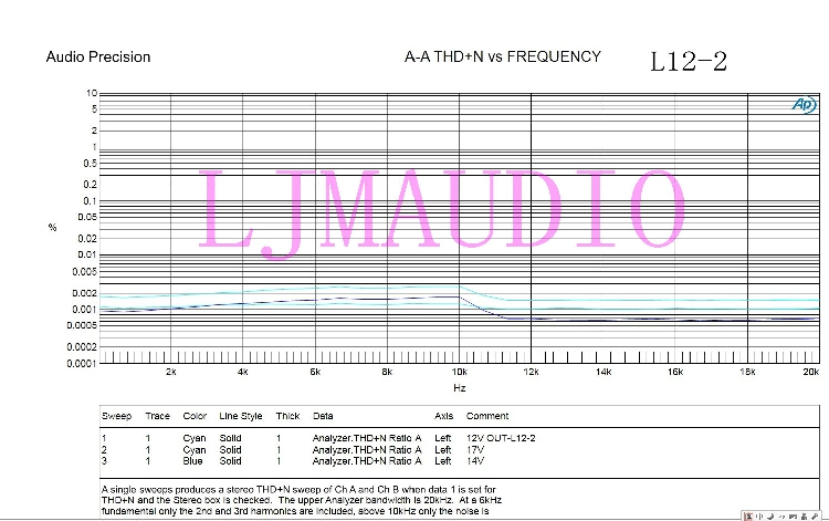

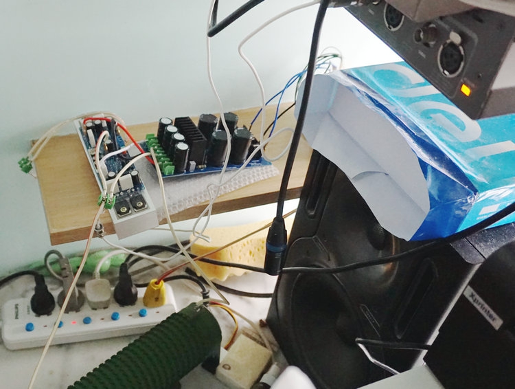

About the test.
I use a 200 va AC24-0 to 24 v transformer. black
Power strip with 4 * 5600 uf
Load of 8 ohm resistance of 1000 w.
Use a larger capacity of capacitance will decrease the distortion of low frequency.
But I don't have any more.

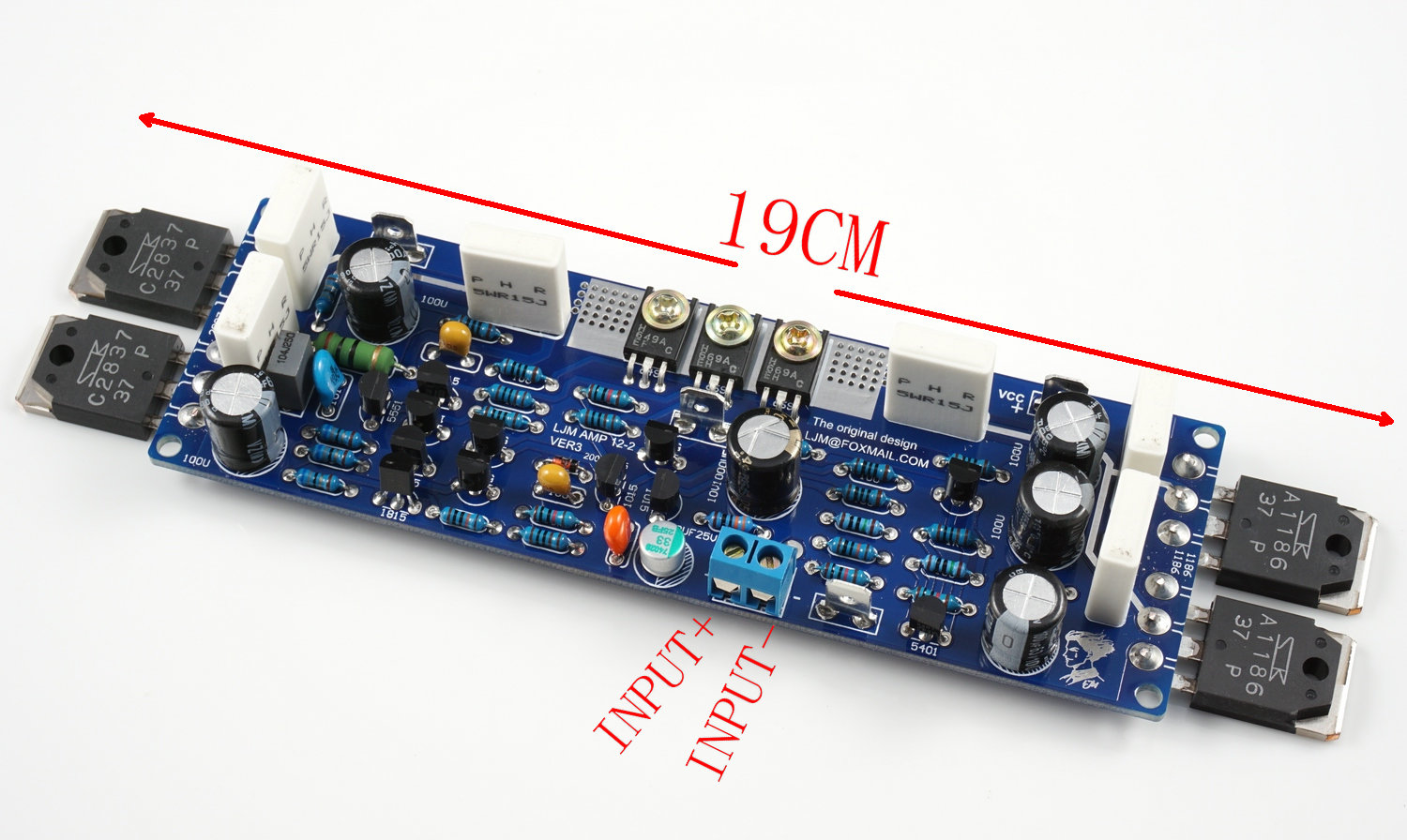

I've got two board of L12-2 from TZT Trading.
But I found the sound lacks of resolution when I compare the L12-2 with my HK3490 Class AB and with an Aiwa CX-Z720 (Best sounding). It lacks details in all the midrange, as the sound was not clear.
I've tested the boards with 3 different power supply:
- 2 x 35VDC Transformer with rectifier 10.000uF each rail
- 2 x 12VDC Battery
- 2 x Linear power supply +-14V with LT1083 regulators 10.000 uF per rail
There were not so many differences between them.
I tried to EQ with my AK4495 DAC but I think it's not a matter of EQ, it's about the separation of voice and instruments.
I've changed the input capacitor with a 1uF 50V film type but there is not much change.
I've also added 100nF 100V f¡lm capacitors to bypass all the electrolitic capacitors on the back of the board but again the major problem is not solved.
I've got the amp running pink noise with resistors for over 20 hours.
DC offset is around 8-10mV, output does not make any hum or hiss on the speakers.
Both boards has been tested together and separately with stereo and mono recordings.
What I can test or mod to improve the sound? Maybe some parts are fake?
Sound it's not bad at all, but it has some kind of blurryness that the other 2 amps dont show.
The board is this one:
Any help is greatly appreciated. Thanks!
