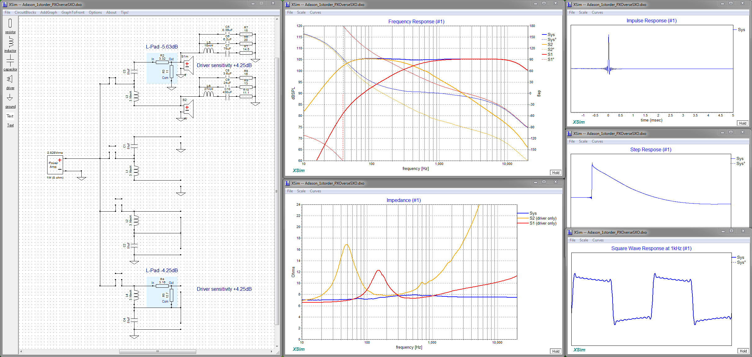

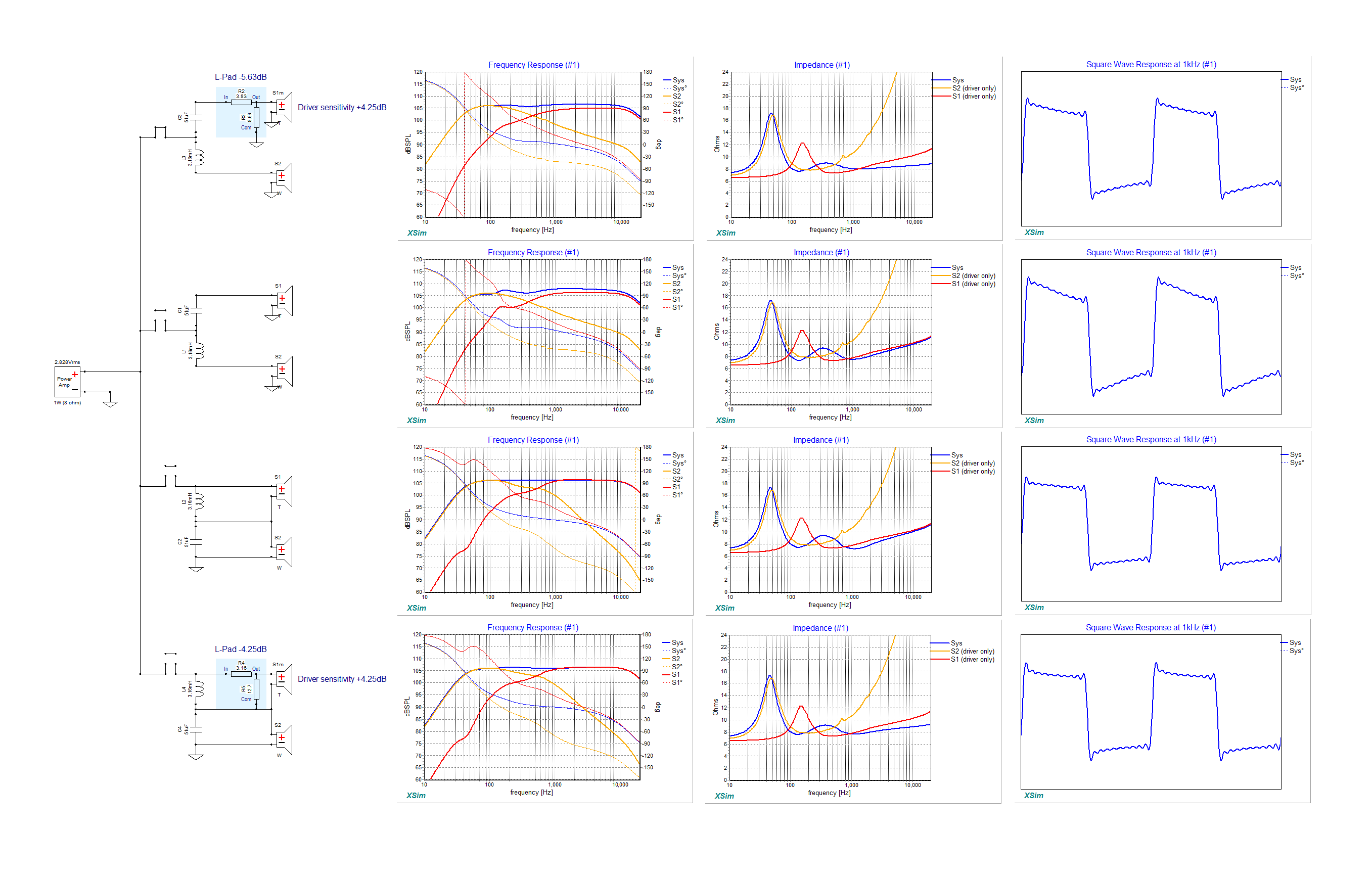

* At high frequencies the tweeter//l-pad//inductor is 8 ohms and the capacitor shorts across the woofer reducing the voltage driving the woofer. At low frequencies the inductor shorts the l-pad//tweeter reducing tweeter drive while the capacitor//woofer stays around 8 ohms nominally.It seems to me that l-pad in tweeter section is not a good idea. It is effectively shorting the inductance of the crossover coil and the tweeters inductance, thus changing the crossover point. Threads i found were not of help. Any definite solution? Just one resistor in parallel with tweeter?
2-way 1st order into XSim, zma-files are from real drivers SPH-250KE and TC9FD but cheat a bit link both drivers a frd-file with same BW2 40Hz - BW2 16kHz textbook bandwidth, it seems the two serial filters performs best in this simpler setup. Parallel gets better with resonance and inductance correction networks seen in second plot, XSim dxo file as zip folder attached.
Wow BYRTT, that's nice work. So i may be wrong about l-pad, or the difference is miniscule. On the other hand your simulation does show better square wave using series crossover. That's what i plan to measure over the weekend.
Thanks.
Thanks.
Yes it seems when sticking to as simple a network as possible in only one capacitor and one inductor then serial wins, look forward hear what real world experience it brings you over the weekend.
