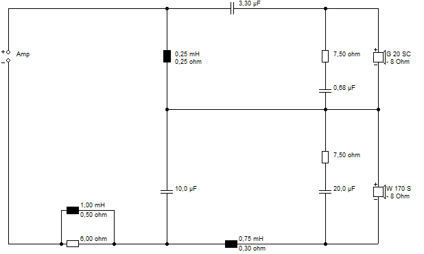

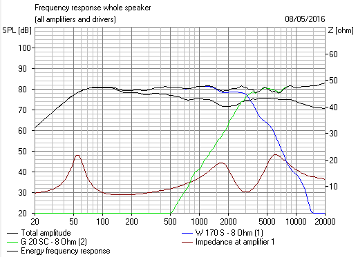

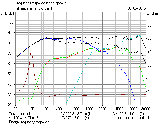

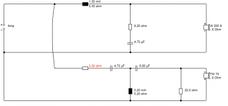

Hi all, i did simple experiment, simple 2way, exactly the same cap and coil used, once series, once parallel. I measured fr response and then fed it square wave.
Fr response close between both crossovers, but not identical.
Square wave so bad in both cases, no need to mention it. Small difference too, but nothing like theory says.

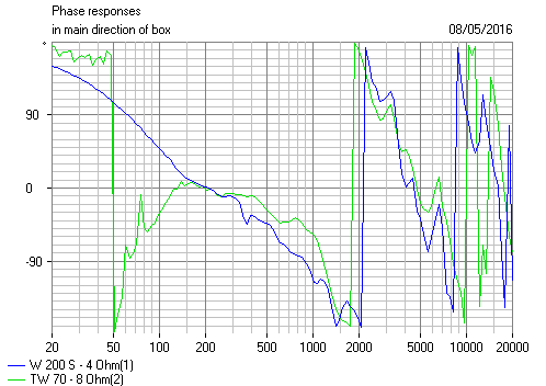

Looked at my HDD here picture-1 some live square waves from past when exercising 1st order filters, think at that time it was 2x Behringer DEQ2496 that did XO/timing/Eq. That was a 10inch woofer and TC9FD, today in same exercise setup have a 10F mid-tweeter and LR8 XO at nearly same XO point, distortion profile is then better and with a more modern DSP can neutralize phase turn caused by steep LR8 so it produce square waves and IR/SR as in picture 2 plus 3. A thing that make me leave 1st order was vertical lobe that is some tilted when XO is not in phase at XO point seen in picture-4 with free XDir available from Tolvan Data who also share free The Edge program.

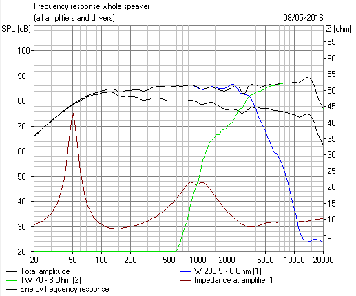

Been naughty and traced your blue trace from Holm plot, hope have it right in guessed that Y axis is 5dB steps. Into XSim system stop band BW2 roll offs was set to 42Hz and 20kHz and then gives grey traces in below, then added kind of baffle step correction a low shelve at 300Hz +6dB which is blue traces. Think if you don't get some close to these graphs that difference is acoustic center mismatch that would be easy to correct in a trial with use of your miniDSP or Behringer unit.

All is nice freeware:
Graph tracer FPGraphTracer : fprawn labs
XSim: http://www.diyaudio.com/forums/multi-way/259865-xsim-free-crossover-designer.html
REW: REW - Room EQ Wizard Room Acoustics Software
Rephase: https://sourceforge.net/projects/rephase/
Graph tracer output frd-files that can either be imported to REW or link it to a driver inside XSim. To best read only the blue trace in your Holm plot i make a copy edited in MS paint where nearby traces from red trace is removed with eraser tool so graph tracer 100% pick the right trace. You don't get the phase this way that belong to that particular frq response but XSim can help double click on driver and tick "derived" where i set that stop bands mentioned as BW2 42Hz and 20kHz. If you happen be able to feed tweeter and mid-woofer drivers into XSim both a frd-file with in situation measured frq response and zma-file with impedance data for in situation cabinets, you will be able tweak capasitors/inductors/resistors and gets nearly exactly same result as plots says when you measure system later, if phase in measurements we base simulation is close to truth.
Low shelve 300Hz +6dB i did in REW by import frd-file then use their EQ prediction tool and read the new frq response from that plot with graph tracer and then linked that frd-file to one more new driver inside XSim.
List Rephase above not because of FIR filters but because of easy creation of IRR filters. In its IRR tab it takes a minute to create a known textbook target-curve for use imported in live measurements to hit right planned slope. Rephase outputs IR-wav files than REW can read, then if a frd-file is needed instead of, REW can export as frd-file.

Well, its raining outside, so no outdoors activity. I started this project to learn about series vs parallel crossover. I am working on AC130F1 and Dayton 3/4" tweeter 2-way to put it into bigger better box, in order not to roll off low frequencies in my temporary small open back enclosure. I think uneven fr response is messing up the square wave.
While I am working ot the box (Ikea bookshelf) I rewired one side of my open baffle 12CXT B&C coaxial. So the same story, one channel is parallel, one is series, the same speakers, the same crossover parts. Here is what I got.
