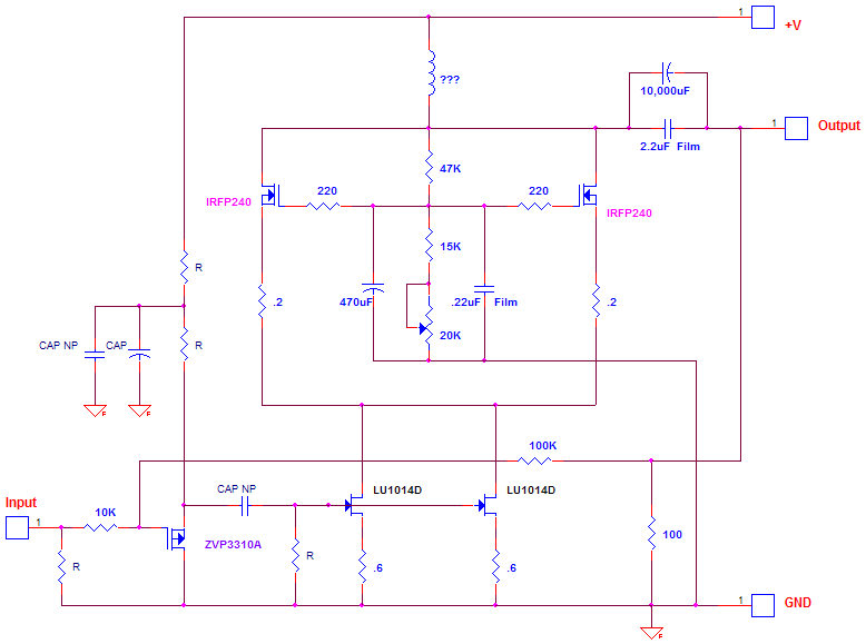

I've performed a few more tests on the ZV9-L idea which may intrerest a few others. I tried connecting my 800VA toriod as the load, previously tested in the 115V connection, in the 230V connection. My expectation was that I would see the effects of the >1H inductance (4X the 115V connection) improve the output wave shape or the saturation effects worsen. It appeared that the saturation effects worsened much more than the increase in induction helped.
I also disconnected the feedback to take a look at open loop gain etc. :D Open loop gain, at 1kHz, with Iq of about 2.2A and a 7.5 ohm output load with 1Vp-p input, seems to be about 20 with my best EI laminated inductor as the load, and just short of 15 with my 13.7 ohm R as a load resistor.
I was running a gain of about 7 (16db) and about 10db of feedback, if my guess is correct...
:smash: :smash: :smash:
That buffer looks so familiar;) I ran 442K on the feedback resistor and 147K to ground at the buffer's gate. The only difference is the 1uF blocking cap I have on the input. I also biased the buffer up with a 571 ohm source resistor.
I notice you're using an electrolytic and non-polarized cap in the power filtering stage above the buffer's source resistor. What does the n-p do?
I'm still digesting the rest of your circuit. Pretty picture!
John:)
Yes, I think the R to ground at the input is likely unecessary. There is a path to ground through the feedback R and 100 ohm. If you don't give a MOSFET gate a path to GND it will float around... The tinyest leakage current will pull it to a DC GND with that R, but as I said, it's got a path. Your amp has a high DC voltage at the output, not a exactly a DC path to GND...
The R before the 10K is actually forceing the 10K to be the major contributor to the input impeadance. If it were after the 10K, the input voltage would be 9/10ths of it's level and the ratio of the 10K and 100K(F.B.) would have to share that impeadance(and signal current) and it would effect gain. Your amp has a DC current from the output looking for GND and it is part of a voltage divider from the output to GND. Therfore it sets the gate voltage of the buffer and you probably should have it there. A few posts ago I mentioned that. All those Rs in that area have to be considered for gain and follower bias etc. I did not like messing with it when I was playing with that design. I don't have to mess with the DC from my output, it's after the output cap, no DC:D
The 221 ohm, well, I remember looking at your circuit once and seeing huge gain(due to the 221 ohm). I thought you figured that out though??? In my circuit the 100k(F.B.) divided by the 10K determines the overall gain. No other considerations of output DC are involved... and The preamp or whatever basically see's The 100K in paralell with the 10K for an input impeadance to the amp.
So, what does your current schematic look like:bigeyes: :bigeyes: :bigeyes: hey we should be in the other thread with this:D
