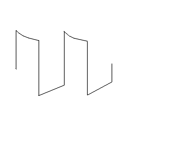

Babowana, in both Ls, the square waves only "overshoot" at the low freqs. The rising edges begin to get rounded at higher freqs. The "overshoot" and rounding, does look realatively symetrical...
Also, I do not have the feedback resistor bypassed with the 10p C as Nelson sugests in ZV9 (it should make the square with look better). I beleive this will only help the high end though and in the opposite way??? I can try a C though. I also think varying the gain/feedback might be worth a try :smash: :smash: :smash:

In all my excitement to bench test, I don't have some of my typical stuff on this amp. I'm powering it with my 'ol standby rack mount switcher. Well I generally have 5-10mF of C on my boards right near the output transistors and I don't have a board for this one... So, I figured out while at lunch, I am probably seeing the transient response of my 'ol standby switcher supply in the output response of the amp??? I was a little hesitant to call it "overshoot" cause it's not quite overshoot looking and it just transfers from overshoot to rounding of the leading edges of the squarewave across the frq band???
I can look at the supply line first(shame on me) or, I'm going to hang a big cap or two on the switcher output, with a film or two, and see what the output looks like then??? I'll bet it gets right back in line with what it should look like...😀

Well, I doubled up on the cascode refrence bypass (2 x 470uF) and I added a 22,000 with a film to the choke input 😕 😕 😕 No change in the square wave response 😕 😕 😕
Actually, the waveform is not exactly symetrical??? See below???

Babowana, I know what your saying, I was hesitant to call it "overshoot" too 😀 But it is following the frequency and reducing it's "delay" or saturation or whatever unitl a few kHz and then it starts becoming a rounded rising edge all the way up to rolloff. The falling edge maintains a reasonable shape until it becomes the -rising edge??? What do you make of the capacitor looking curve at the top(positive) portion of the curve but a straiter looking ramp on the negative side???
I can take a few shots in the dark, the "shotgun" method??? I'm going to change the output E cap to a bigger low ESR type. The one that's in there is scavanged from an old peice of equipment??? Also I might try some damping??? A 100 ohm across the choke or to GND???

Well John, I had my share of ignorance and stuff too. I've had my scope on the AC setting all this time and it really dosen't like a low freq square wave so much... Still getting used to it. I hooked up 13.7 ohms of resistor load and cranked the supply up to about 55V and set the scope on the DC settling and it does alot better... But there is still the slightest bit of this tilt still there??? And, the high freq rounding is still there... 10K dosent look so good 😕

After a little thinking and re-reading the ZV7 article, it is just likely that I should expect the performance my ZV9-L is getting???
Nelson experienced low frequency "saturation" characteristics even though ZV7-T cancels the DC field in the inductor. My prototype dose not. And, I have not done THD measurements that may be somewhat comparable to his graphs. I have only wittnessed the squarewave performance, however revelavent... When I loaded my prototype with 13.7 ohms of R, I saw good low frequency results.
Nelson had good mid-band performance. I actually seem to also. The squarewave looks the best from 1-5kHz.
Nelson also experienced higher freq distortion with his L loaded experiment. Well, althought I called it rounding of the squarewave, it is higher frequency distortion:bigeyes:
But with the R load, why do I still have high freq rounding of the leading edge of the squarewave😕 😕 😕

As far as I understand,
the rounding edge is due to the internal capacitance
The rounding indicates that the frequency is approaching
to the critical frequency, which might be 100kHz or above
And, we could use the rounding edge to estimate
the upper critical frequency, by reading the rise time
