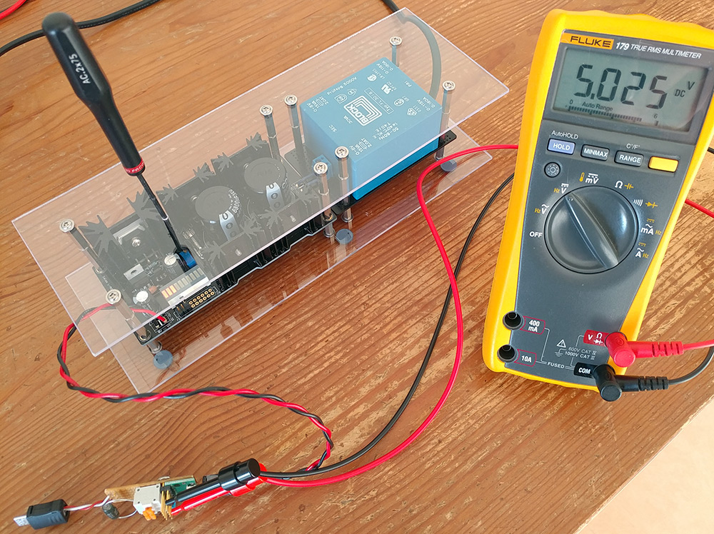

Seriously, I feel like an idiot. The LM334 is overheating. I put a single 5.6V zener as Vref and an 18R current set resistor due to the lack of 12R value. What is going wrong? Could it be oscillating? I even disconnected the Vref circuit from the sziklai.
My bad, got it reversed.
Just tested it. 5V unloaded, goes to 4.8V when loaded with 2A. 100mR output impedance?
Voltage across D11 is satisfactory - 7V
Edit: Doing it on a prototype board to test on my Pi
So it was just wrong connection. Built as standard with Leds and everything I measured 25mR at 2A. Including the board loss. Let it settle a bit thermally first. Maybe the Zener has a highish dynamic impedance at the particular bias current also. Or the driving BJT needs bit more base current sourcing available. Try with 10R LM334 setting resistor instead of 18R when not having the 12R for 5mA. Compare the 5V6 Zener vs three red Leds too. Less noisy at least.

Are you using the exact BOM transistors and low resistance tracks?
P.S. Monitor the AC ripple at C4 when on high amperage testing. It can shoot to quite high pk-pk eating away most of the DCin-DCout no load margin. Its must be still allowing for 2.5V DC leftover across the pass BJT for good Zo.

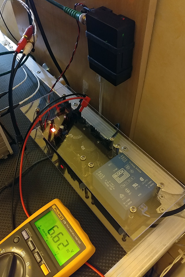

seems I can't handle my DMM properly sometimes... steady 9.75VAC at primary.
Voltage drift in my case is around 10/15mV when warm. 8VAC 30VA transformer and over 6VDC headroom, even when throttling at startup (Raspberry Pi 2B and Allo DigiOne).
It's working fine but that crappy Micro-USB socket I've used has a loose contact* and I hope that won't harm the SD Card. Can't tell about sound, too late now.
*Anyone for a quality Micro-USB socket to solder or a nice'n large gauge cable to sacrifice? Next move not planned but I need a reliable socket 😉
