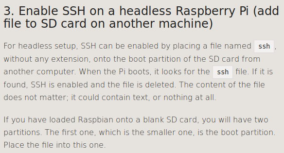

The fact is that I found out the hard way last night that:
1) I don't have a micro HDMI cable (I thought I did but it turned out to be a mini HDMI)
2) Raspbian by default has SSH disabled, and
3) Raspbian by default has its UART disabled
So for now I have literally no way "into" the RPi.
I need to go shopping..
