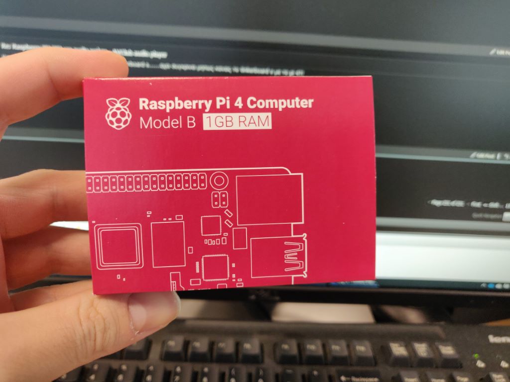

Fast gun indeed, and 1GB only. Not looking for fancy GUI use with such memory, smells like Dim is targeting audio only. Interesting to put it together with an L-A
3x more powerful processing than the RPi 3 early testers say... Not to be leaking more clock noise in its PCB though I hope. Dim's feedback vs Rpi 3 will possibly tell us if there are subjective differences or other.
The truly interesting part is that the USB bridge chip is on a PCIe bus and the GbE controller is on an independent RGMII bus, so no more USB bottleneck.
However, all of this processing power and I/O speed might be coming at a price (noise).
We'll see soon enough.
