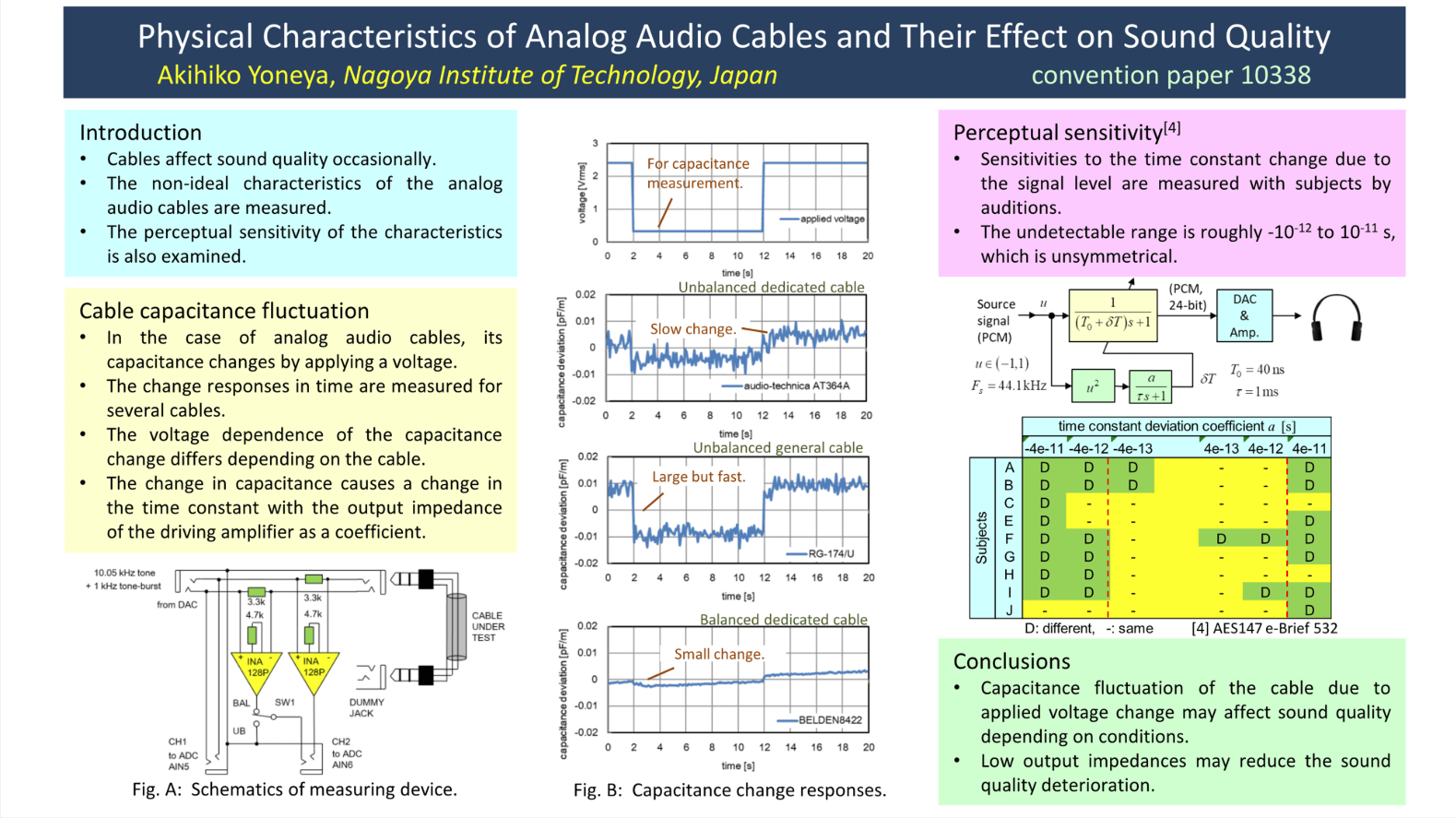

Some cable measurements I hadn't seen before described in a non-audio paper. Please see attached. Kind of looks like AC conductance is measured in way wherein DA displacement current is modeled to better understand complex capacitance.

Can you expand on that, please? I went over and looked at the tests and they are identical cable in and cable out of the loop. But you are saying that the AP is far from real world use in an audio system. What do you see as the differences and problems?
Here you go, quick LTScribble. It represents a still common scenario of unbalanced interconnecting of two audio devices with three wire power cords. Every such commercial device I own - Benchmark DAC, Sony power amps, etc. - hard tie the audio reference ground to chassis/AC third pin. In these cases it's reasonable the power cord is at minimum one of the audio current return paths to source. Depending on relative lengths and gauges of the power cord and interconnect it may be the primary path. Both are 'open to the air'.
In the AP loopback case the minimum ground impedance between I/O will be the AP's shielded and internal ground plane. No two boxes with potentially different ground potentials in this case. The interconnect's ground path potential carries nearly no current, depending again interconnect gauge. Holding the differences are of no consequence may be valid, holding they're equal is a stretch.

Thanks for the illustration, I missed it on Monday. I figured this might be what you meant, good to see it drawn out.
What would make a better test for interconnects? What would be a test representative of grounding problems in a typical system?
You might be able to use a clip-on pulse transformer to do something like introduce noise bursts into the ground loop. Then maybe look for evidence of audio signal noise floor changes and or distortion in response.
Other than things like that one could try breaking the loop and looking for reduced noise floor and or reduced distortion.
