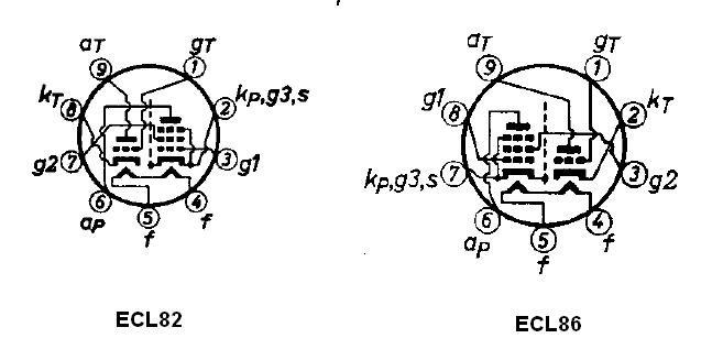

ECL 82 pin-out is different from ECL86

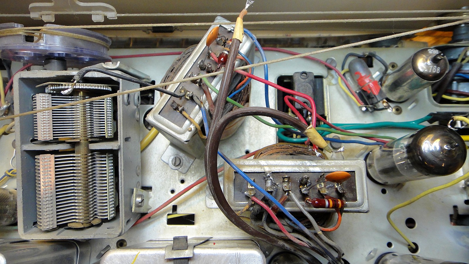

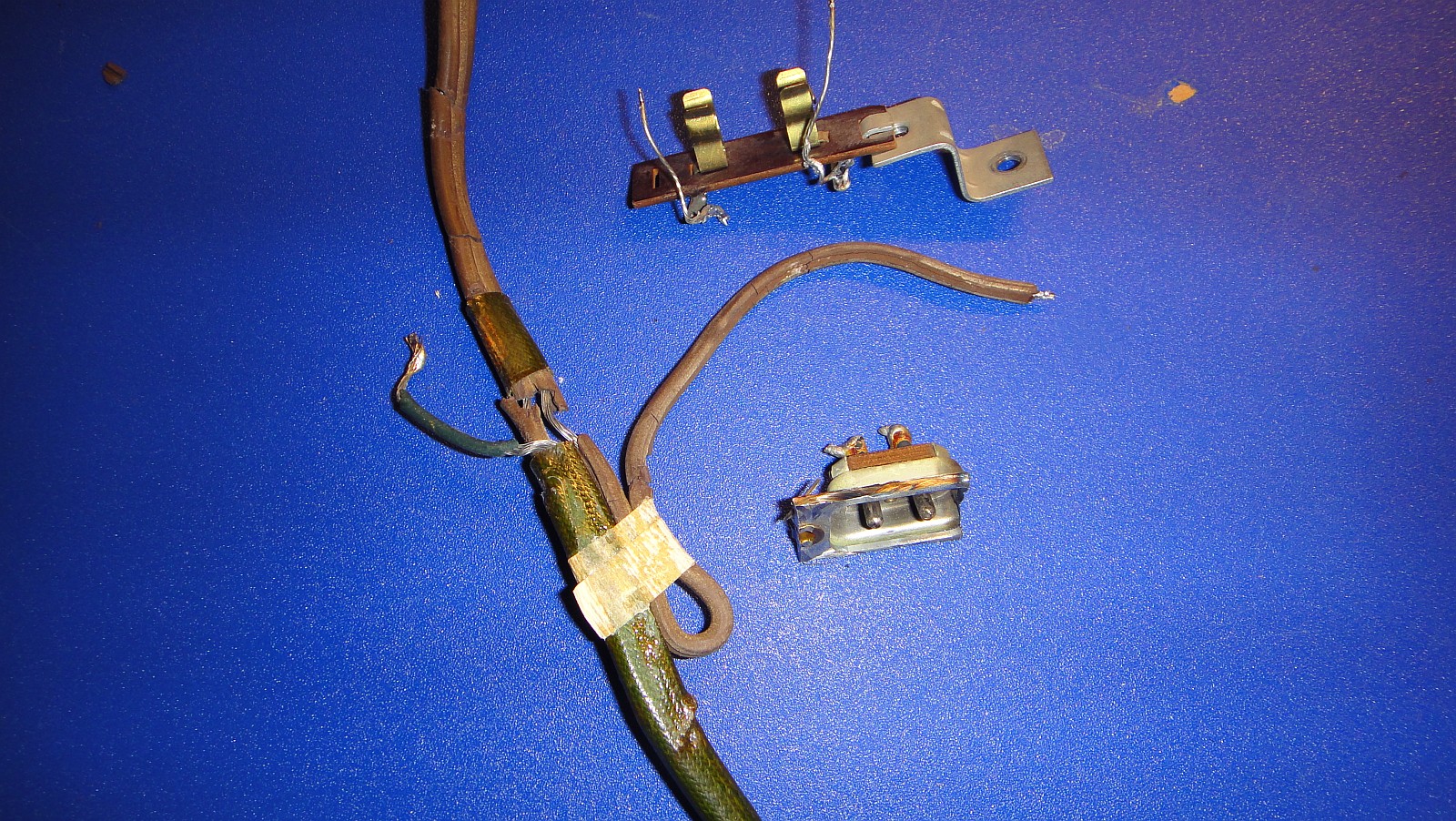

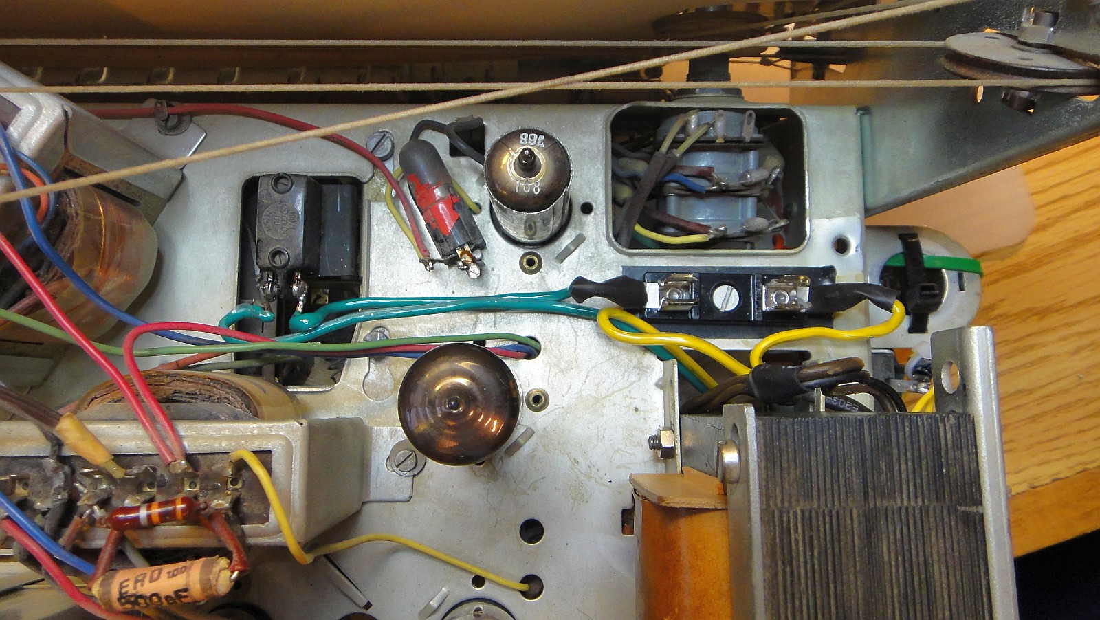

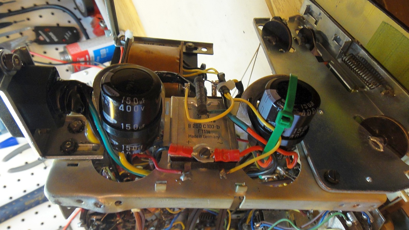

What I have done – I’ve started rebuilding completely the power supply rail - seems that the power transformer either have been replaced or some gimmicky repair job(s) have been done, extremely dangerous! The transformer have been mounted pressing the 110V cable and the heat “ate” the insulation to almost running bare 110V to transformer’s enclosure (see photo 5).

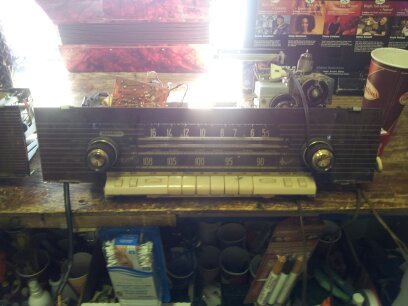

I’ve rebuild all the wiring, installed new fuse holder (see how was done before on photo 5), replaced both the can caps (50uF/350V) with Samsung 150uF/400V and made new enclosure for standard 3-pin female power connector, grounding the chassis to power ground (see photos 1, 2 and 3).
