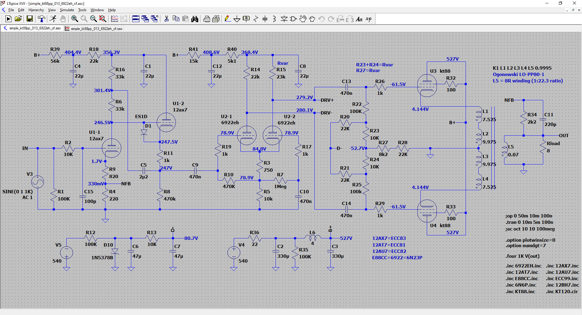

KT88 push pull cathode follower?
CF Output Stage Possible Failure Mode
The H-K max voltage rating is of concern in this kind of circuit. Oddly, the Genalex KT88 data sheet I have does not give any number. But a similar tube designed for the same application, the 6550A by GE does.
Refer to the attachments.🙂
This is also a problem for the McIntosh & ElectroVoice, they both seem to be successful in spite of that.
There are ways to drive a PP CF output without a massive -ve supply. Again, boot strapping is the answer.😀
I was asked to post the whole schematic for the design I posted in my 1st reply, please find it attached. Unfortunately I've not yet been able to come up with a working cathode follower configuration, so suggestions are very welcome!

I finally got it up and running, the culprit was the transformer model, or more specifically the Rdc specified for the primary windings, after significantly lowering that value the output started to make sense again. Thanks everyone for the suggestions.
George's comments are secondary considerations, they wouldn't produce a square wave output.
I agree that they are secondary to what seems obvious, but overlooked in the circuit from post #1. According to the schematic in post #1, the 6922 has some DC voltage readings that are impossible with a good tube. I don't know where they came from though.
The DC readings just posted show believable values for the voltages around the 6922 tube, however a cathode to plate voltage of about 280 volts will limit this stage to somewhere between 200 and 250 volts P-P of output. This stage will clip long before the output tubes will.
The output stage could swing its cathodes from -475 V or so to +475 V. That's 950 volts P-P. You will need at least 1000 volts peak to peak of drive to get the most out of the output stage with a bit of headroom.
The effects I mentioned before may not apply to a properly biased and driven class A cathode follower output stage. They will come into play when that output stage sees a real speaker load, and some highly dynamic music. Under some conditions real class A amps will leave class A on peaks when driven hard into a real speaker.

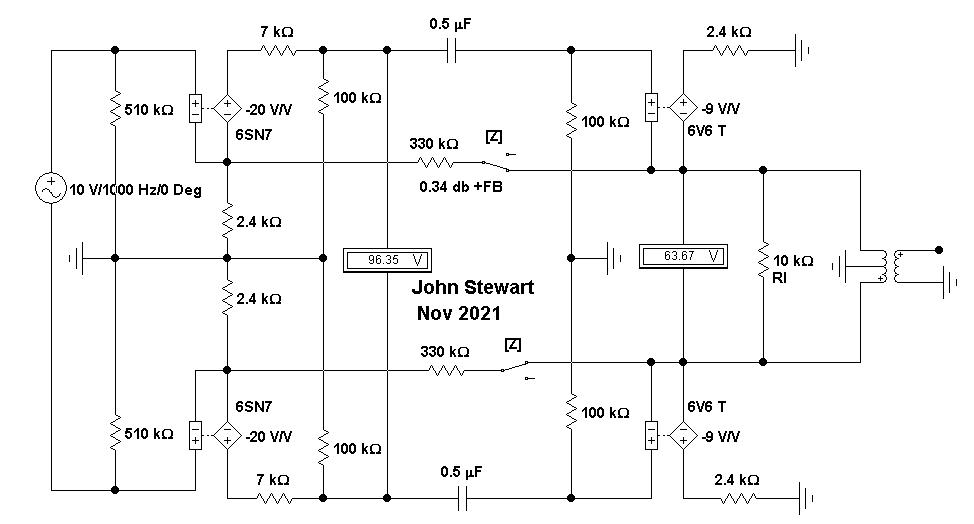

Trick Circuit, CF or Not?
When I see these trick circuits & often wonder if they are what the designer means. The essential part of the circuit needs to be examined, the rest set aside. If the overall FB causes oscillation, nine times out of ten reversing the leads to the OPT primary or secondary, but not both the problem is solved.
The front end on this one is generic, we find it used in many common circuits. So leave it out of the analysis.
In this design the essential part of the circuit is the output pair & their drivers. To further simplify the analysis most professionals would use a system they learned early on. This technique began a very long time in the past & was in common use when I was on the way thru the system. That is more than 60 yrs ago. We find it still common in SS design.
The simulation is performed using Electronic Workbench software. I think there are several sites where freeware can be downloaded. I run it on a MS XP OS. It may not run on a 64-bit machine. ………………..I’m not in the past, I also run WIN 7 & WIN 10 here!
The active devices are in this case triodes, we replace these with voltage controlled voltage sources. This will give a very good first order approximation of the performance to expect in the finished circuit. The device becomes a controlled voltage source of minus mu (inverting) of the tube in series with rp, the tube plate resistance.
In this example I’ve used common tubes, the 6SN7 & triode connected 6V6s. The numbers used are simply those published on the respective data sheets. The AC Voltmeters are set to 10Meg so that they indicate what we would see using a common VM such as a Fluke.
The switch ‘Z’ is operated from the laptop keyboard so that an immediate indication of the local FB can be calculated.
The system analyzes the AC conditions only. No power supplies or DC biasing to get in the way.
The first step identifies all the points at AC ground. The OPT CT is at AC ground thru an 80 micro F electrolytic. So we see the OPT CT is at ground in the simulation. The 6SN7 plate resistors are at AC ground thru a 40 micro F electrolytic.
Running the simulation with the switch ‘Z’ open shews the gain of the driver to be ~9.26.
Closing the switch ‘Z’ the gain becomes 9.63. The local FB is +ve.
The gain of the output stage is ~0.66. The circuit is truly a CF. The proper load resistance Rl is the same as if the OPT was in the plate circuit. In a real circuit the output limit would be about 4W using a pair of 6V6s in triode, same as it would be in the normal hookup. But the source impedance as seen by the load would be much lower. Limited by OPT winding resistance.
LF performance would be very good. HF response is still limited by the Leakage Inductance of the OPT in series with the load.
More than three significant digits add nothing to the final result. Altho one percent resistors are available at reasonable prices, capacitors are not. Vacuum tubes, semiconductors & inductive devices are anything but accurately known regards values to be used in simulations. The final proof is best known when the parts are assembled & run at intended levels.🙂

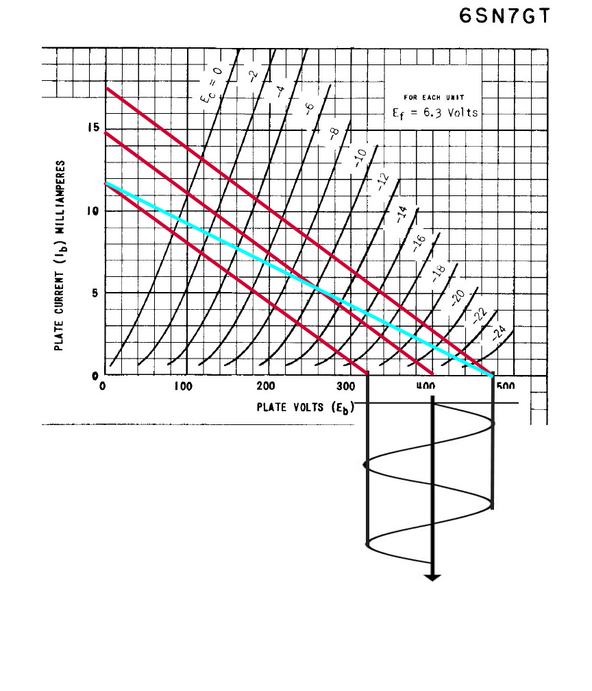

Bootstrap Loadline Explained
Driver Bootstrapping Explained with Graphical Help
Altho this topology does appear to be positive feedback & increases stage gain slightly it does not qualify as feedback in the usual sense. Feedback over a single stage needs to go back to a cathode or grid where some gain can be realized. Back to the plate there is no gain possible.
The driver tube used in this example is a 6SN7GT, a very common hookup. The load resister is 27K powered by 400 Volts B+. So the center red line is a 27K loadline terminated on the 400 volt point on the 6SN7GT plate family of curves.
The bootstrap connexion inserts some signal into the power supply B+ in the same phase as the main signal. That results in a higher impedance loadline & more gain occurs. But the increase in gain is small, the driver is usually a triode.
The other red lines are the same slope as the 27K loadline but they terminate at the limits set by the boot strap signal. A new loadline shewn in green is the result. This loadline looks like ~42K, (500 / 11.8)K. Calculating gain for the 27K loadline & assuming rp to be 7.7K & mu of 20 the gain is 15.56. With the 42K loadline the gain becomes 16.90.
The difference is 20 log (16.90/15.56) db or 0.72 db. Not much at all! I measured the difference of gain with & without bootstrapping on my version of Norman Crowhurst's Twin Coupled Amplifier. It was ~1,5 db.
The real benefit of bootstrapping is the longer loadline available to drive the following stage. Taking the extremes of the possible signal excursions from the control grid at zero volts at one end & -20 volts at the other looks like the 27K loadline would be OK at 280 volts peak to peak. For the bootstrapped 42K loadine the same measurement looks like 318 volts peak to peak.
In a practical circuit the boot strap signal would be much larger than in this example. But the 6SN7 curves don't go to a high enough voltage to shew that here.

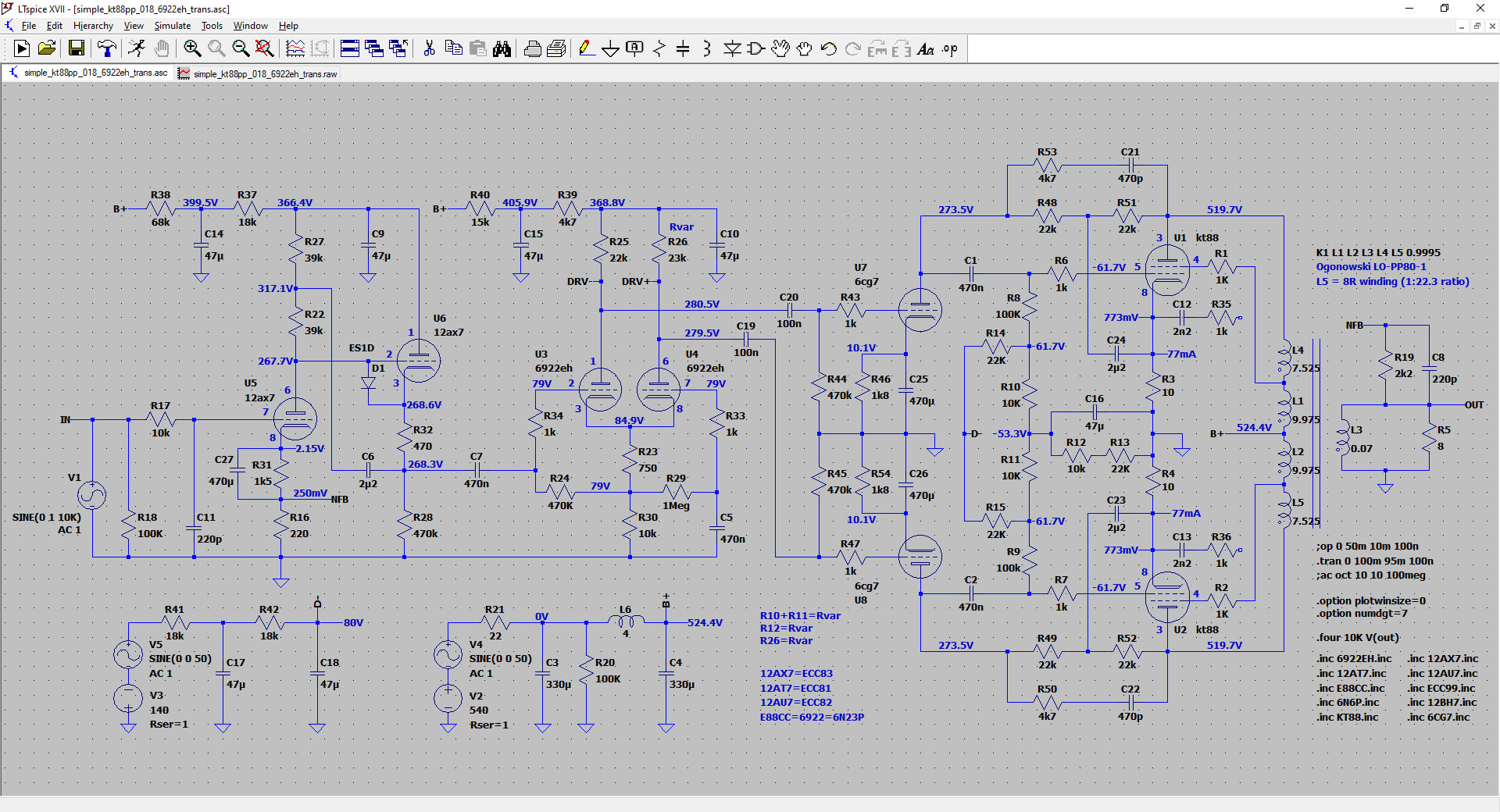

Alright, little update!
I took a different approach on trying to get the OPT in check as I already have a set of 4K Raa OPTs (Ogonowski LO-PP80-1, Polish iron, one of Europe's best) and am dead set on using those.
So I was tinkering in LTspice and it dawned on me that one way to get better control of the OPT is to put it in a local feedback loop with the KT88s. So why not simply fold the driver of the KT88 in with the OPT and the KT88. After this eureka moment I quickly realized that this must not be a new idea, and after some searching I found a similar approach used elsewhere (yes, that sinking feeling when you realize you're a dumbass after all, as someone beat you to it).

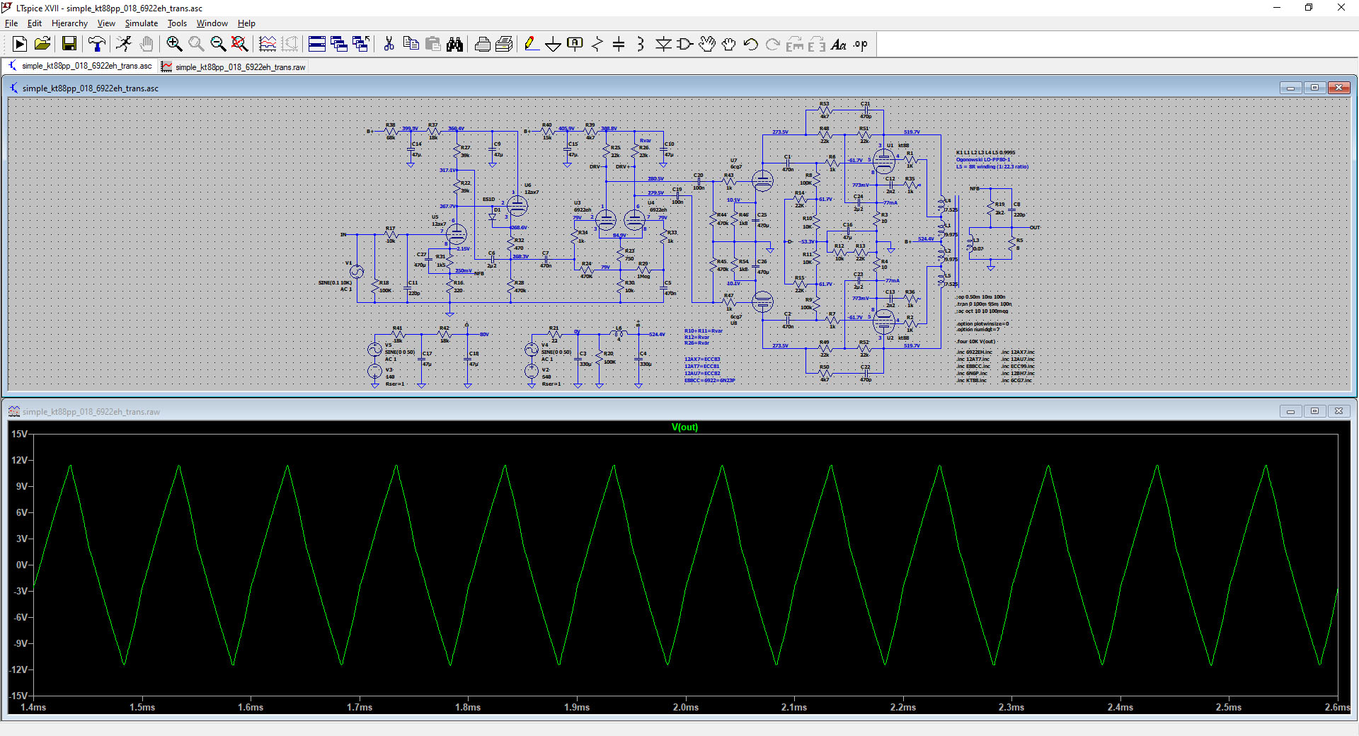

Where I'm struggling with at the moment however is to get good extension into the higher frequencies. Everything looks wonderful at 1kHz, but a 10kHz sine looks like a regular old sawtooth and I didn't even dare look at 20kHz. I've redone my compensation calcs on a fresh sheet of paper using a properly sharpened pencil and I can't seem to find anything amiss? Which usually means there's something at work here I don't (yet) understand?
Can any of you fine gentlemen (ladies?) take a peek at the attached schematic and point out what I'm missing, and possibly give me a hint on how to remedy this issue? Thanks!

That looks like a 'Plain Jane' P-P plate driven OPT. The cathodes lead off into space, but are loaded NTL by a total of 20R cathode current sampling resistors.
Am I missing something, I don't see a PP CF Amp here at all!😀
I abandoned the CF concept as it won't work with my OPTs, so this is the alternative I came up with. The drivers are in a feedback loop with the output tube and the OPT, which should help with further reducing the output impedance.
