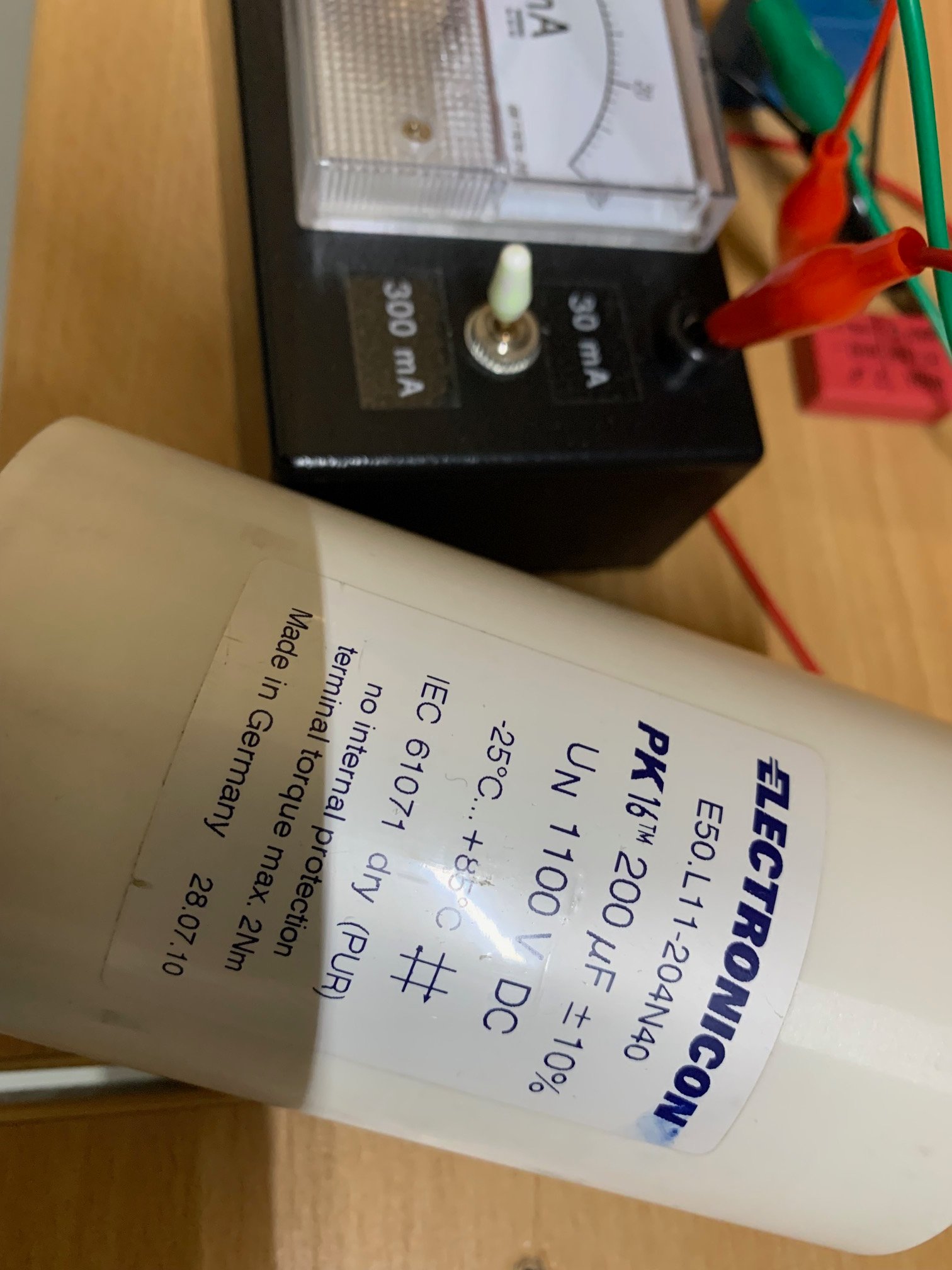

Hi Bench Baron,
1. I get what you mean. But I cannot believe all three (!) power supplies would be oscillating identical.
2. I already tried lowering the grid leak resistors to 50K, it's mentioned in my first post. It makes no difference.
3. The valve socket wiring is absolutely OK and identical to the other channel. All voltages and currents measure OK and identical to the "good" channel.
4. I use the Xantrex PSU so I can vary the B+ and stay on the safe side.
5. I just tried adding a 200 uF capacitor to the B+, but there is no difference. Actually the cap measures 190 uF.
Regards, Gerrit

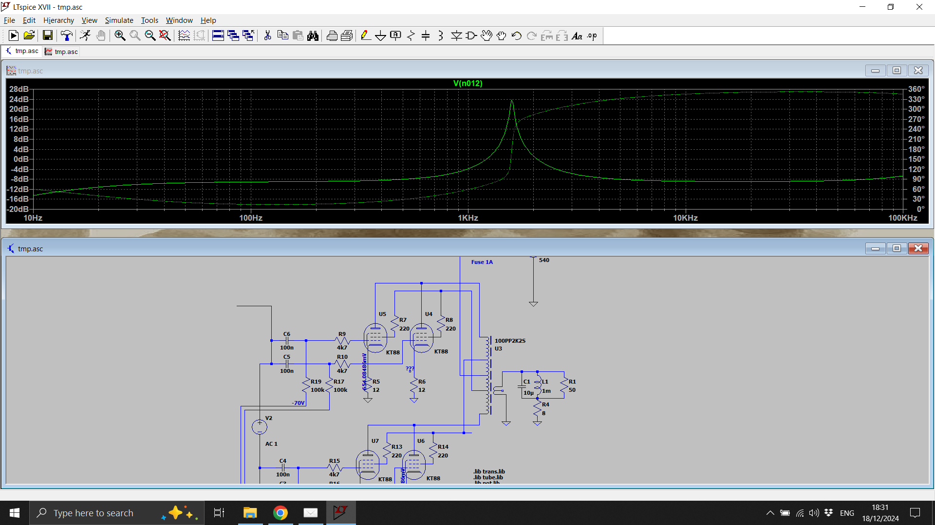

Toroidal OTs generally have excellent magnetic coupling and low leakage inductance.
But the problem is huge primary capacitance (typically in the nFs, so roughly 10 times larger than with E-I- core types) as well as large primary to secondary capacitance. Reason is the close proximity of the windings and the conductive core.
Together will the speaker inductance the OT capacitance reflected to the secondary forms a resonant circuit.
Well I have done dome simulation with a real speaker load. No I cannot see instability which is what you would expect. However if you swap the screens or plates over then I do get oscillation as you have described but only with a real speaker. Is it possible that your toroidy transformer has the colours wrong. Why don't you just try and see if that what it is.
