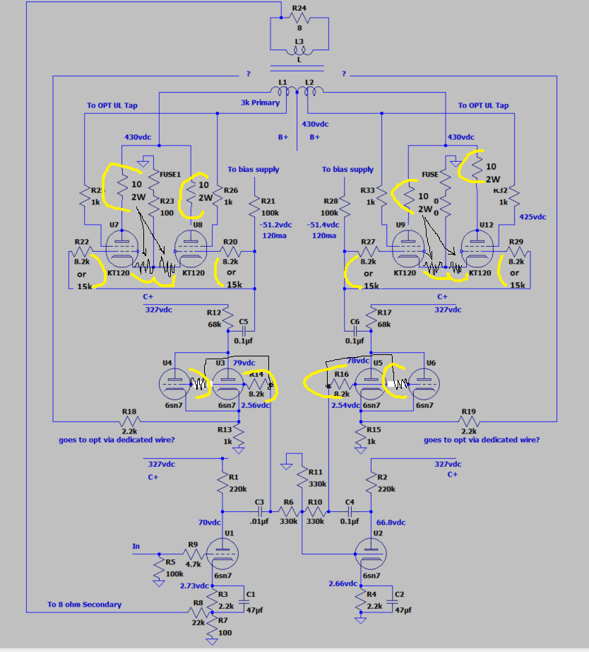

Hi, sorry for the delay, I only got to measure last night. Changes to the driver operating point increased the total available power output, but the clipping point remained the same no matter what was changed.

Given the above and previous information, would it be a correct assumption that the output transformer is the limiting factor in max clean power?
I forgot to measure the 4 ohm tap into an 8 ohm load which should have helped in the investigation. That should be something like a 1.2k primary which should put out more than the current max of 60w.

120W into 3K means that the output stage needs to deliver 600 V r.m.s (425 V-peak per side). Impossible to do with 430V supply. I have never used the KT120 but I think you need at least 620-650V anode voltage. I call it bad design.
IMHO, it is easier and cheaper to get 120W of good quality in UL mode just buying another power transformer, possibly some capacitors (or do series with bleeders for higher voltage) and make a proper power supply.
If want to stick to 430V supply and get some 80W+ then need to connect the the KT120 in tetrode mode, biasing each tube at 50-60mA.
If happy with 50-60W and still want to use 4xKT120 per channel then could try triode mode and no feedback. In triode mode if bias at 90-100mA per tube, it's basically class A amp. However, gain might be too much...Pick your poison!

The other bad part of the circuit is the driver. What's the point of running the 6SN7 at 80V anode voltage and less than 2 mA per tube?
From 430V supply, even a good regulated supply could be around 360-370V.
Then 68K for parallel tubes is exaggerated. 18-22K (i.e. 36-44K per tube) is more like it. With about 330V supply as shown, 22K common anode resistor and 680R+1.5K in place of 1K+2.2K at the cathodes, it should settle around 8.5 mA for the two triodes and 130V anode voltage. The bias would be -4V or just a bit higher and that might be just enough....

You can look at your PP on here.. Seems to indicate 2.5k transformer is about right. To get more watts more HT needed.

This exactly was my thinking before I posted #16. More output power with limited voltage means more current by lowering the load impedance, rather than by doubling the tubes count. Anyway, in #22 he said that halving the primary impedance would almost halve the output power, at least according to his measurements. Hence, there's a current limitation also, or his measurements were erroneous.120W into 3K means that the output stage needs to deliver 600 V r.m.s (425 V-peak per side). Impossible to do with 430V supply.

@Kay Pirinha Maybe 600V are too much and 510-520V are enough with 3K, looking at what the KT88 can do. But it surely needs more HT for 120W output power. If the plate load gets too low, distortion will increase significantly and available outpower will decrase a lot. Not suprising that with 1.5K plate-to-plate he gets less power. Tubes amps are constant power generators. One can maximize output power over a somewhat lower impedance than nominal (like max Pout into 5-6R and get less into 8R) but it would require some 2-2.5K into 5-6R. Not lower impedance.....

On another aspectMy current fixed bias p-pp amp using 4x 6550 Svet winged C with 450V B+, each tube set 70mA quies (125mA full load); I get exactly 115W o/p with 2K A-A prim imp with 40% screen taps. Re-doing the loadlines, it would appear the optimum A-A load for this tube in parallel paired operation is lower, approx 1.5KA-A with same screen tapes, but at 2KA-A, distortion is also lower as is available power.
With the same 2KA-A conditions I will get 130W o/p using EH KT90´s (lower internal impedances) but I know my transformers were based on using KT88´s. (460V B+ = 65W o/p)

120W with 2K plate-to-plate means 82% of voltage output required by 3K. So with 450V it is possible. I likely exaggerated with 600V supply but 510-520V are surely required for 3K load.On another aspect
However, I think that the output power is not the main concern as there is not much practical difference (i.e. listening mode) between 60W and 120W. If one has to settle for lower power it's more about unnecessary waste of electrical power. The driver stage looks really poor with the 6SN7 working at very low plate voltage and small current. As someone pointed out, it might have been designed for the 6SL7. For the SN7 a few resistors need to be changed.
Hi all, sorry been out with an accident. Thanks for all of the replies and suggestions. I think to summarize, the input stage is not good, the driver stage is not good, the output stage is not good, and the psu is insufficient. Pretty much what I thought. I think I'm contacting the builder. Thanks all again!
B+ too low for KT120 , no matter what modify you do can not increasing output power except. Change Tube rectifiers to Solid rectifier or increase AC voltage before GZ34. I design KT88 push/pull amplifiers at B+ 475~ 480V after heat up when working. KT120 need more higher B+ , It can be more than +500V.
OMO....At this stage I question the justification for using expensive KT120 tubes at a high B+ when in a specific circuit they cannot deliver performance ??? They look grande but KT90 "straight jackets" are my power limit. My design for power philosophy has always been resorting to parallel pairs and dropping to a safer B+ (saving double stacked elecrolytics) and using 6550C´s which are consistent tubes. For top performance, parallel pairs requires "slam" drivers but these issues are easily overcome. With 6550C at 450V B+ I set each tube quies for 70mA.

It's difficult to make that circuit stable. To do this, all the parallel connections of the small valves must be decoupled with suitable resistors. Even the kt120, with 10ohm on each single cathode and anode. And try increasing the grid resistor from 6k8 to 18k
