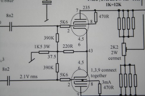

Enclosed is a modified driver circuit I regulary use,
typical of Williamson but seems never to have been followed up in other push-pull voltage driver designs. (RCA did it in a 50W juke box amp). The cathode/ g1 feedback on each side is a glaring obvious, and the common cathode greatly assists in stage balance and to top it, a pot is used in the anode loads to balance out thd. I find it a darned good stage and with 12BY7's as triodes, the b/w performance and output impedance (appro 1.5K) is exemplorary in parallel o/p stage p-p amps.
Strangely enough Morgan Jones doesn't even touch this.
The inclusion of a 10 Ohm resistor in each cathode leg of fixed bias o/p stage tubes is well known.
As with the above comments, I'm sure is a major contributer in the excellent sonic performance of my amps. This is tipping on a massive technical subject, but -> Has anyone done a computer simulation ?

Richj,
Your modified driver circuit in post #9 seems reminiscent in spirit to some other approaches I've seen, which I think are oriented toward reducing the odd harmonic signature of differential stages.
a) Using a "twin tail" on the cathodes: usually two degen. resistors from the cathodes to the tail resistor or CCS with additional high value resistors tacked onto the cathodes to ground.
b) In RC-30, page 696, I see two odd high value resistors R12,R14 from cathode to grid, beside the usual biasing resistors?
I think, (but untested) these schemes heuristically take advantage of the usual increase of the cathode tail voltage at the voltage swing extremes of the diffl. amp when the tube turning off is going too slowly. The positive feedback connections from the moving tail to the turning on tube (which has higher gm by then) helps speed it up or increases the tail current range above the CCS level so as to maintain linearity better.
From the simple triode fromula: gm = K Ip^.3333
Obviously, a constant current tail alone is not sufficient to maintain a constant gm1+gm2, necessary for linearity, when they are non-linear functions of current.
Beside this problem, there is also the Island effect (Inselbildung) from grid wire proximity to the cathode, which causes prolonged lower gm near cutoff (probably looking like a dropping K factor or .3333 exponent in the formula above)
This is an area that is sorely in need of some modeling in Spice or actual circuit testing with a spectrum analyzer. The diffl stage, probably the most commonly used circuit around, and not a bit of distortion compensation analysis in the literature that I am aware of. (probably is in some obscure paper out there somewhere, anyone with info? Well, I have seen the WE harmonic equalizer literature, but not anything on these other compensation approaches)

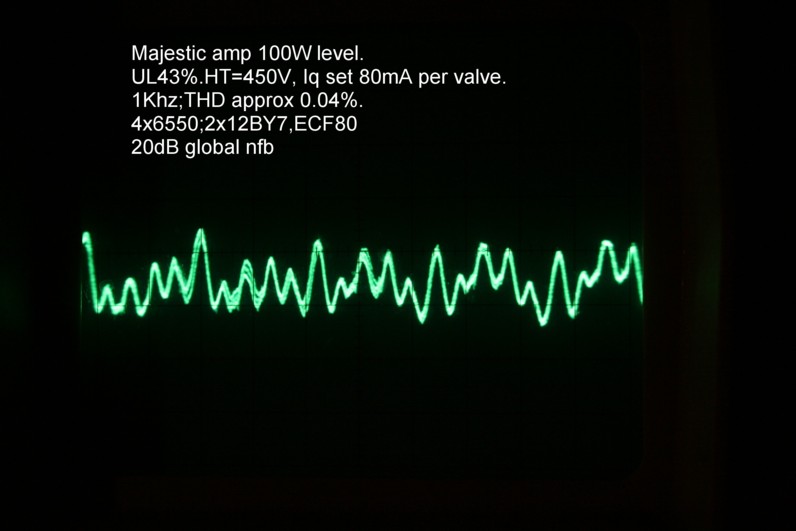

I've enclosed clip of thd at 100W, note regular harmonics with a touch of hum. This isn't a one-off performance and I get the same result using ECL82's pents strapped at triodes with different ressy values, but the gain is so measly low requiring the preceeding phasesplitter to shovel more volts. (+12dB) each side from concertina.
The only reference I've seen with localised cath to g1 feedback is in Radiotron 4th ed p.332 which describes in effect a bootstrap, i.e the input Z is raised. In the p-p voltage common cath driver circuit I use, the result effectively eases the AC loading on the concertina (HF balance is improved) then the driving stage grid resistors could be raised in value, but again I've detected sonic differences when lower value interstage caps are used. This may be a tempting approach but the end result causes increased thd at the HF end caused by circuit strays and interactions with rising impedances.
Hence the cue for best performance in p-p amps is to carefully provide a symmetrical layout from in to out.
