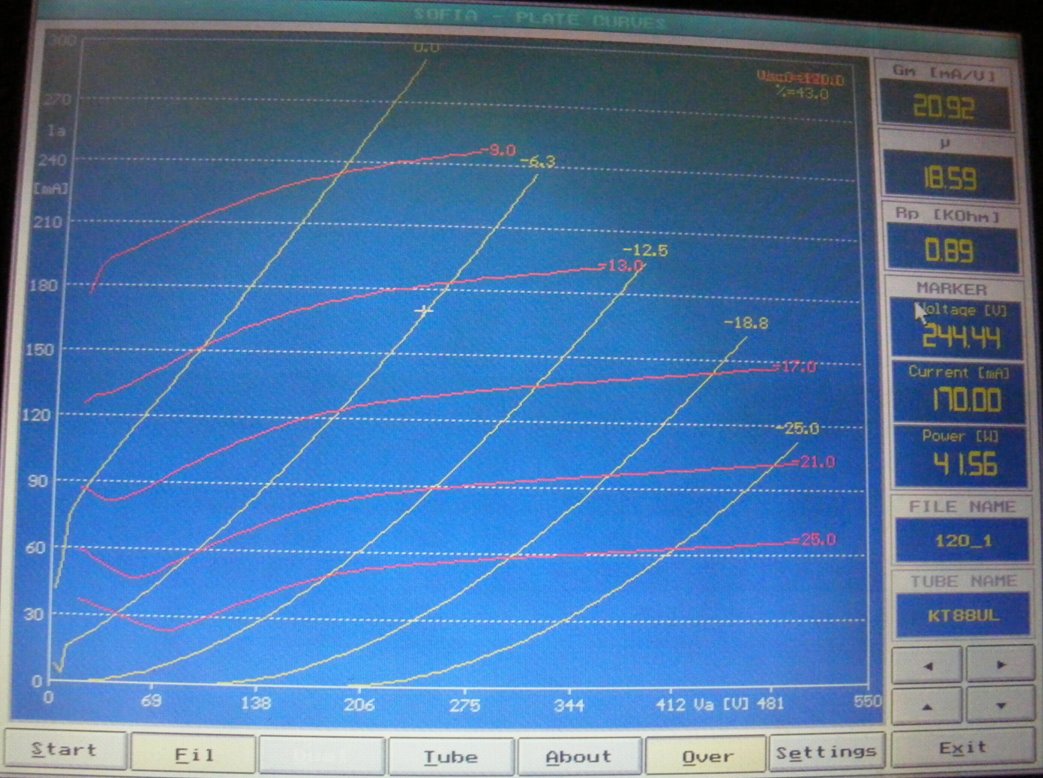

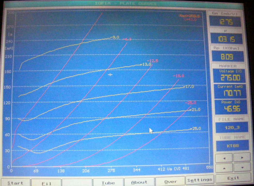

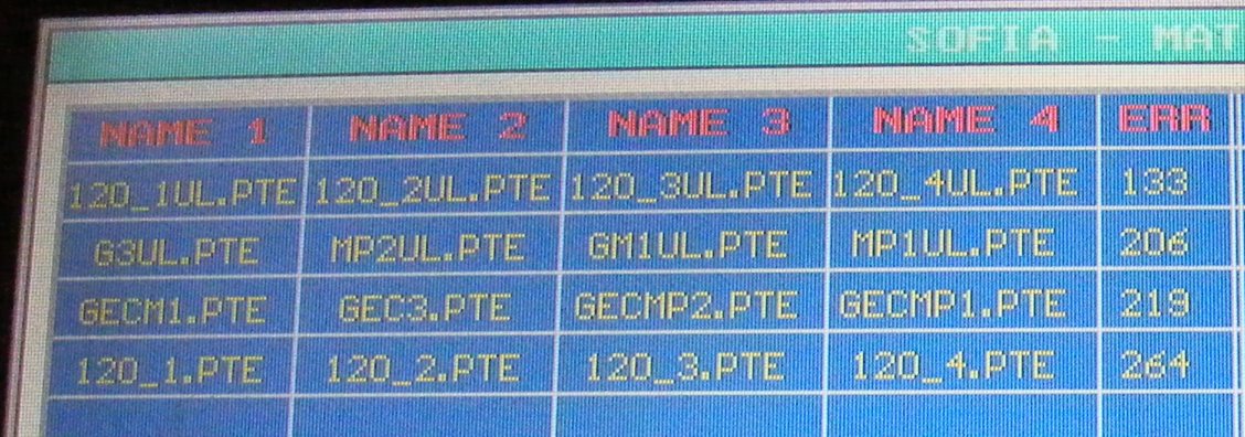

I always favor DC coupling to the output tube grid. Benefits include stability, overload recovery, frequency response, lower distortion, etc. Anyway I got my Quad and attached are the SOFIA curves. I was VERY impressed by the stability and ruggedness right out of the box.
One of the very first SOFIA imported to the US; the extremely rare DOS version allows EACH parameter to be edited; no crappy libraries like the Lose-Dos 3.1 version.

Mr. Dave,
Is there any chance that the software can export that data to a text file? It would be cool to read it into excel and manipulate there. I was planning on buying some KT120 as well.
Mostly the problem has to do with the legacy media and interfaces. That will daunt the effort, since likely several hours would be required to pull it off. Then one would have to format the data to CSV or TSV formatted ASCII; likely more time, but I could push that little task off to you; one of those keystroke macro programs would assist.
(BTW you sound like a youngster; I was LMFAO re 'export data' On DOS you have to do all that MANUALLY.)
I wasn't referring to DOS exporting the data, was more wondering if the Sofia software was capable of saving in and excel-friendly format.
I would be more than happy to re-format the data if you can capture it raw in some format. I am a digital electronics engineer/programmer so I am capable. In fact, I would just write a program to do it and share if you are interested.
After this next amp gets finished I was going to build a curve tracer of my own which would have no display. I would load test parameters on to an SD card, pop it and a tube into the tracer, then the tracer would make a .csv for viewing on the PC later. I would just like to be able to calculate the effects of feedback on the curves in excel.

The SOFIA is Italian; I would have to see if the '.pte' files are in ASCII format. Since they are merely ADC readings it is likely that they are. However to transfer the files from the DOS lap top that is running the SOFIA requires floppy media and the purchase of a USB floppy drive to transfer to a modern computer.
