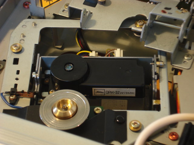

What about the Toshiba laser heads, especially 2nd. generation OPH-32 ?
All the best,
Salar
the Toshiba OPH-32 is in use in very few models, e.g.
KENWOOD DP-700
KENWOOD DP-1100
LUXMAN D-102
NAD 5255
ONKYO DX-100
it was the successor of the OPH-31, as I know only in use in
ALPINE AD-7100 CX890 Toshiba OPH-31
AUREX XR-Z90 CX890 Toshiba OPH-31
KENWOOD L-03DP CX890 Toshiba OPH-31
LUXMAN DX-104 CX890 Toshiba OPH-31
Two guys I know uses the L-03DP and DP-1100 without trouble - nevertheless I must say, I haven't experience about lifetime and realibility about this laser heads respective the used diodes.
In the attachement a photo of OPH-32 - for me rather first than second generation. TOPH-7833 (Toshiba made but based on Sony technology) was second generation (similare to KSS120-123A-C)
Source for the photo:
VNAV • View topic - THAY THẾ MẮT Ä�ỌC CHO CDP Ở Ä�ÂY
Toshiba XR-Z70 - rozkrêci³em laser i nie dzia³a.
