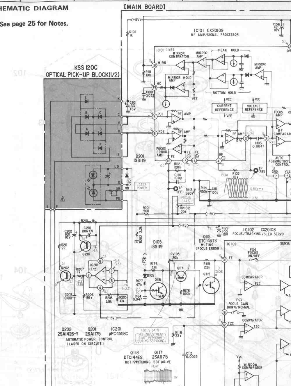

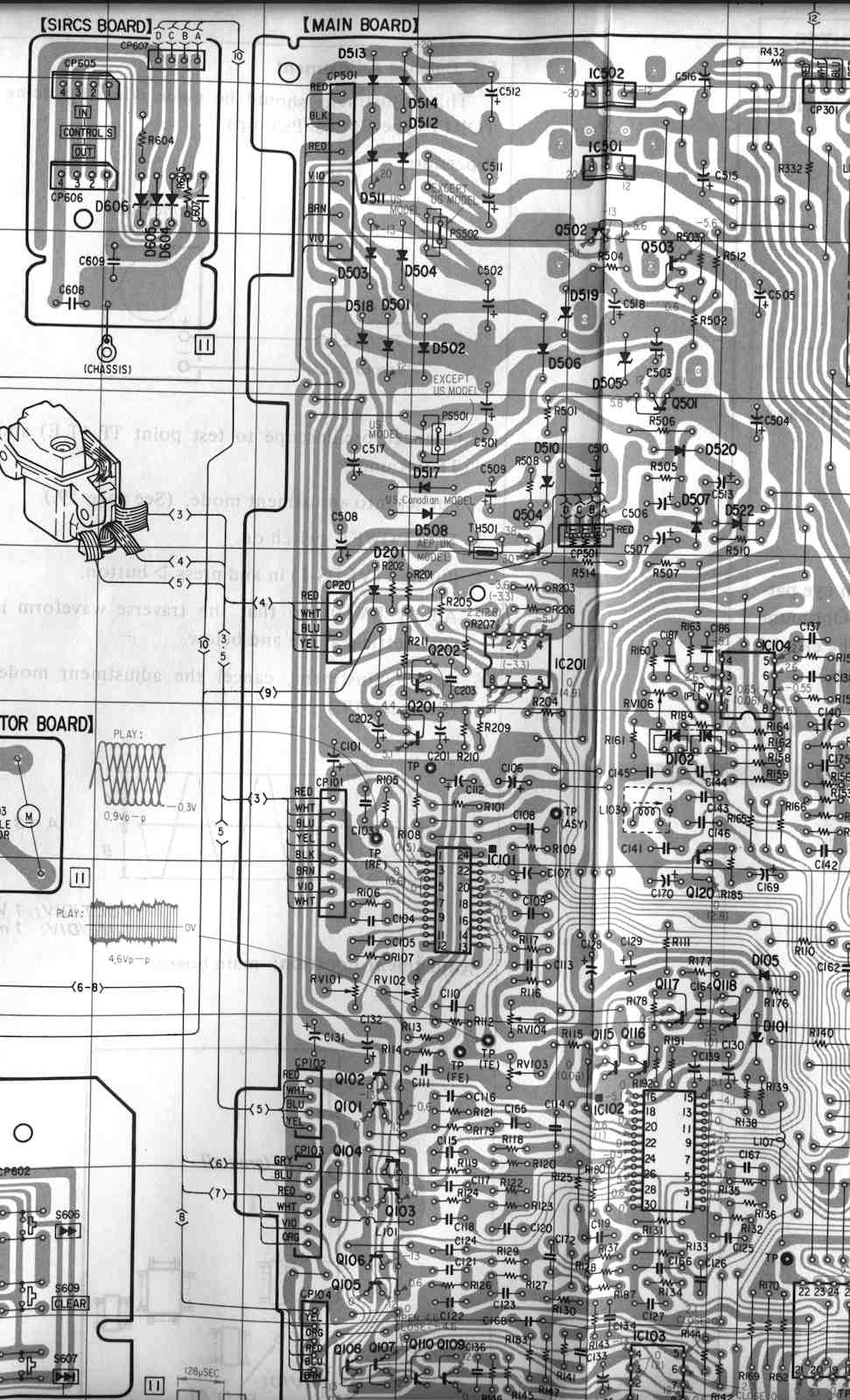

Here is the Circuit board of the CDP-40 please look at connector CP201
blue = LD Ground
yellow = LD Supply voltage
White = MD suppy voltage?
Red = MD ????
Any help to a newbie like me to mod the apc for the KSS-123A is very much welcomed...

Connector CP201:
blue = LD+PD Kathode - to GND (only one leg at the laser diode)
yellow = LD Anode - to C, Q202 ( regulated power output of APC);
E, Q202 about R211/210 from supply voltage - check line from R210)
White = MD - to 3, IC 201, non inverted input of comparator OP-Amp (APC regulated input)
Red = MD = connector of var. resistor - about voltage divider R202/201 to -Vee (in your case -5V)
Q202/201 and IC201 forms the APC circuit.
From different datasheets I have make a little overview of the individual APC circuits - perhaps this helps a little.

Connector CP201:
blue = LASERDIODE+PHOTODIODES A-D Kathode - to GND (only one leg at the laser diode- THEY ARE CONNECTED INTERNALLY ANYWAY)
yellow = LASERDIODE Anode - to COLLECTOR, Q202 ( regulated power output of APC);
EMITTER, Q202 about R211/210 from supply voltage - check line from R210)
White = MONITORDIODE - to PIN 3, IC 201, non inverted input of comparator OP-Amp (APC regulated input)
Red = MONITORDIODE = connector of var. resistor - about voltage divider R202/201 to -Vee (in your case -5V)
Correct?

Answer to post #25: I would say yes (E=Emitter, LD-Laser Diode, MD = Monitor/Photodiode).

- Digital Source
- KSS-122A and KSS-123A - Are they Interchabgeable?
