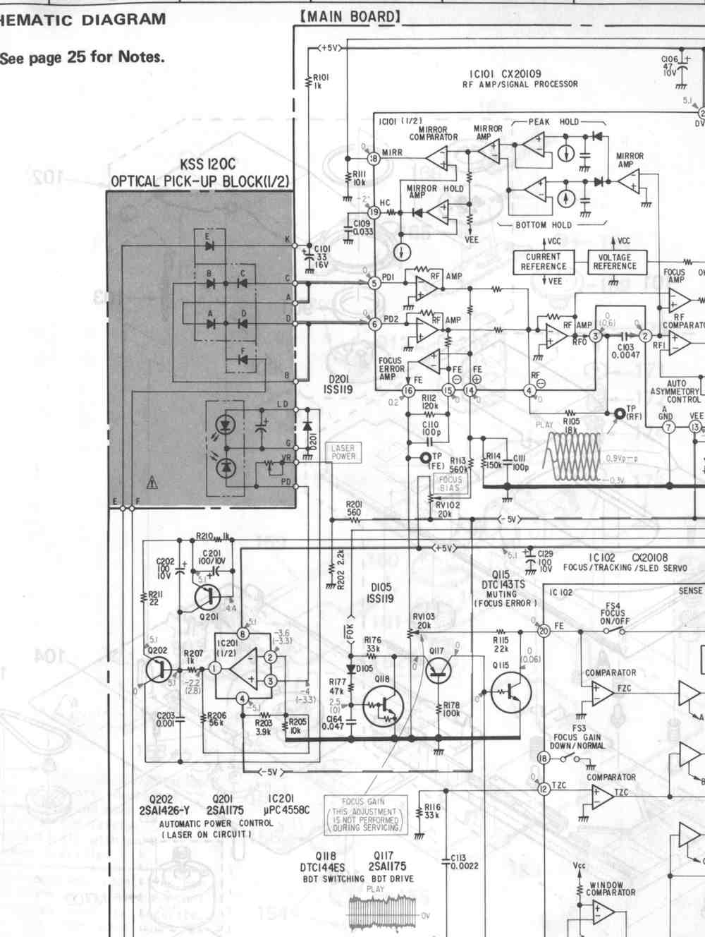

Ok to make things more complicated:
My CDP-40 has a KSS-122A, looks alike a twin to the KSS-123.
But the Service Manual says it is be a KSS-120C.

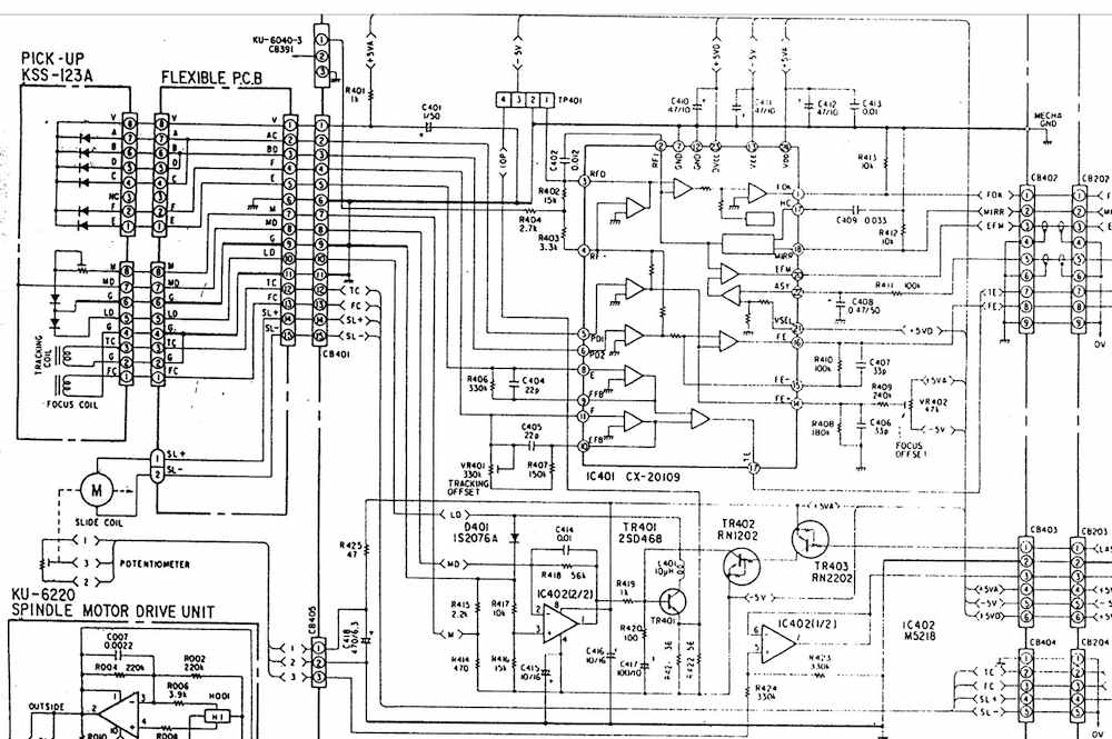

I attached the schematics of CDP-40 and Nak. looks like the the diodes have reverse polarity, or am I wrong? Hope I am right, or else I might have zapped a laser, which is worth 180$ nowadays.

It does appear to be different (and correct in the diagram) as the NAK drives the LD from Ground (anode +) to minus 5 volts (cathode -)

No... it's different, the two cathodes are common in the Sony, Anode to Cathode in the NAK.
I take it the LD is a three terminal device as normal. The photo sensor is on the same die as the LD.
Hello Mooly,
yes, it is a three pin device, the layout on the flxible pcb surrounding the KSS-120C / KSS-122A is the same as the KSS-123A. I guess, I will not have zapped the KSS-123A with reversed polarity?

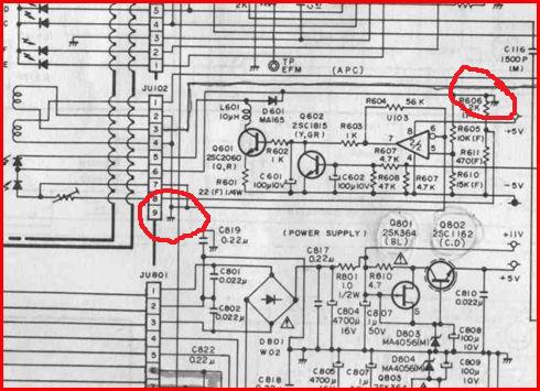

Just had another quick look and the circuit appears incorrect for the NAK
The LD photsensor is shown connected across two grounds... so all bets are off 🙂
As I know, this two grounds are used to avoid effects through wiring and cable resistances (like audio amplifiers). the upper GND (connector 6) is for LD/PD and the lower GND (connector 2/4) for the accutator coils. All leads goes in most cases to the central earth from mainboard.

Use of digital and analogue grounds is common practice, but the terminology on the NAK circuit as posted is clear. Without having the unit to examine I wouldn't like to speculate further.
The photo diode is definitely shown as connected across the same ground.
The LD anode is grounded and the cathode driven to the negative rail... that appears OK. So that means the Anode is "ground" and that connection also goes to the photo diode cathode. The photo diode anode also goes to ground... the same ground as used for the coils, and the same ground on the circuit as the LD anode.
What needs confirming then is whether the two points I outlined in red are physically connected.
You are right. I have overlooked one misprint: the unwanted connection between anode of PD and the accutator coils. Unfortunately such printer errors are often to observe in schematics. And where one mistake was discovered, additional printed mistakes are to expect.Use of digital and analogue grounds is common practice, but the terminology on the NAK circuit as posted is clear. Without having the unit to examine I wouldn't like to speculate further.
R604 (56K), PIN6, U103, anode of PD and the variable resistor without number perhaps must connected to the same potential. This potential could be -5V but not GND.

It seems odd also in that the LD and Photo diode are connected internally as shown.
And another thought,
Most players use a single 5 volt supply for the Laser... and photodiodes need to be reverse biased to work... which you can't do with the pickup as shown on a single rail, and I am thinking it would not be economic to have a device that was so limite in application. Another misprint... the LD should be as the Sony ?
Edit... that last comment doesn't read how I intended... I mean to use in a configuration as in 99% of players... like the Sony.
There we go,
schematics of a KSS-123A in a Denon DCD-1700 / DCD-3300
If i posted the board layout of the Sony´s APC, could anyone help me in rearranging it for the KSS-123A?
Again, the CDP-40 tracks very well with the KSS-122A (120C), so I would like to give it a try with the KSS-123A
But first for comparison the KSS-123A in the Denon DCD-1700, diodes are arranged the same.
But even though the Denon uses top notch mechanics (Linear Motor, brushless spindle motor) tracking was mediocre compared to the cheap CDP-40.
All the best,
Salar
