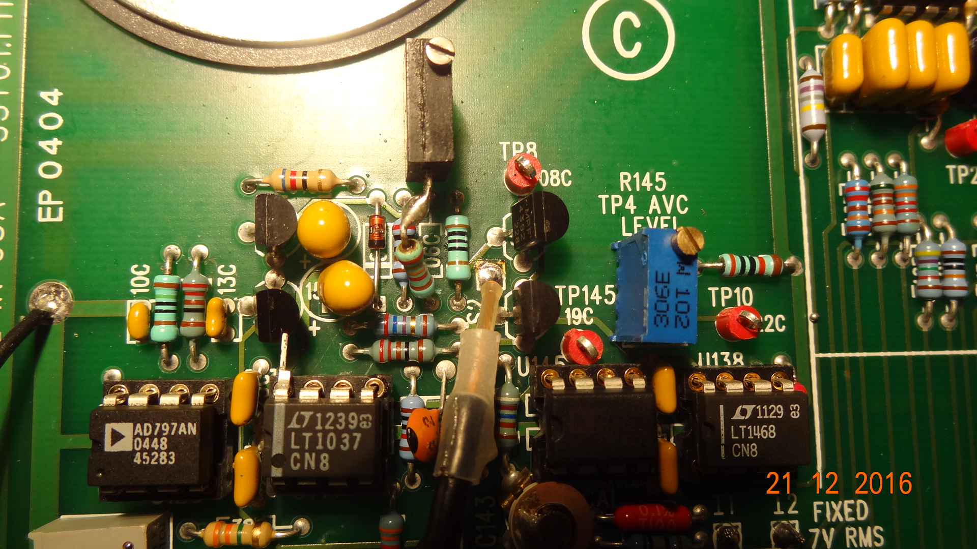

The R, I believe, is between gate and drain is fixed. i added trimmer to it. Replaced other adjustable pots with multi-turn for fine tuning.

I didnt check against schematic.... dont know where I put the schematic.... may be thinking of 4400. But you can see where the variable r has been added in the 4402B. Looks like it is a 100K pot.
The IC that cannot be read is an AD633AN.
Hope this helps.
THx-RNMarsh

The data shown was directly from the osc output BNC on the front panel (<-125dB/1KHz)
However, for the Main ouput BNC ....
If you go thru the switched level and variable pot and another opamp distortion remained very low at 1KHz (THD = -120dB).
Using LT1468 in main output amps; 1v/100K --
10KHz (80KHz BW) THD+N = -100dB
10KHz THD = -116dB
For those using sound-card like analyzer products... this may be about as good as most of them.
THx-RNMarsh
Attached.
