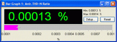

Here's a screenshot after letting the KH4402 (dual 4400) settle for a few minutes -- obviously the 400Hz HPF and 22kHz LPF were used. You might find it worthwhile to not perform any surgery on the unit:

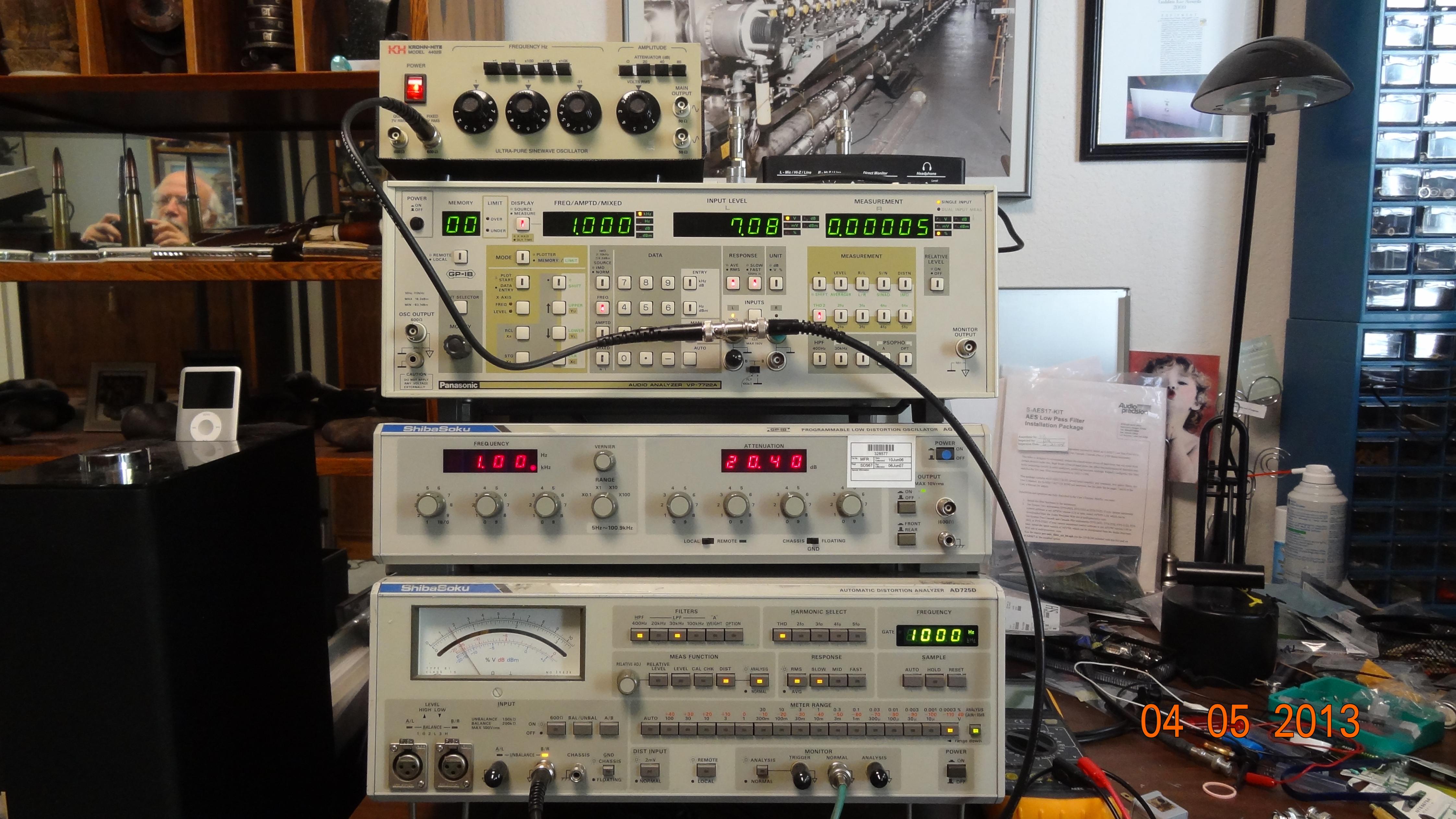

I went through my KH4400 this morning and did some updates and calibration. I have a marked up schematic but its too big to post so PM me for a copy.
The mods are pretty simple. Tuning and calibrating is easy with the right instruments. probably impossible without. You will need an accurate AC voltmeter good for 100KHz, a frequency counter, and a distortion analyzer with harmonic resolution below -120 dB (Shibasoku 725 or ??)
The distortion null only affects the 2nd harmonic. 3rd is untouched by the tuning.
I looked at increasing the output drive. Its only good for 50 Ohms on the -20 dB step. It doesn't have enough drive for 50 Ohm load at full output. I don't think the supplies are big enough to support that (an extra 200 mA * 30V or 6W).
